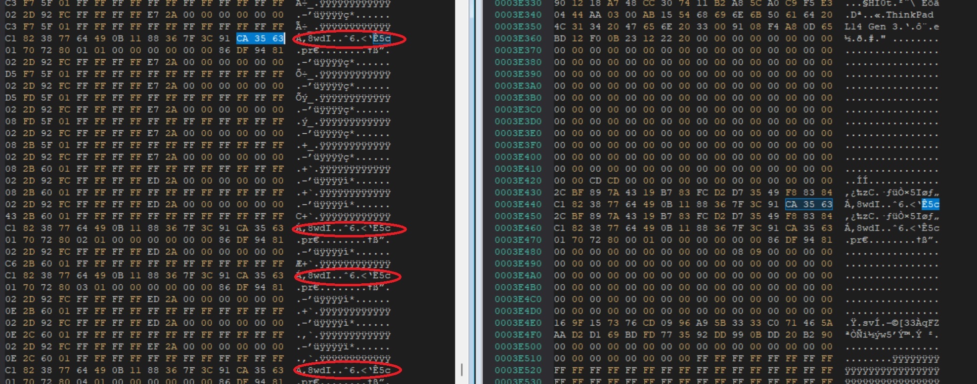

          Finally I read EC NPCX977 please help me

                why do I have 2 different files?
                have you reread the original?
                parts are missing since write problem .
                try mod
                you forgot something​

                  The original file was uploaded and the second one was uploaded after the problem occurred.
                  • Maxpower3
                    Bad Veteran
                    • Feb 2018
                    • 1224
                    • France
                    unlock ioriginal, t"s same of l14 gen 3 unock
                    retry .
                    if not work .put back the original and look if error comes?
                    there are lots of pieces everywhere. why L14/15 are always boring​

                      After restoring the original file it works
                      It's confusing
                      • volcour
                        • Dec 2015
                        • 87
                        • algiria
                        The problem solved after extracting EC from EXE file​

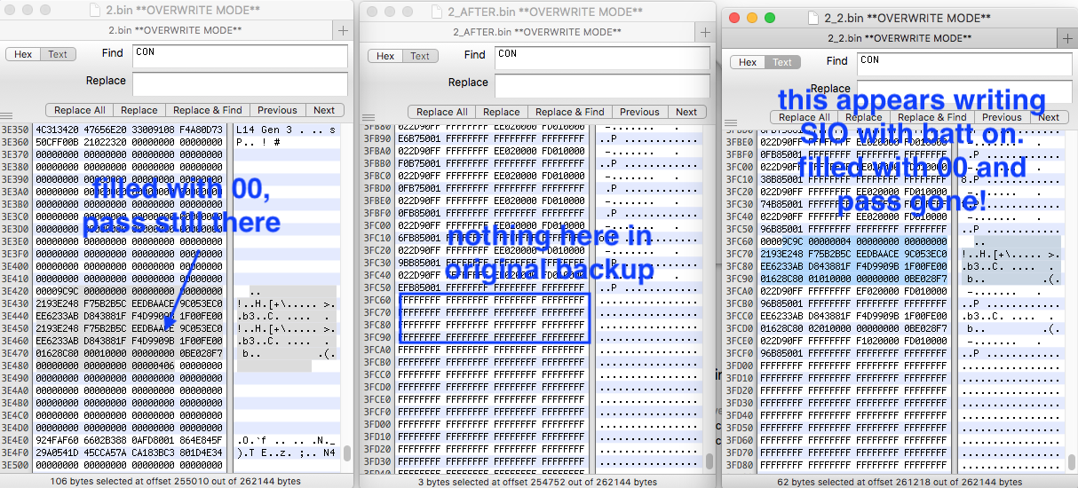

                          I will tell you my "adventure" with L14 gen 3 intel: I had 3 pcs, 1st I read SIO without main battery and CMOS batt and all went well, no errors, SVP removed.
Name:	Screen Shot 2025-03-13 at 20.05.23.png

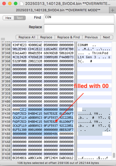

                          At 2nd, being lazy I just removed keyboard to connect SVOD4 (without removing battery and CMOS batt), read SIO, filled same area with 00 and surprise! password still there! I did read again SIO and compared with original backup and noticed that something similar with strings I filled with 00 is starting with adress 3FC62 but it wasn't in original backup. After I filled that section with 00 password was gone! Bottom line, must read SIO without battery and CMOS batt.
Name:	Screen Shot 2025-03-13 at 20.18.09.png

                            Thank you so much for sharing this information
