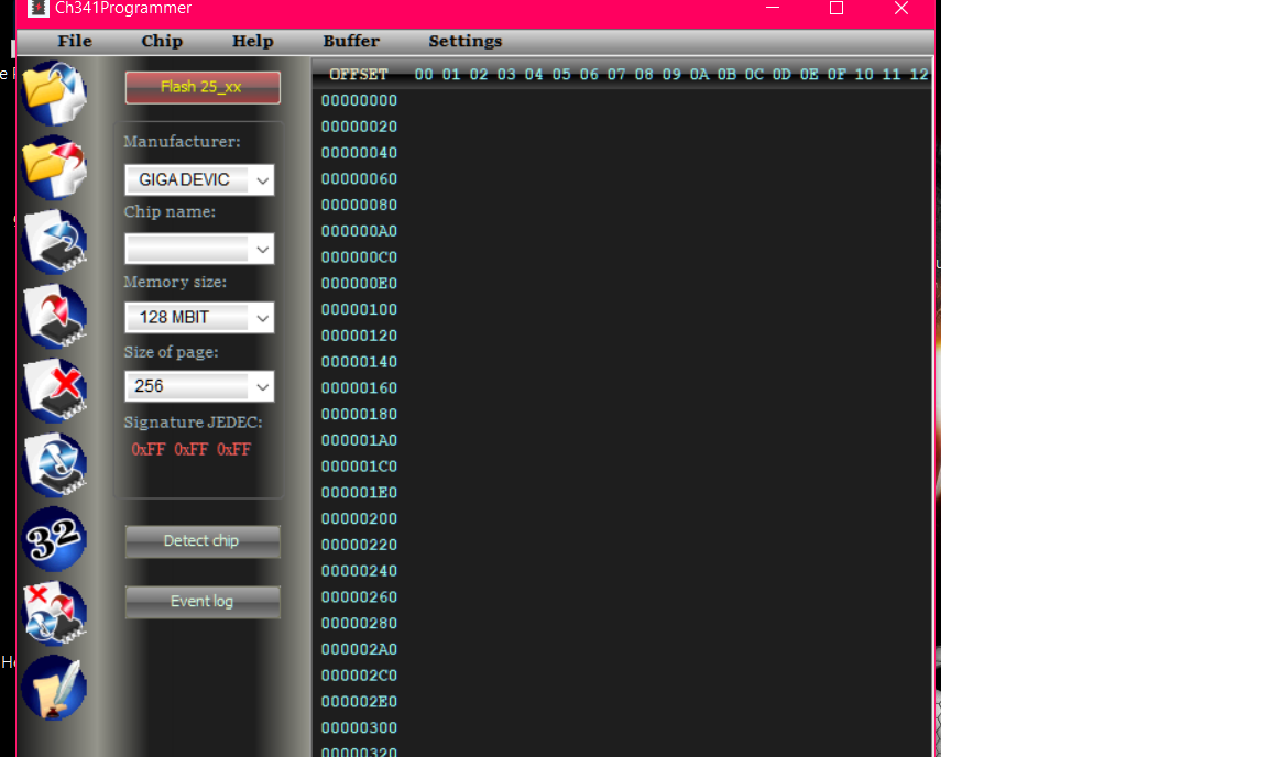

      ch341 programmer plus adapter, this is 1.8v 25q16jwniq 2349
      yes, guaranteed to be blank​

        The 25q16jwniq is 2MB​ ,it`s not the bios chip, its for firmware. Is this what you want or are you wanting to backup the bios ? .Use NeoProgrammer software

          That chip is 16mg., it is where the BIOS firmware is located.​
          I have many programs for that programmer, the one you mention too, I use the one in the photo and it has never given me a single error, it works great

                16 Mega bits , not 16 Mega Bytes. 16Mb (Mega bits) = 2MB (Mega Bytes)

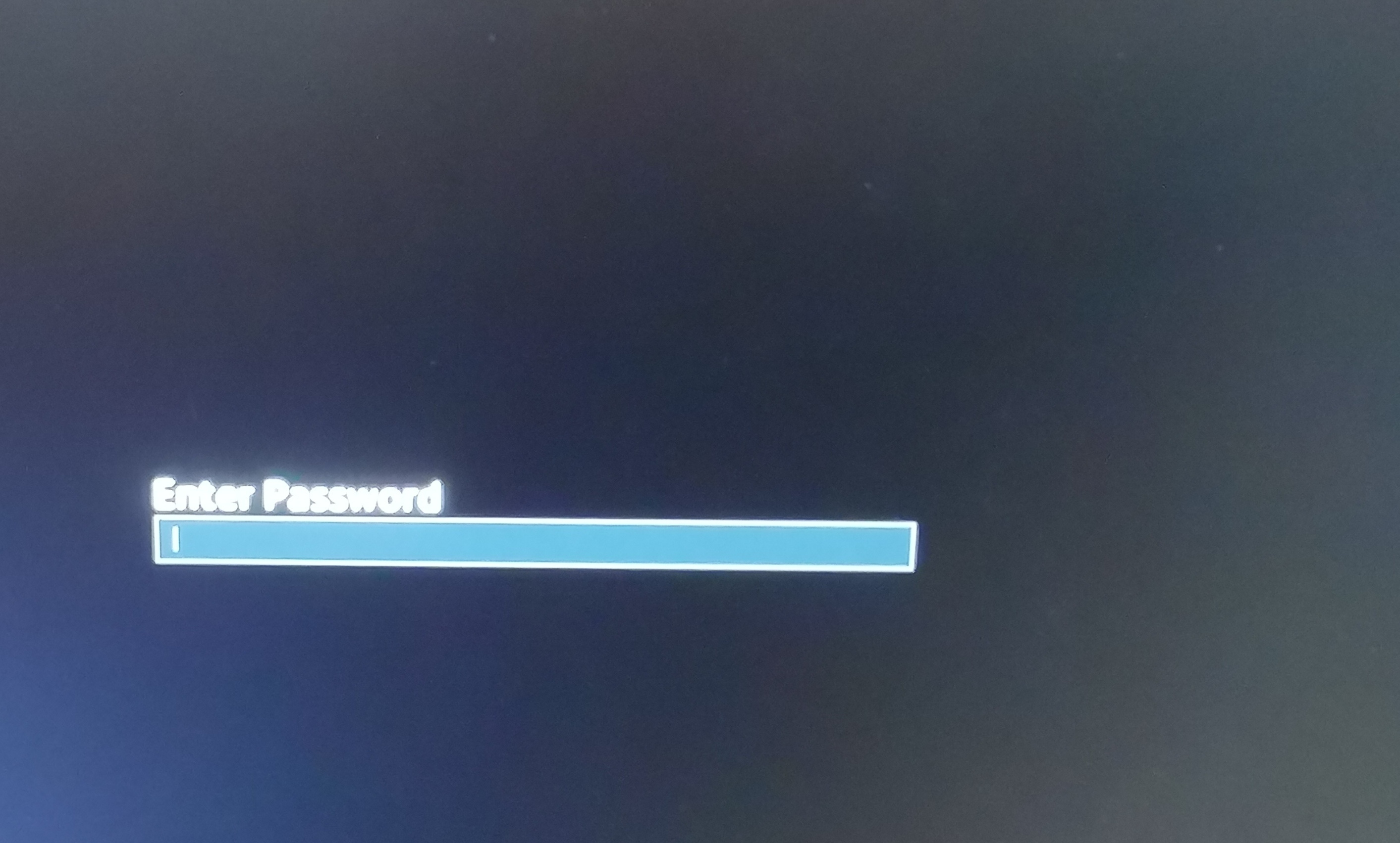

                    Good morning,
                    I got one, the computer already boots up but it asks me to enter a password.
                    If I upload a dump, can someone modify it so that it doesn't ask for a password?​

                      Originally posted by aitor
                      Good morning,
                      post the S/N, post the original content of the bios chip,the full name and model of the laptop,​the motherboard model, etc.
