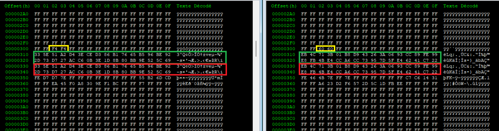

    Already read MEC chip erazed and folowed all steps but no succed still password !!!
    post dump
    Mec1663 Dmi start from 0x00
    Pwd 0x300 - 0x34F replace with FF
    search for this shape
    Click image for larger version  Name:	ec pwd.png Views:	0 Size:	310.0 KB ID:	3237274

      post dump
      this is the dump, but the steps is to read and erase the MEC wait same times and re write the dump.

        post dump
        and 2kb eeprom replaced 0x300 - 0x34F with FF, but the laptop start and give (Bad SVP DATA AND SHUTDOWN)

          try with clean bios if bad data
          just need replace eeprom file
          I guess the serial number is PC1FM5HH​
            thanks you bro its working
