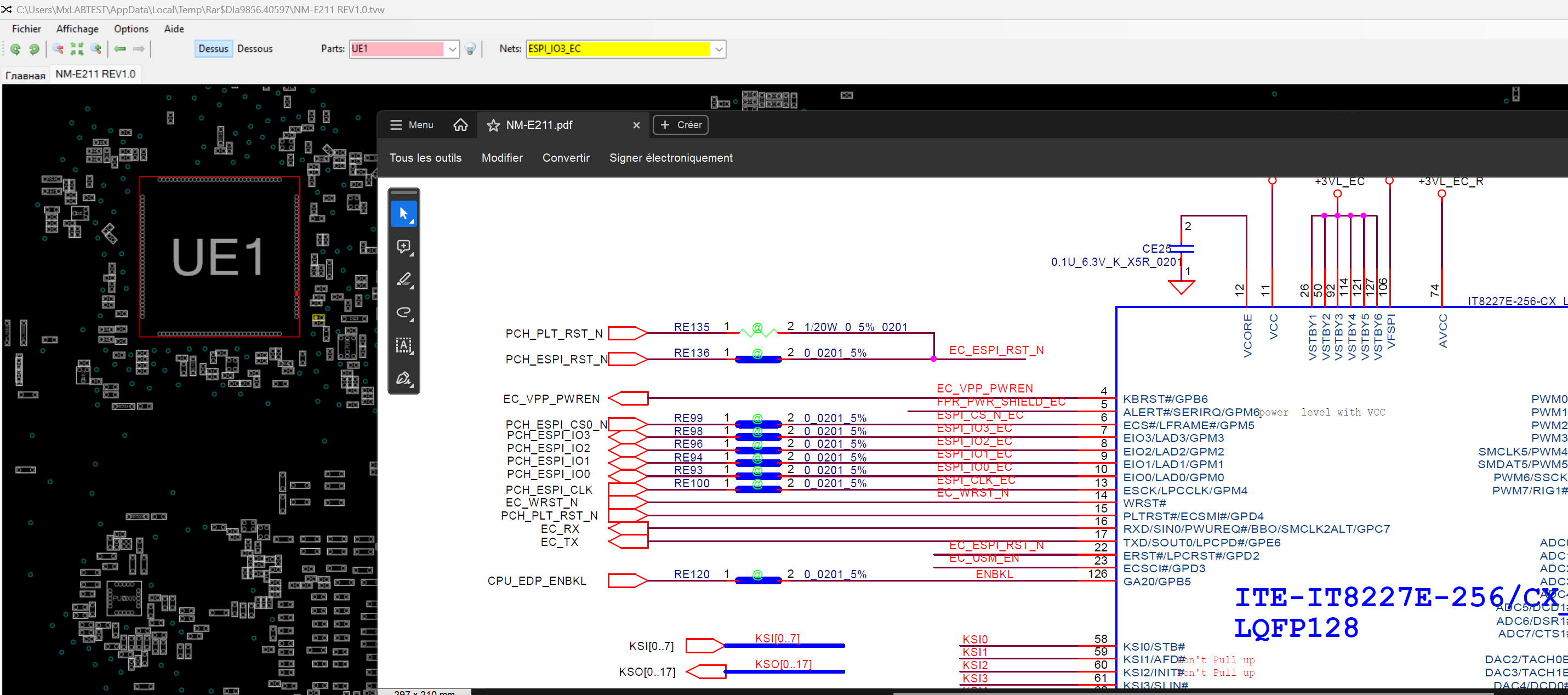

      for intel E14 gen4 nm-E211
      it's too IT8227-256
      try bypass maybe
      https://www.badcaps.net/forum/troubl...3340184​

        Thank For reply
        But is the it8227e chip programmable???

          Yes, IT8227E-256 is programable 256kb
            look please clean
            • Maxpower3
              Bad Veteran
              • Feb 2018
              • 1231
              • France
              try
              • waleedoo
                • Nov 2016
                • 71
                try
                Thanks bro its work
