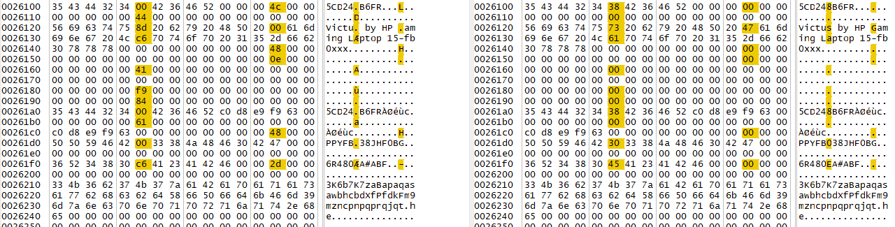

    So I got myself a programmer and I made a copy of my current BIOS. I made 3 copy to make sure it's the same.
    I will go check the guide/methods to see what's the next step, but if someone is willing to help, would be appreciated.

      Since laptop still boots, make a backup of your BitLocker recovery key (48 digits), run the following in a command prompt as administrator
      Code:
      manage-bde -protectors -get c:
      Suspend Bitlocker temporarily (CMD as admin)
      Code:
      manage-bde -protectors -disable c:
      As flashing BIOS will reset the TPM
      Next step, flash this BIOS, i fixed your DMI data, it was damaged in few places, some random bytes in the model name/SKU/serial number and in empty spaces
Name:	victus 15-fb NMPJ.png
      Victus Gaming Laptop 15-fb0160nf (6R480EA)
      BID 08A3C
      BiOS ver. F.24
      S/N 5CD248B6FR
      DMI+Win key 26000-2803F
      Use 1.8V adapter if your programmer doesn't support 1.8V chips natively
      MPM is unlocked in case DMI data doesn't show properly, you can fix with BCU

        Great, thank you so much for your help m1ch43lzm
