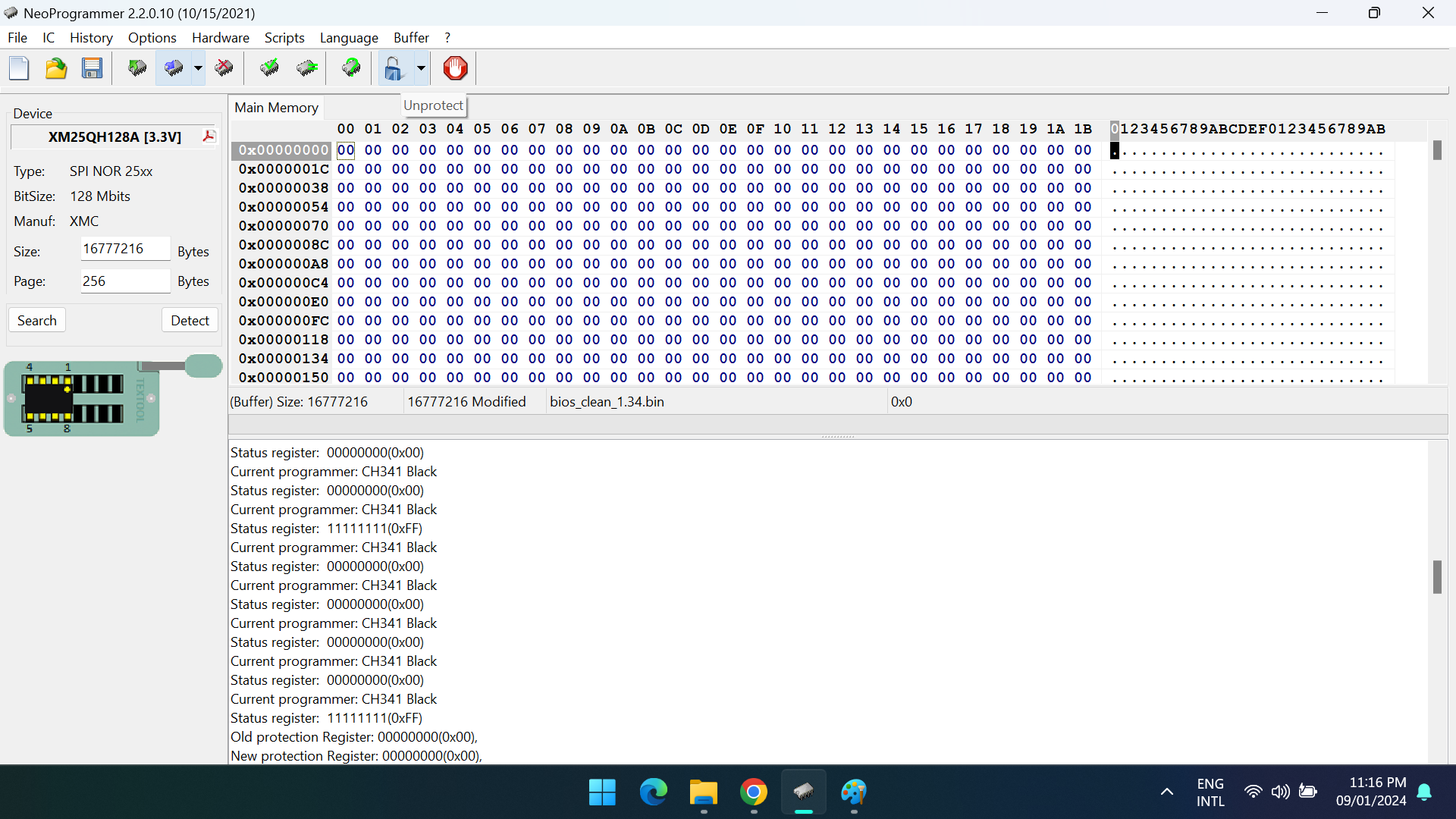

Unable to verify IC or write/erase/flash BIOS file to XMC QH128AHIG SPI chip using NeoProgrammer/AsProgrammer
  • testaccgta
    • Jul 2024
    • 12
    • Brazil
    Unable to verify IC or write/erase/flash BIOS file to XMC QH128AHIG SPI chip using NeoProgrammer/AsProgrammer
    Hi, everyone!
    I've recently acquired two brand new SPI chips to replace the one currently in my Acer A514-54G laptop MB (FH5AT LA-K092P). The reason why I'm replacing the current SPI chip is because I had some difficulties with a third-party IT assistant who pretty much lacked the soldering skills and ended up destroying the current SPI chip soldered to my MB from factory.
    I've decided to do this on my own because I spent the past month or so learning some soldering skills and BIOS modding through Badcaps and WinRaid forums, hence the attempt. I've also chosen to buy the same SPI chip that was installed from factory (XMC QH128AHIG) to perform this.
    I am currently using a CH341A Black programmer with an SOIC8 200-208mil socket adapter to be able to flash a virgin BIOS file from Acer's website, but I've been facing some issues with the erase/write/verify IC functions. I've tested reading the IC through NeoProgrammer v2.2.0.10 and AsProgrammer v2.0.4 and this works fine-ish, I guess.
    Here below is what I've been getting from the software flashing tools:
    • Reading: success, but the 3 reading attempts resulted in 3 different dumps, none of each matching each other (dump1.bin, dump2.bin and dump3.bin files attached)
Name:	image.png
Views:	1399
Size:	109.1 KB
ID:	3341797
    • Verifying IC: error at each attempt (perhaps because it is reading different dumps?)
Name:	image.png
Views:	646
Size:	221.2 KB
ID:	3341798
    • Erasing IC: it seems to proceed with the erasure, but when I read the IC again, it is not blank
Name:	image.png
Views:	656
Size:	221.8 KB
ID:	3341799
    • Writing IC: leaving all options enabled, it performs the erasing very quickly and the verification process fails right off the bat
Name:	image.png
Views:	640
Size:	109.5 KB
ID:	3341801
    I have stumbled across a topic regarding this same XMC QH128AHIG chip here on Badcaps, which even mentioned some alternative chips in case there was no detection through the programmer software:
    Re: XMC qh128ahig chip
    XMC QH128AHIG (XM25QH128AHIG): Compatible with
    W25Q128FVSIG GD25Q128CSIG MX25L12845E EN25QH128A W25Q128JVSQ
    These work at 3.3v so no adapter will be necessary
    I hope it serves you
    Greetings to all
    I tested those other chips on both NeoProgrammer and AsProgrammer to see if maybe the problem was with the XMC chip detection, but I highly doubt that, since if it was some detection problem (e.g., misplaced Pin#1 location or something), NeoProgrammer wouldn't have even been able to detect, let alone read the IC in the first place.
    Also, below is how my CH341A programmer is set up with the socket adapter, with everything connected, all voltages measuring ~3.3V in the pins they should, and yet these errors keep happening. I tested with the two brand new IC chips I bought, but had no luck on either of them.
Name:	image.png
Views:	768
Size:	1.81 MB
ID:	3341802
    I'm absolutely clueless. I've tried switching USB ports (e.g., 3.0, 2.0 from MB; using two different USB hubs testing each single USB port on them), but to no avail. I also thought this could be due to some writing protection enabled embedded in the new chips (SPI chip datasheet attached), as they are new and unused, but using the Unprotect option also leads to different SREG reads:
Name:	image.png
Views:	641
Size:	247.6 KB
ID:	3341804
    Do you guys have any idea why this is going on and how I could fix that? I'm absolutely clueless now, and I just wanted to flash a virgin BIOS to then solder the SPI chip on my laptop's MB.
    If you guys could help me as soon as possible, I'd be really glad and would definitely appreciate it.
  • rogfanther
    • Jul 2006
    • 458
    • Brazil
    You can try with normal usb ports, not usb-hubs.
    Also, you can try with a linux boot disk and use "flashrom" to read/write the chip.
    • Magician1981
      • Sep 2024
      • 16
      • netherlands
      Originally posted by testaccgta
      Hi, everyone!
      I've recently acquired two brand new SPI chips to replace the one currently in my Acer A514-54G laptop MB (FH5AT LA-K092P). The reason why I'm replacing the current SPI chip is because I had some difficulties with a third-party IT assistant who pretty much lacked the soldering skills and ended up destroying the current SPI chip soldered to my MB from factory.
      Did you got it working with ch341?
      Last edited by SMDFlea; 10-01-2024, 04:08 AM. Reason: edit full quote
      • ahmedtou
        HOW CAN I UPDATE HL-DT-ST BD-RE GGW-H20N XA02
        by ahmedtou
        Hi everyone,
        help me please
        I have an HL-DT-ST BD-RE GGW-H20N with ROM version: XA02.
        When I tried to burn a 25GB Blu-ray disc using ImgBurn, I got an error.
        I will share all the details with you, including the disc information.
        Code:
        HL-DT-ST BD-RE  GGW-H20N XA02 (ATA)
        Current Profile: BD-R
        Disc Information:
        Status: Empty
        State of Last Session: Empty
        Erasable: No
        Free Sectors: 12,219,392
        Free Space: 25,025,314,816 bytes
        Free Time: 2715:27:17 (MM:SS:FF)
        Next
        08-27-2025, 08:49 AM
      • Curtissimo
        HP EliteBook 850 G8 - Error code / Caps Lock permanently on and blinks twice every 6 seconds
        by Curtissimo
        Hi everyone.
        I have a HP Elitebook 850 G8.
        Serial: 5CG2324XM0
        ProdID 6L8D5EC#ABA
        It has a Winbond W25Q256JVEN Chip.
        I need to remove BIOS Password.
        I made a dump with an CHA341A programmer and NeoProgrammer 2.2.0.10.
        Attached my dump.
        I also used the HP Unlocker tool to create an unlocked file (I followed the guidelines)
        I also downloaded latest HP BIOS Update (SP158137) which includes 3 .bin files. I found the Number T76 in my original dump, so I used: T76_01210000.bin
        What I did:...
        08-26-2025, 04:42 AM
      • hasel17
        CH341a can erase and read but can't write and blank check
        by hasel17
        So I am trying to repair broken thunderbolt FW on X1 Yoga Gen 2. The EEPROM chip is WINBOND 25Q80DVNIG. I already do a back-up and erase. But when I try to wrote new FW, it was successfull, but when I tried to read it, it still blank. when I try to do a blank check, it gave me instant error in address 0. I already tried two CH341A, already did the 3.3v fix mod, using AsProgrammer, NeoProgrammer, Colibri, and CH341A 1.29. But the problem still occurred. What I did wrong here? Can anyone help me? Thanks in advance. Here is the log in Colibri :
        Code:
        Checking for blank...
        (Press
        10-26-2023, 06:20 AM
      • DynaxSC
        ASRock B650M PRO RS - BIOS CHIP 25Q256JW BLOCKED BY STATUS REGISTERS
        by DynaxSC
        Hi
        I have a very strange issue with the BIOS SPI chip of an ASRock B650M PRO RS motherboard.
        The SPI chip is an Winbond 25Q256JWEQ model (1V8).
        The motherbaord doas not POST - it lits only CPU and DRAM EZ Debug Leds, and stays that way forever.
        The Flashback function of the motherbaord is also not working, despite all instructions followed correctly - I'm 100% sure of this.
        I have then desoldered the chip, backupped the contents, and tried to earease the chip in order to program stock image, but the chip is locked by status registers SREG2 (TB) and SREG6...
        08-04-2025, 12:20 PM
      • ChaosLegionnaire
        bug of the month: write caching setting for the hard drive in device manager
        by ChaosLegionnaire
        i recently bought a new wd re4 2tb with 2014 datecodes. when i got around to testing it tho in victoria hd tester, the write speed was very slow at 14 mb/s with a 256 sector transfer size. when i increased the transfer size to 1024 sectors, the write speed increased slightly to 44 mb/s. read speeds and sector verify speeds were fine and at normal speeds.
        so i just ass-u-med the drive's poor performance was due to it being an advanced format drive and i was using it on winxp. when i tried cloning my system disk to this wd re4 2tb drive and writing to it in linux, the write speed...
        10-06-2019, 01:39 PM
