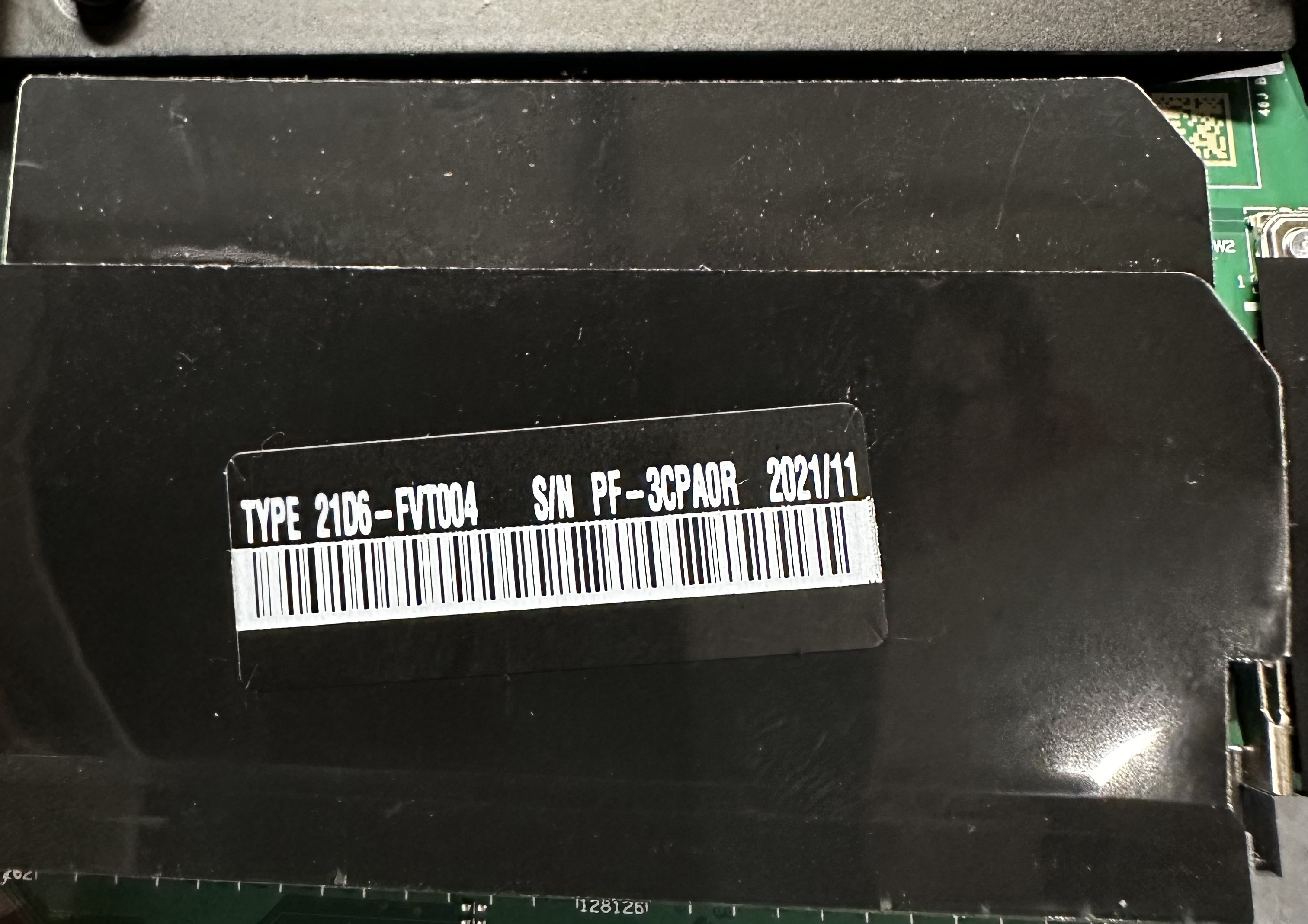

        P16 Gen 1 (Type 21D6, 21D7)
        SN: PF3CPA0R
        In addition, the official website cannot search for this serial number, and I don't know why. Attached is a picture.
        This motherboard has three BIOS chips, two of which are main BIOS.
        The machine cannot boot up.
        Please help me cleaning.
        Thank you.

          its very old bios pre production. this was likely early sample board that got sold w fake serial.
          this is oldest bios in website readme
          N3FUJ01W (exe name) 1.07
          (N3FET22W) bios version 1.05
          (N3FHT17W) EC version For Factory Use
          yours says N3FET13W
          if you try to flash a newer bios it might not work due to chipset also likely pre production.
