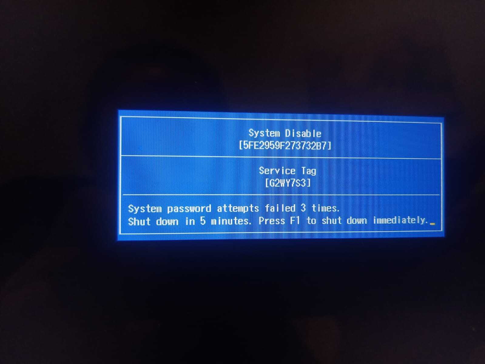

        hi folks can helpme unlock this bios password for Inspiron 14 7425 2-in-1
        AMD ryzen 5000series
        servicetag: G2WY7S3​
        thanks a lot
          thanks a lot
          your password is: 61563930 Press Ctrl+Enter+Enter after typing it.
