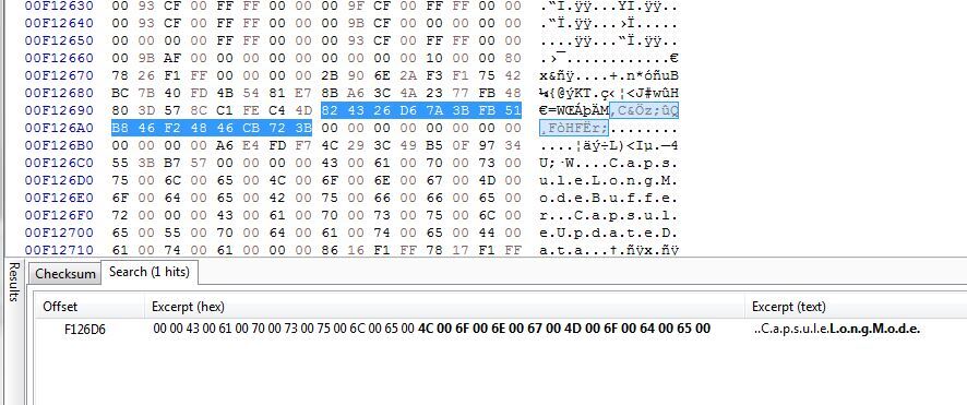

            There are some older bios updates that you can get from the microsoft update catalog. To do this,look for a string of hex in the bios above C.a.p.s.u.l.e.L.o.n.g.M.o.d.e.B.u.f.f.e.r (search for capsulelongmodebuffer in ASCII)
            Click image for larger version  Name:	Capture2.jpg Views:	0 Size:	76.5 KB ID:	3292498
            Select16 bytes after ÁþÄM 82 43 26 D6 7A 3B FB 51 B8 46 F2 48 46 CB 72 3B .Those bytes are a UEFI GUID,and they need converting to a standard GUID
            https://toolslick.com/conversion/data/guid
            convert 82 43 26 D6 7A 3B FB 51 B8 46 F2 48 46 CB 72 3B
            to a standard GUID D6264382-3B7A-51FB-B846-F24846CB723B .You can find this converted GUID in the bios using UEFITool.
            Now you have the GUID go to https://www.catalog.update.microsoft.com and enter the GUID in the search box
            https://www.catalog.update.microsoft...6-F24846CB723B
            Download the CAB file from any of the updates ,extract with 7-zip or winRAR.
            Check the GUID in the inf file to make sure it has the same hardware ID . https://www.badcaps.net/forum/troubl...ardware-id%60s
            Edit: Remove the AMI PFAT CAP header from P**CFG040.CAP using AMI_PFAT_Extract.exe then edit P**CFG040.CAP -- 1_00 -- AMI_PFAT_1_DATA_ALL.bin to the right size.

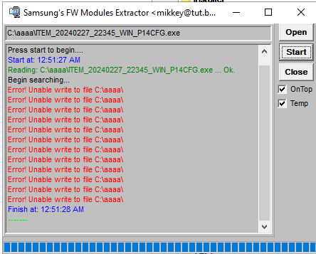

                    Hi volinakis, thanks for your help.
                    I have just downloaded the same file from Samsung just in case yours were corrupted, and have the same content and same problem when open it with find_gz.21.
                    Seems this file is corrupted or have some anti-unpacking technique.
                    Here is the error it shows:
                    Is it the same error it shows for you?
                    I hope somebody have a trick to overcome this.

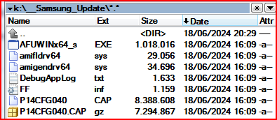

                              Hi SMDFlea, I have tested in windows 7 but doen't work for mi, even in compatibility mode and 640&480.
                              I have got it running the ITEM_20240227_22345_WIN_P14CFG.exe as is, in win-pe and looking at temp dir. It's a bit tricky because the __Samsung_Update folder is erased in no time.
                              This is what I get:
