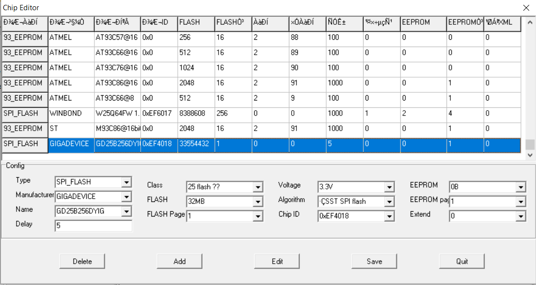

    I'm really noob for ad this type of chip can i get a help please how can i do it i really want fix this motherboard for myself but i don't really understand what i need to do.
    I had this Windbond 25Q256JWEQ which chip is similar to choose this?
    I tried use chatgpt what i need to add but not really understand how work i tried select the FW version but sadly it 0 when i want read the chip.

          Thank you for the link maybe i noob but how can i use it i need overwrite databas file from here EZP2019+ database.rar if i does this the program not open and crash.
          If i select W25Q256FW 1.8V with the 1.8v adapter not recognize it. I tried select this

            If you're using a clip, it may take few tries to align it properly, even if it looks right sometimes there's 1 or 2 pins that don't make proper contact, make sure you didn't connect the 1.8V adapter or the clip the wrong way, also try lowering the SPI clock speed to 3MHz or even 1.5MHz
            I don't own that programmer so I can't give advice how to use it, sorry, but check some YT videos, couldn't find videos in English for this programmer

              Help EZP2023+ updated chip database for w25q256jveq?
              by Troystain
              Hello, anyone here have updated ezp2023+ chip database in .dat file format.
              I need to add w25q256jveq chip but I do not know what data should I type.
              I'm using the ezp chip dabase editor posted from here https://www.badcaps.net/forum/troubl...ro-programmers
