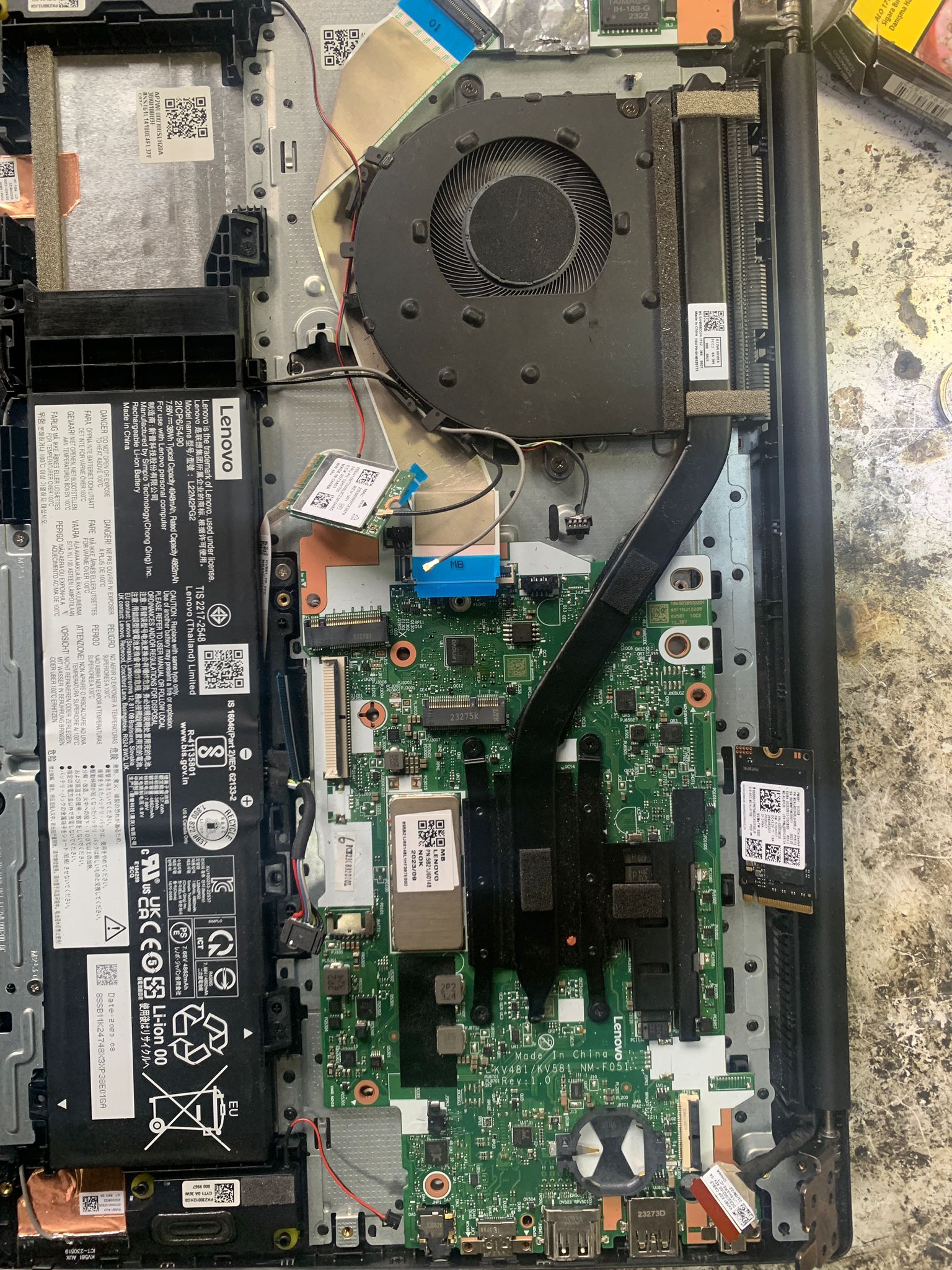

    motherboard code KV481/KV581/ NM-F051 Rev 1.0
    cpu R5 7000 SERİES
    S/N.PF4K7WNG
    There is no backup

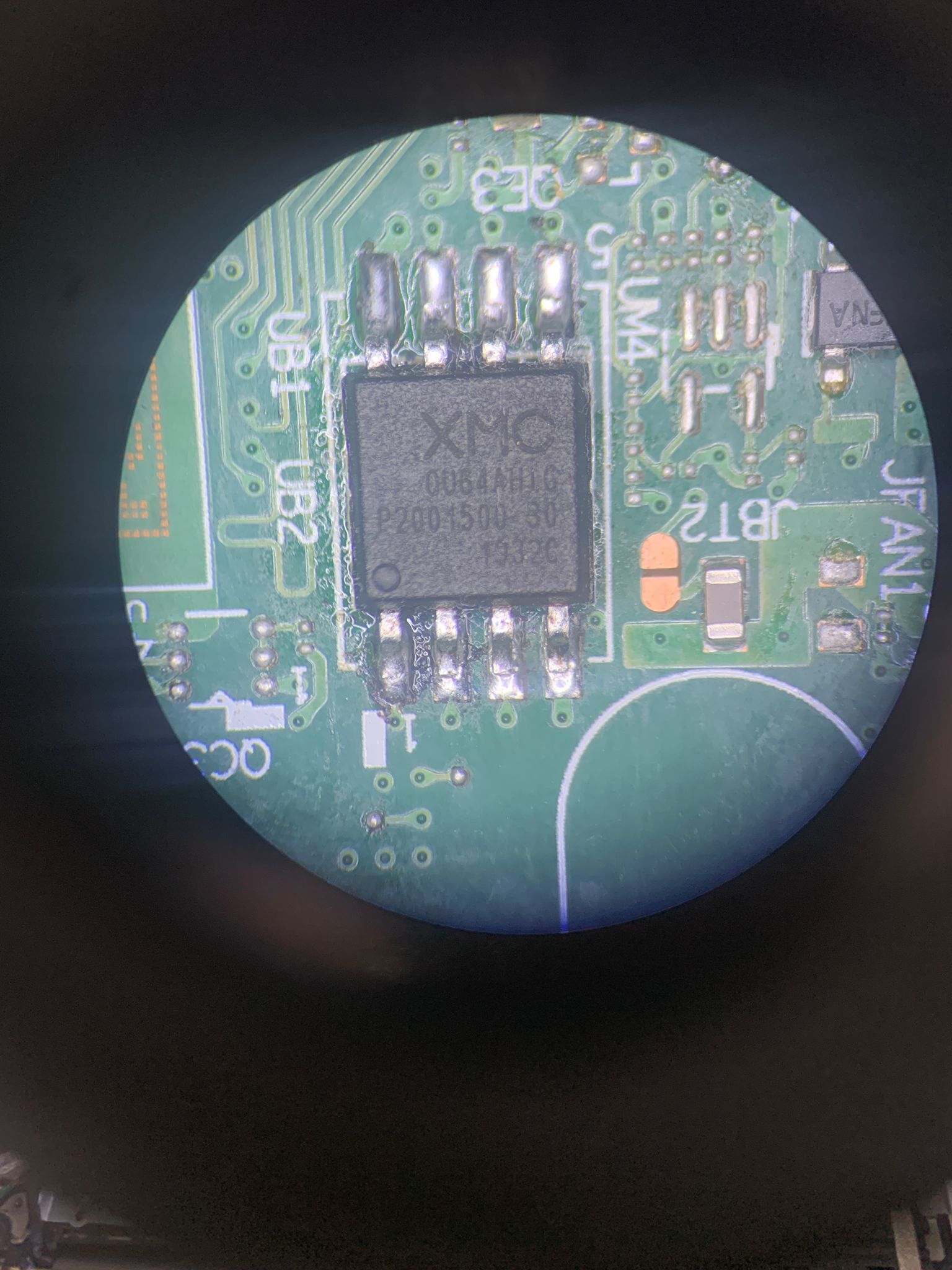

      Thank you for your response, but the size of the BIOS CHİP is...8MB
      XM25QU64A@SOIC8-200

          the original chip

            The chip shows signs of re-soldering.

              Ok I'll try a 128M chip

                The bios chip part number in the schematic is W25R128JWSIQ 1.8V

                  I installed a 128M chip and the device works thanks

                    Thanks for the help it works
