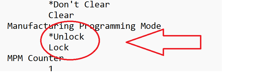

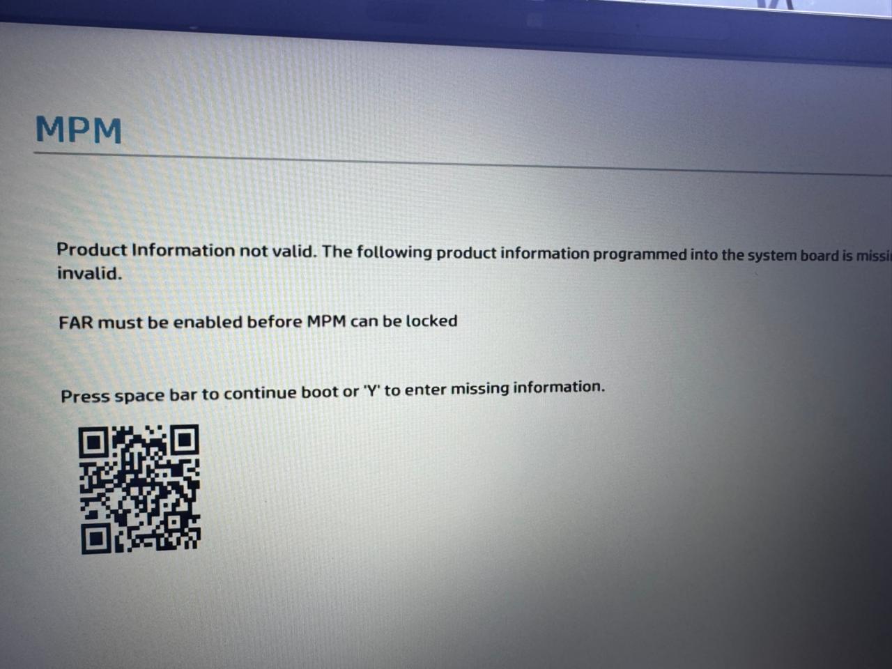

        I replaced the "new "mainboard for my HP laptop elitebook , I often get the error "FAR must be enabled before MPM can be locked".
        I filled in all the DMI information, selected Lock MPM, but it can't be Locked.
        Please help me. How to fix?
        Thank you very much!!!

          Try this DMI file

            #86
            Originally posted by Stefan Steff
            Try this DMI file
            thanks! this working !

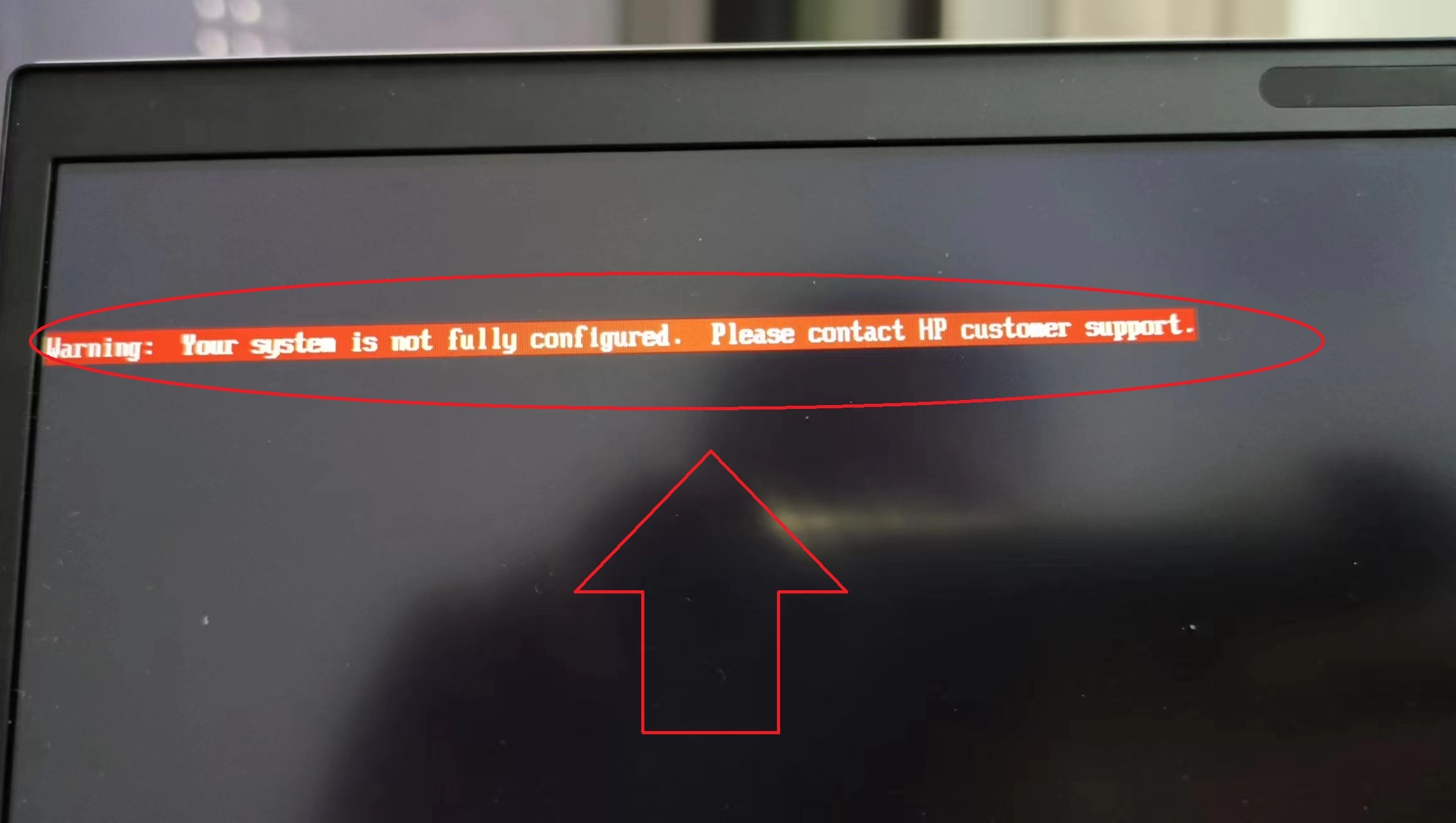

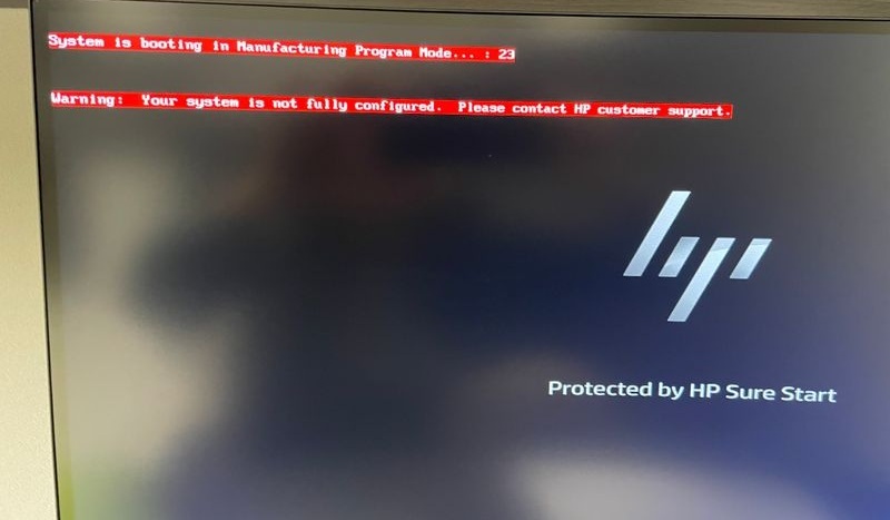

              I have a problem: I add full information . but still have error "Your system is not fully configured. Please contact HP customer support."
              can you help me fix DMI ?
              thanks !!!!

                #88
                thanks !!!!
                Start from 0 again.
                Write your BIOS and fill DMI correctly.

                    Yes it's exactly what I mean...Write your BIOS chip again with the content what you provided in post 83
                    There is no error "Your system is not fully configured. Please contact HP customer support." right?...just the FAR error...
                    Then try to rewrite your DMI data according to what you have...even without any tool, just go to BIOS settings and enter the missing data at option "Set Machine Unique Data" when entering the bios...you have it all in the second file you provided in post 83

                            to fix the system not fully configured,download NbDmifit 2.0 extract and locate ssm.dat run it and click on yes then restart.
