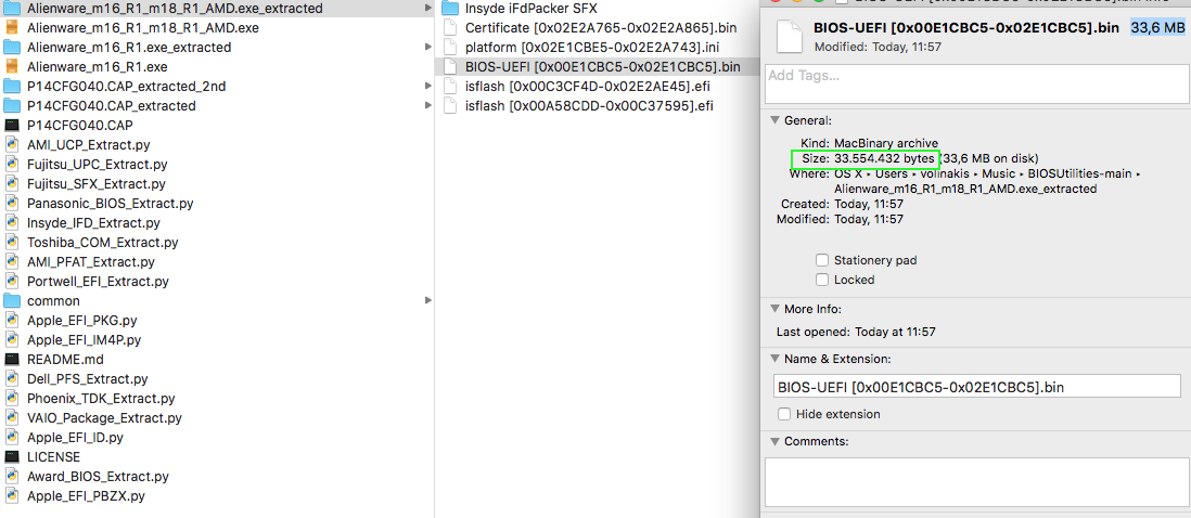

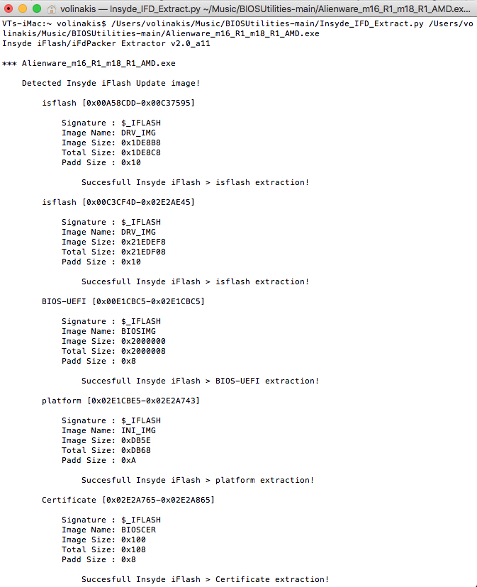

                1. Download bios update .exe from Dell site
                2. Download BiosUtilities by platomav from github. Install python 3.10 or higher.
                3. put bios update .exe in the same directory with BiosUtilities and don't leave spaces or dots in name. Ex: Alienware_m16_R1_m18_R1_01.01.01_64.exe rename it as Alienware_m16_R1_m18_R1_01_01_01_64.exe
                4. use cmd or terminal to extract bios: Insyde_IFD_Extract.py Alienware_m16_R1_m18_R1_01.01.01_64.exe You'll get a folder Alienware_m16_R1_m18_R1_01.01.01_64.exe_ectracted.
                5 Inside the folder you'll have bios extracted, exact size, see pics.

                  I've tried to run BiosUtilities by platomav before. Someone else posted it on this forum a while ago. It just says "Done!" then closes without actually creating a bios image or giving an error. I managed to get it to work w/ your instructions.
                  The bios I extracted from Dell's .exe for 1.13.1 using a hex editor is the same as the one that is created using BiosUtilities, however, the bios for 1.2.2 is not. The bits are shifted 5 to the left in the one made by BiosUtilities vs the one I extracted and flashed with a hex editor. Meaning I missed the first 5 bits and last 5 bits of the bios file for 1.2.2. I remade it in hex editor and checked the files and they are idenitical now. I will just use BiosUtilities going forward though, much simpler.
                  JJong seems to be having trouble flashing older bioses. Is it possible there is a check in the bios for the service tag not to be blank? A check in the bios for the bios certificate files? Or is it possible that more than one chip is being flashed at the same time? I know the M16 has an EC controller but the M16 likely does not.

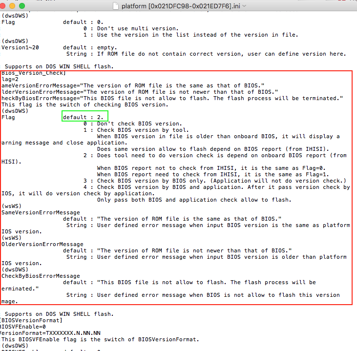

                                  nope, you have to modify platform.ini to skip checking bios version.

                                      you can try yourself, use 7zip to create SFX executable.
                                      • Arc717
                                        • May 2024
                                        • 33
                                        #60
                                        I made an SFX executable. It just created a new folder with the original .exe in it. When I unzip the .exe, I do not see a platform.ini file.
                                        However, searching for "platform" in the hexdump shows like 50 instances. I found two flags by searching for "version check" and "platform" that I flipped from 1s/2s to 0s to not perform checks. I read in the hexdump it does a version check by BIOS version as well as by application.
                                        This did not help though I still get the same error message when trying to flash the bios to a lower version. Could you give instructions that are a bit more specific? I don't dig into binary files regularly.
                                        What do flag do I need to flip in the bios to disable the version check and proceed with the downgrade?
