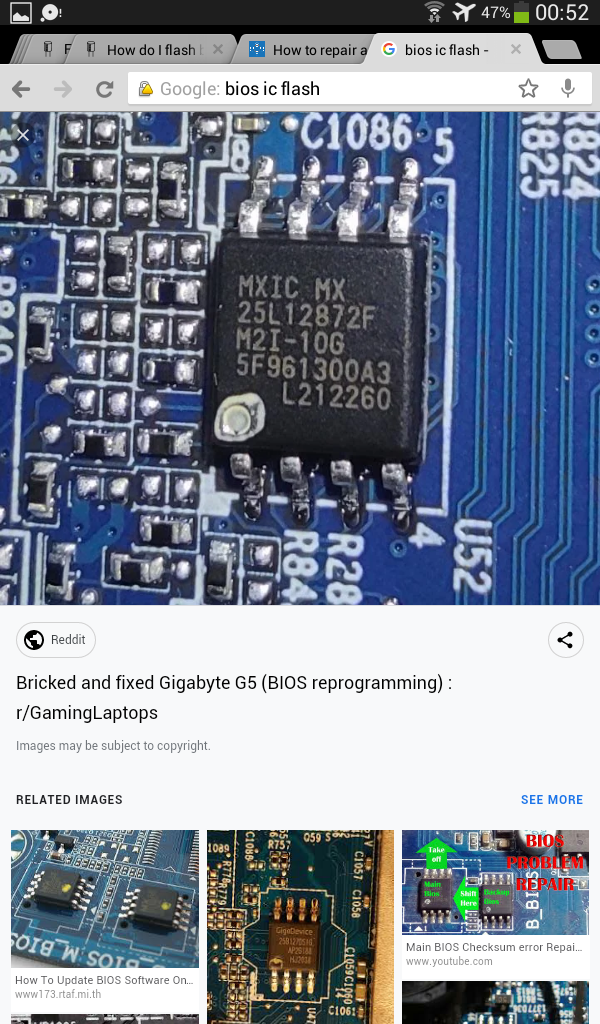

    It is not your model, but article explains needed steps to do bios flashing:
    https://www.tachytelic.net/2021/06/r...-corrupt-bios/
    How to repair a Dell Alienware Area 51 r2 with a corrupt BIOS
    Bios ic is 8 pin with label who include 25xx in it. Often is marked with colored pen, a dot on ic package, but not rule, that means that have programed content.

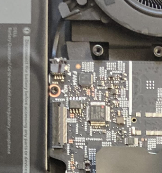

      I can find a tutorial for that, I haven't been able to identify the bios chip. I'm not sure what side of the motherboard it's on, as I can only access the back side that has the ram slots easily. I took a few pics of the motherboard, not sure which of those 8 pin chips is the bios, if it's either of them. I need help identifying the actual bios chip itself.

        Hi , Arc. please can you post the second photo with more resolution? exactly this part please

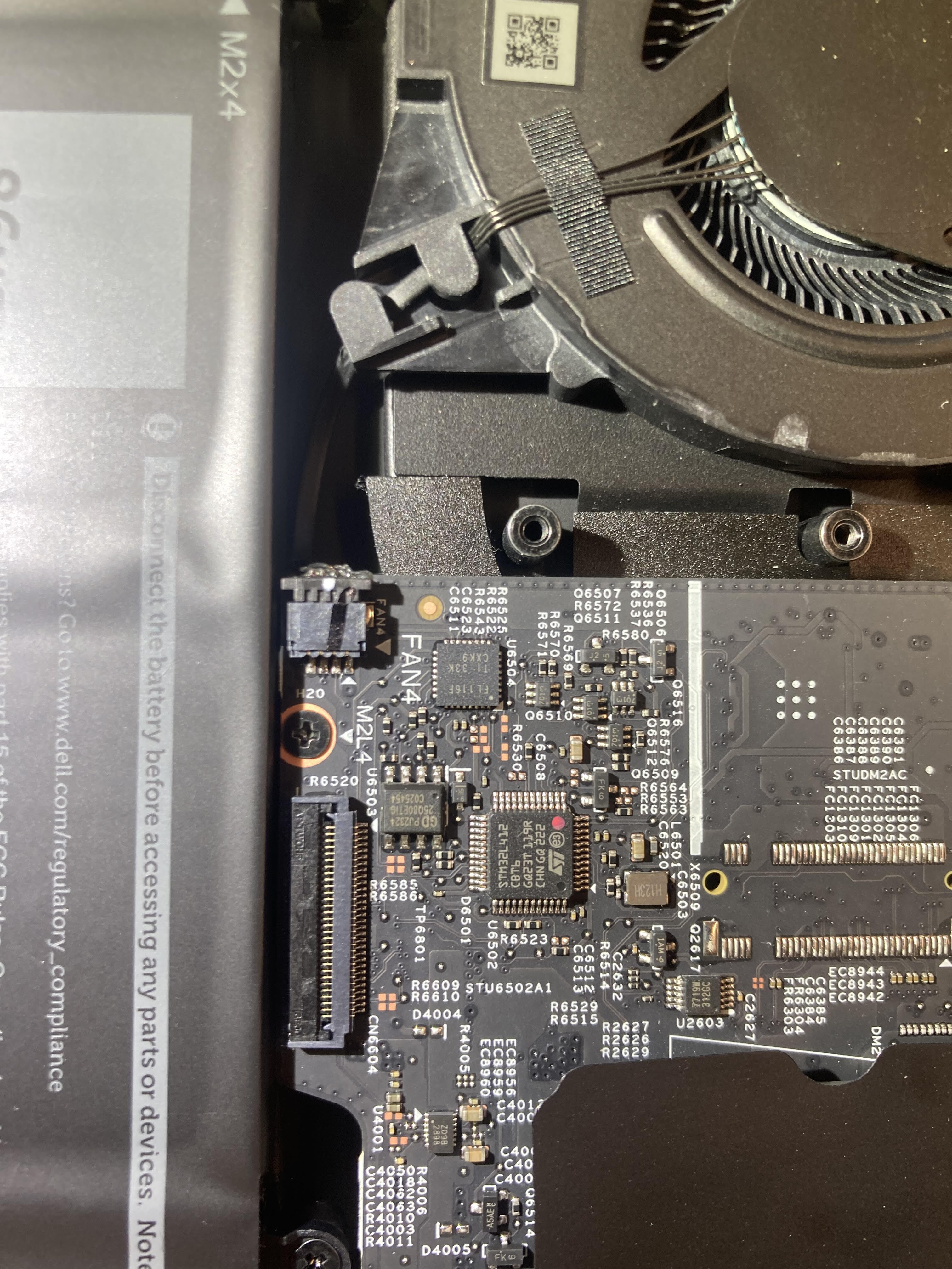

          The first & third photos are close ups of the second one. They are pictures I took zooming in on chips that have 8 pins and could be the bios chip. The motherboard has a backside I cannot access unfortunately without taking apart the whole laptop. Its the side w/ the cpu & gpu. The side you see is the ram side. Idk if there are more 8 pin chips or not on that side. Was hoping to see the word "BIOS" next to the chip.
          • Arc717
            • May 2024
            • 33
            That part you are looking at is in the first photo with better resolution btw, I forgot to mention that.

                the two chips that are visible are not bios chip,unfortunately, for sure you will need to disassemble the pcb. Good luck and remember to discharge yourself of static electricity before disassembling.

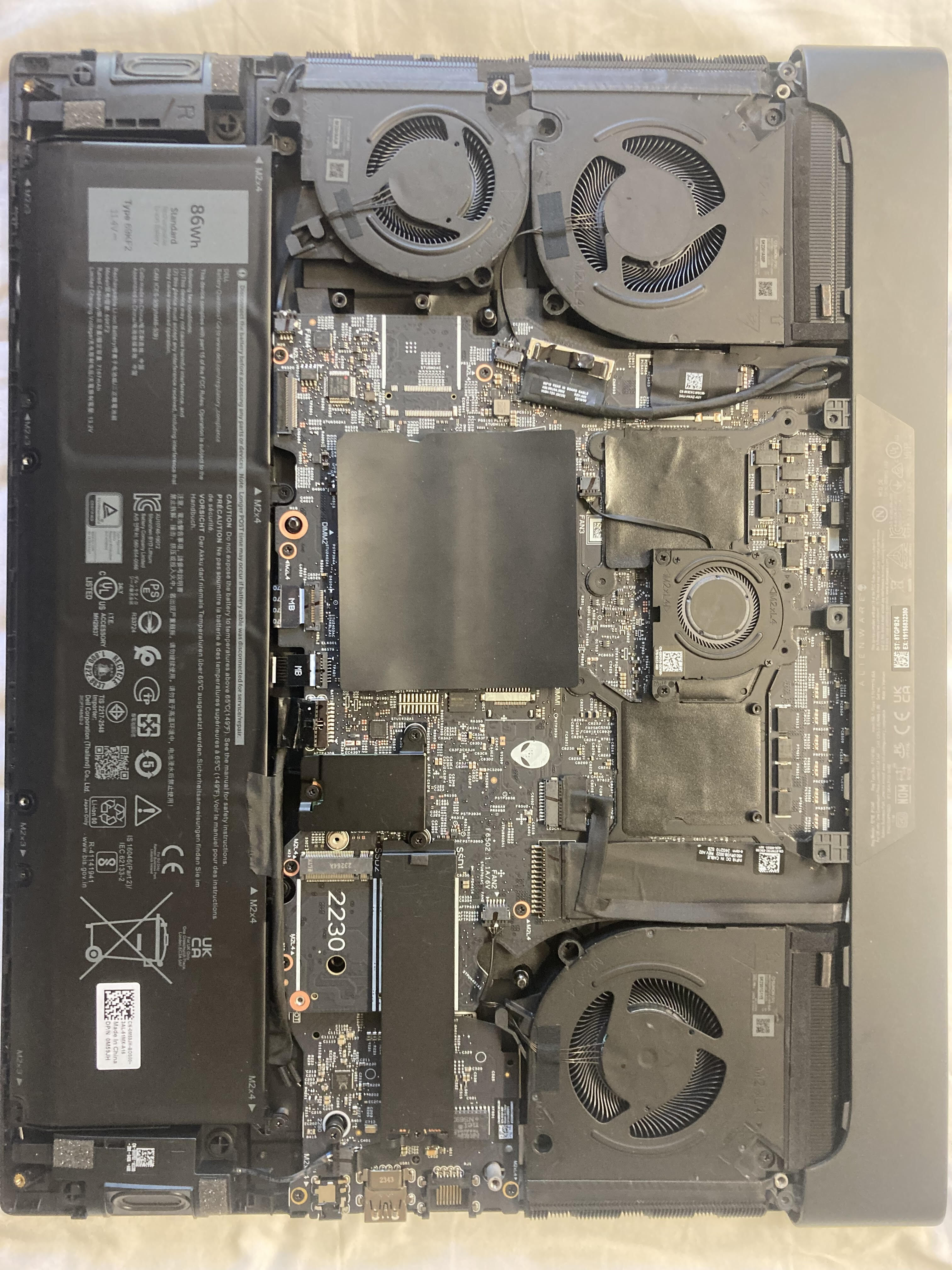

                            I did not. I looked on the backside of the motherboard (the side with the ram. You see this side immediately after removing the back panel). There are only two 8-pin chips on this side that are candidates for being the bios chip, and neither of them are it. The bios chip is definitely on the other side of the motherboard. Flashing it will require a half hour of disassembly, and more of prep. I also learned some bios updates change the microcode of the cpu, and I have no idea how to flash that. I leaned those two things and stopped trying to flash bios after that, since I cannot flash cpu microcode bios to downgrade. I am trying to get bios version 1.13.1 for AMD unlocked right now to access hidden bios menus, but I'm not having much luck.
                            Can I ask, what did you do *specifically* to brick your M16?
                            Edit: If you post a pic of both sides of your motherboard in high resolution (and zoom in on the 8-pin chips) Aleixpaolo may be able to identify it. A serial number of your motherboard also may be somewhere on the side of the bios chip.

                                    piernov Here are two closeup photos of that chip you think may be the bios chip. It is 8 pin but I think it may be too big and too flat to be the bios chip. Also, what would the EC look like? Is that some chip like the bios I would also need to flash separately?
                                    I am a bit hesitant to do a full disassembly of the motherboard still. If you have the same model as me Keith1341 could you take your motherboard out and post a high resolution pic of the other side so we could locate the bios chip? I have M16r1 AMD 7745HX RTX4060.

                                      I was trying to slowly work my way back to 1.2.2 so I could use the Smokeless_UMAF, just as you mentioned. I’ve got the 7845hx/4080 variant. Once I get it disassembled, I can add a pic of the other side of the mobo.
