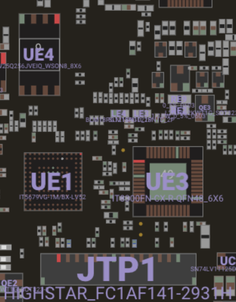

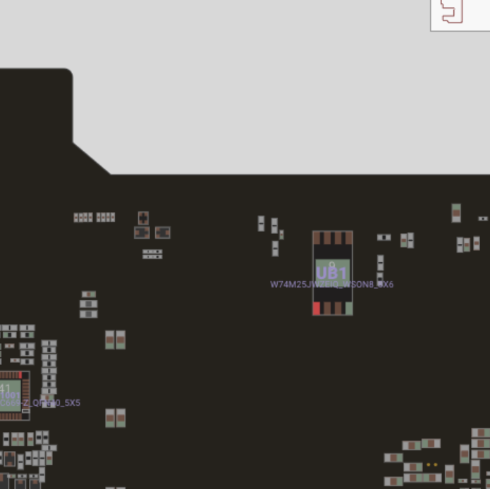

            X13 Gen 2 NM-D442 Type 20XJ
            Click image for larger version  Name:	image.png Views:	0 Size:	86.0 KB ID:	3557435
            Total bricked
            it managed to restart with these files.
            UB1 74M25JW UB1 clean.rar
            Click image for larger version  Name:	image.png Views:	0 Size:	46.4 KB ID:	3557433
            UE4 25Q256JV UE4.rar
ID:	3557468 unknown ​?? see #post 3

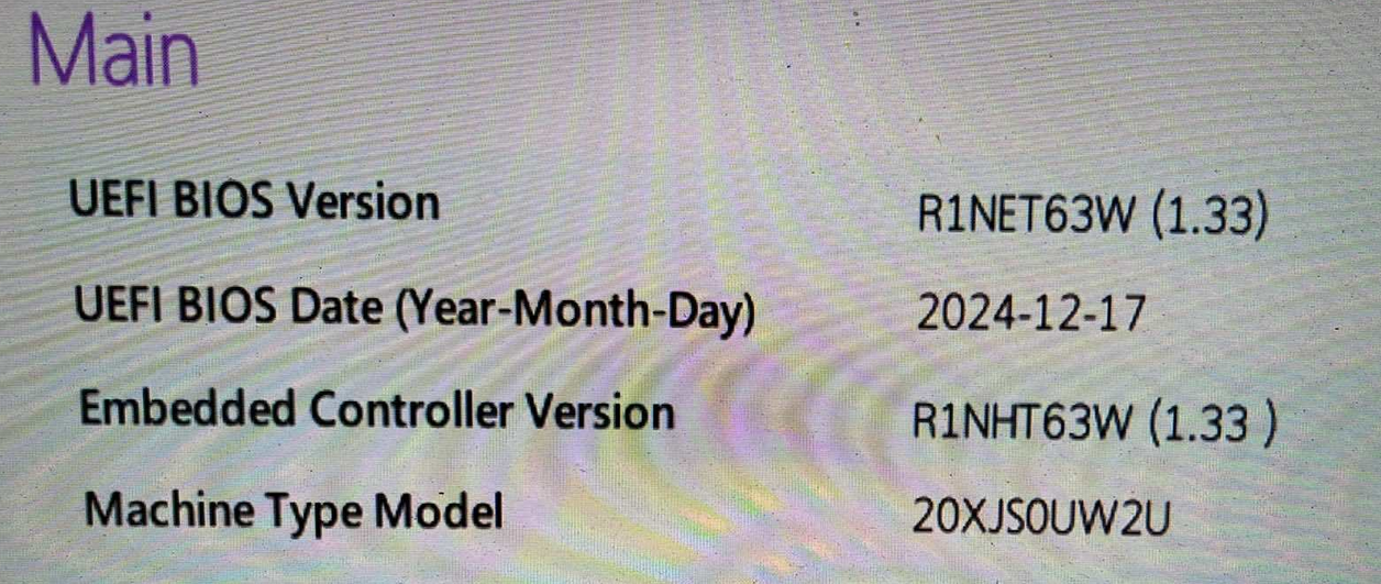

                The Ue4 file above and post #3 poses a problem.
                Tested Ok; Last update 1.33
                comes from my machine after bios update
                UB1 1.33 74M25JW_SVOD4.rar
                Click image for larger version  Name:	image.png Views:	0 Size:	5.9 KB ID:	3559163
                UE4 1.33 W25Q256FV@WSON8.rar
                Click image for larger version  Name:	image.png Views:	0 Size:	4.8 KB ID:	3559164
                The Ec file above must have worked because it allowed me to repair UE4.
                Version 1.26 (R1NHT56W)
                Click image for larger version  Name:	image.png Views:	0 Size:	130.8 KB ID:	3559165

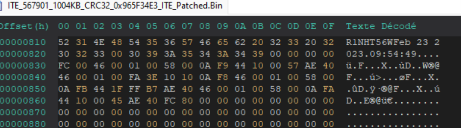

                      in case it is useful to someone, Firmware ITE ITE567X-SB-V0.10,
                      from the update you will get 1004kb, if you try to write only 1004kb the programmer will erase and write 1004kb and you will get a brick as in my case.
                      most likely in these 20kb there are some settings, without these 20kb there is no reaction even to charging.
                      in the hex editor add at the end of the firmware, if you have a dump of 1024kb then just cut off the last 20kb and add at the end of the EC KBC 1004kb.​
