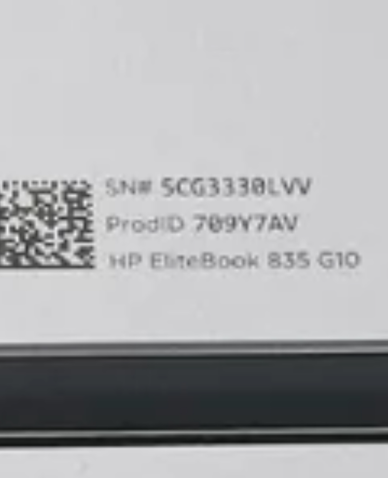

    No This one is a Elitebook 835 G10. I sent you Picture of SN.

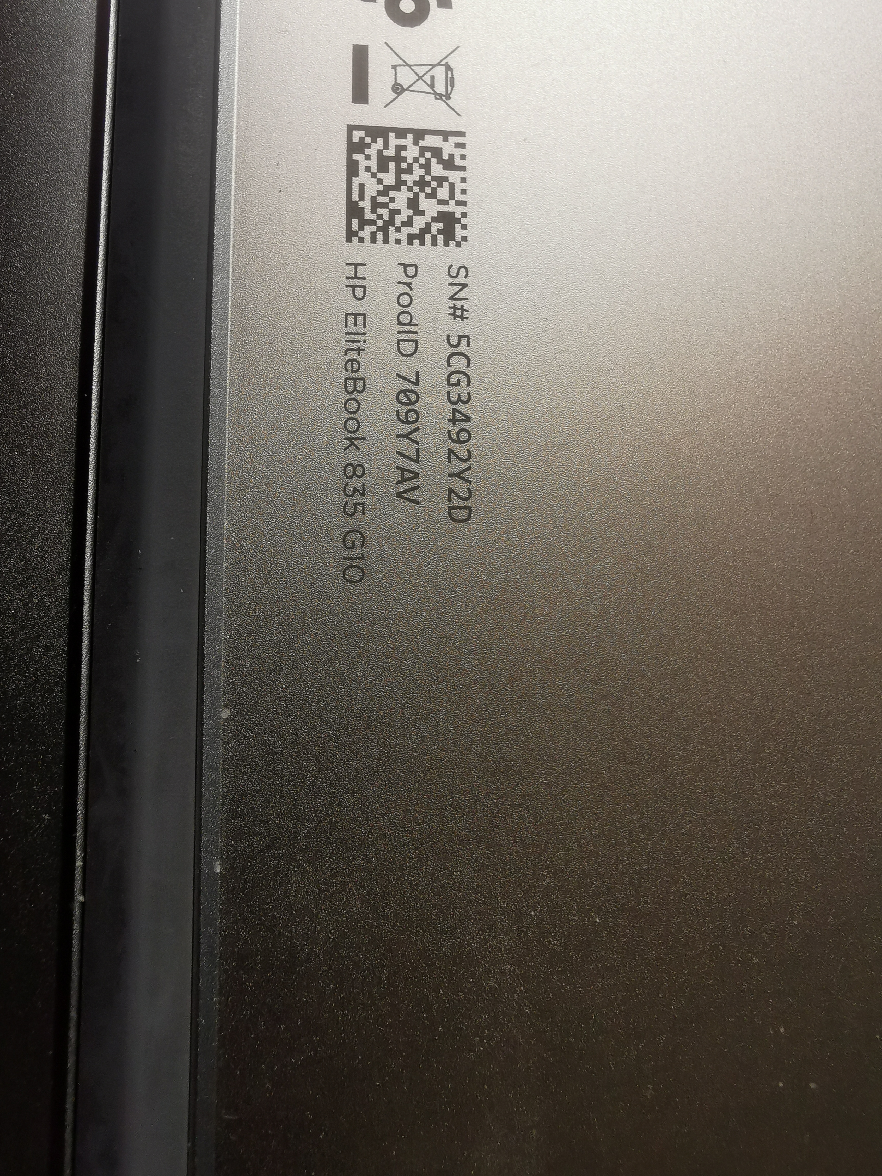

          Hello friends
          Can someone Clear this bios file for me ?
          serialnumber: 5CG3492Y2D
          productid: 709Y7AV
          Thanks for help very much ​

            Originally posted by bartek
            Hello friends
            productid: 709Y7AV
            first boot press f10 apply factory defaults and restart, 2nd boot reset security settings to defaults and exit.
            use BCU. you can permanently disable Absolute lock in BCU.
            here's your DMI:
            Serial Number: 5CG3492Y2D
            Product #/SKU: 709Y7AV
            CT Number: PRVYR00WBIV0JG
            Description: HP EliteBook 835 13 inch G10
            BuildID: 23WWLOBZ601#SABH#DABH
            Feature Byte: 476J6S6b7B7H7M7R7W7m7saBaEapaqauawbUbhcAfPgSguhKjhk8mEn7nWngpDpnpqprqMqkqz.dq
            MAC Address : 60:6D:3C:FC:F9:04​

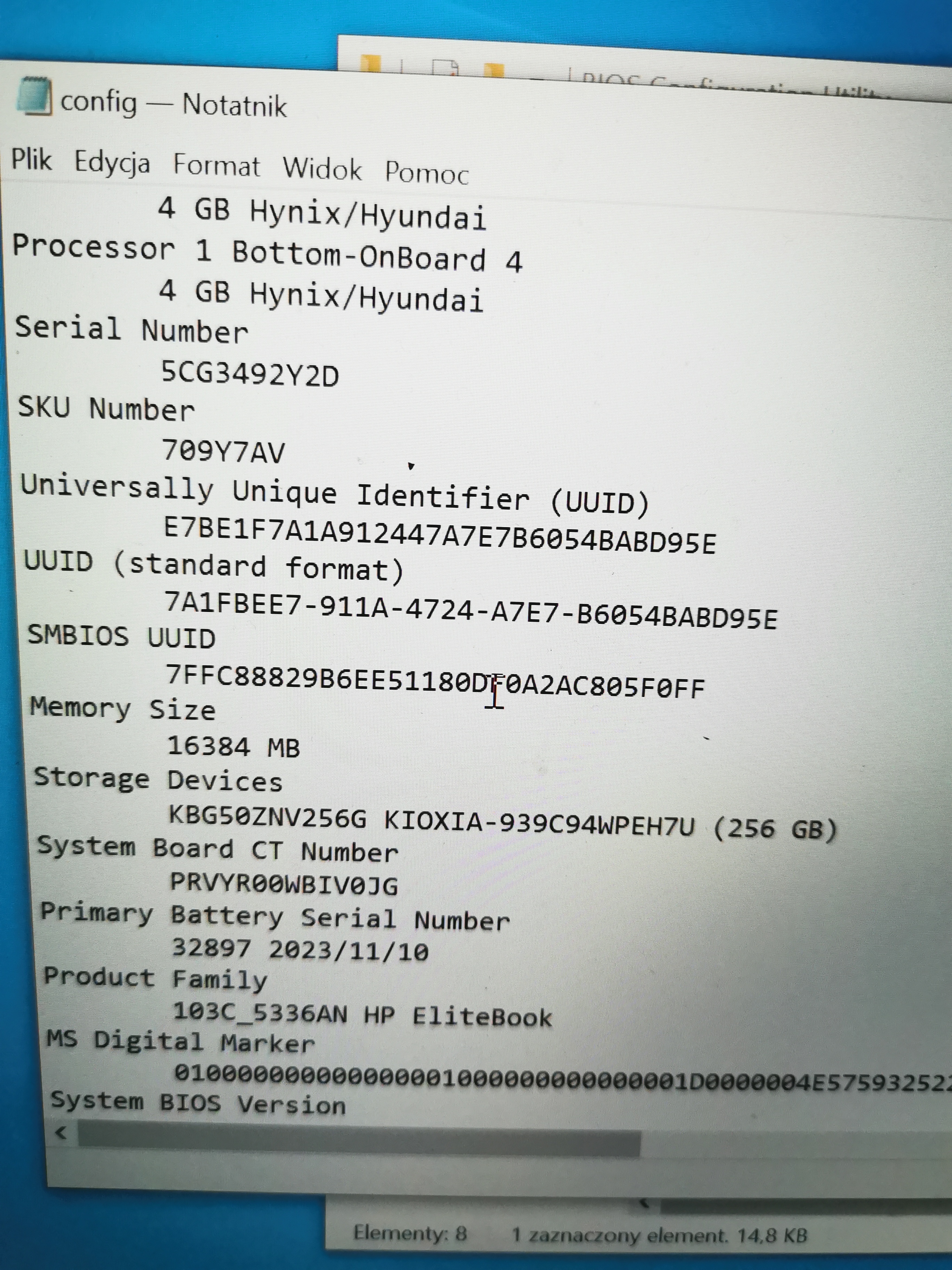

            • bartek
              • Sep 2017
              • 25
              • Polska
              here's your DMI:

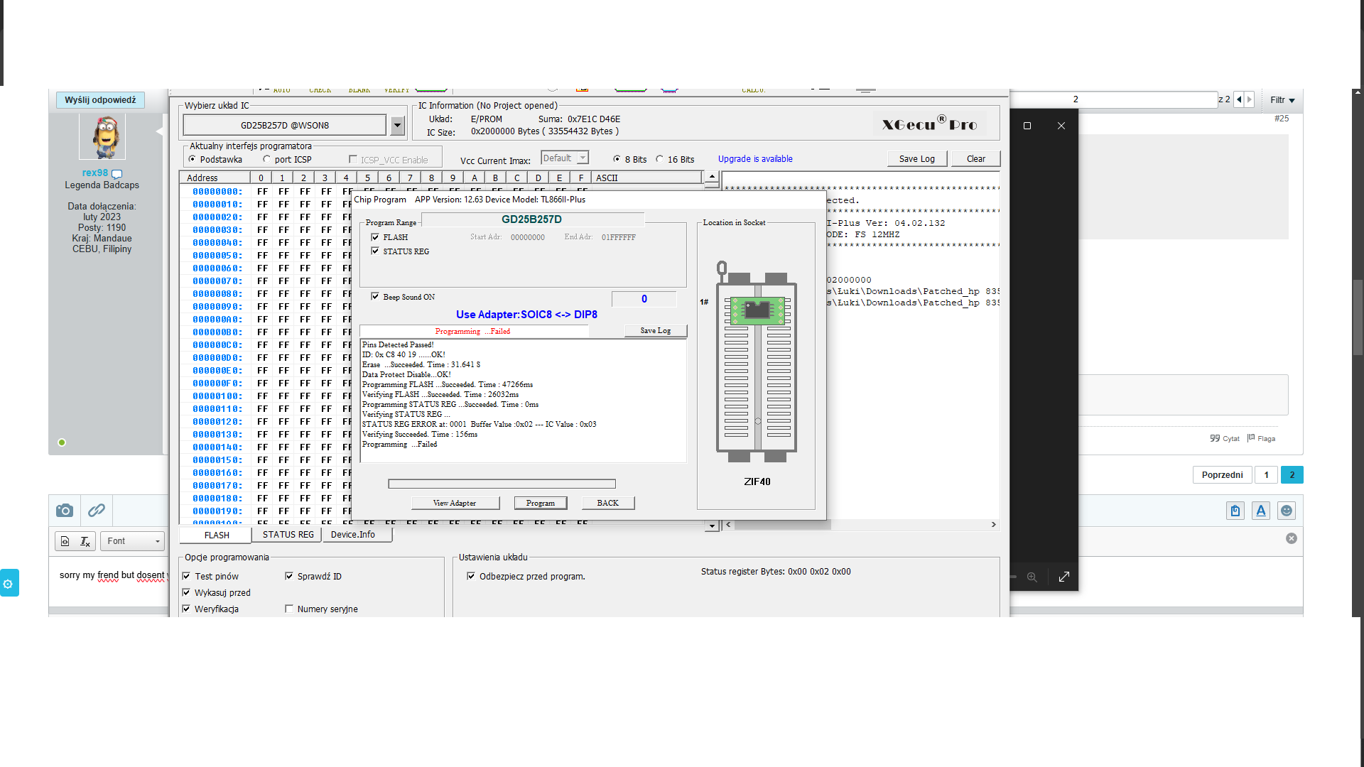

              sorry my frend but dosent work i have first turn on and i have password
              but if i programing bios i have failure error
              • rex98
                • Feb 2023
                • 1297
                • Mandaue CEBU, Philippines
                try this new one same procedure
                • bartek
                  • Sep 2017
                  • 25
                  • Polska
                  Thans you so much bios its clear thanks one mkre time

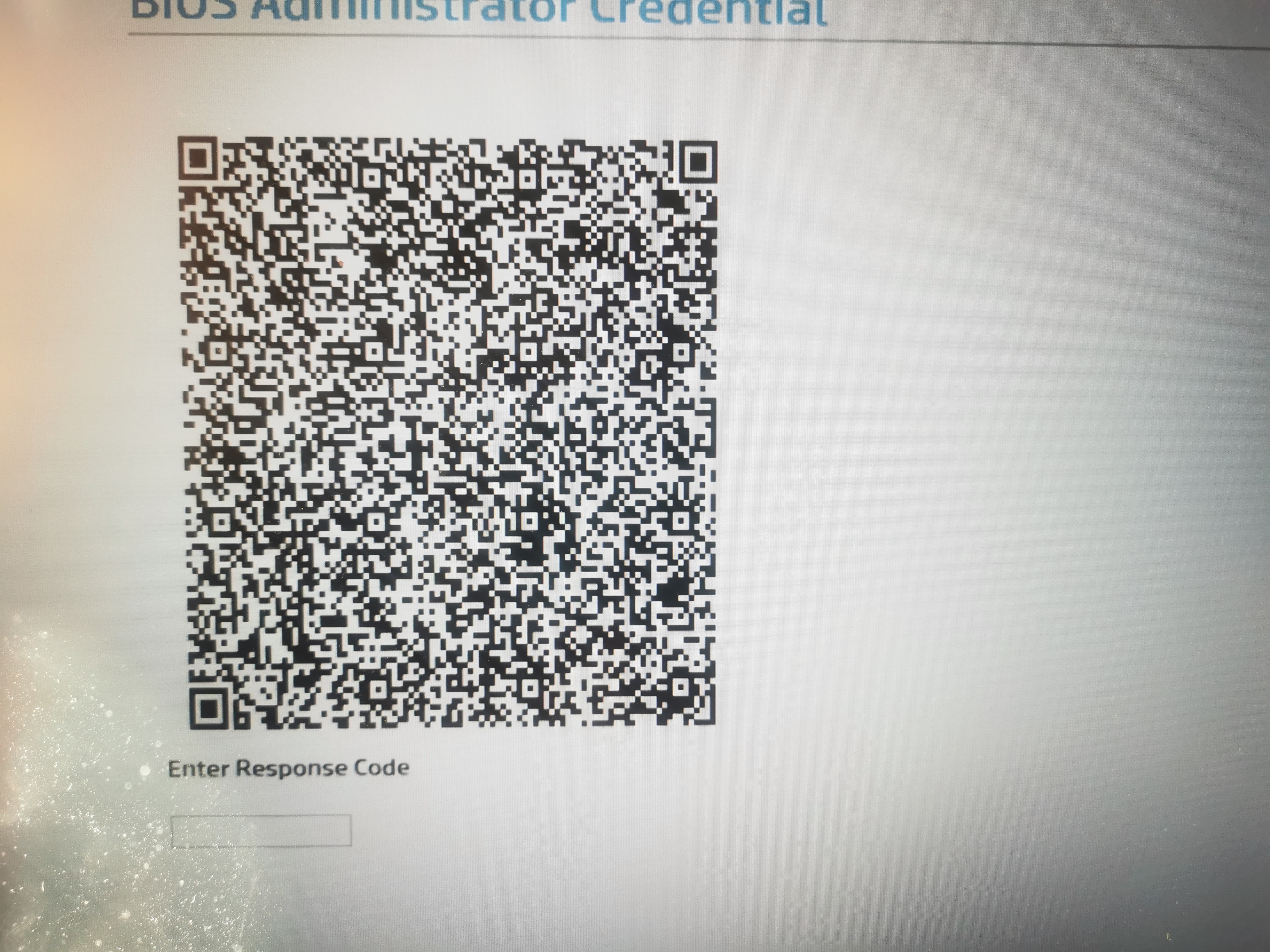

                    • bartek
                      • Sep 2017
                      • 25
                      • Polska
                      #30
                      here's your DMI:

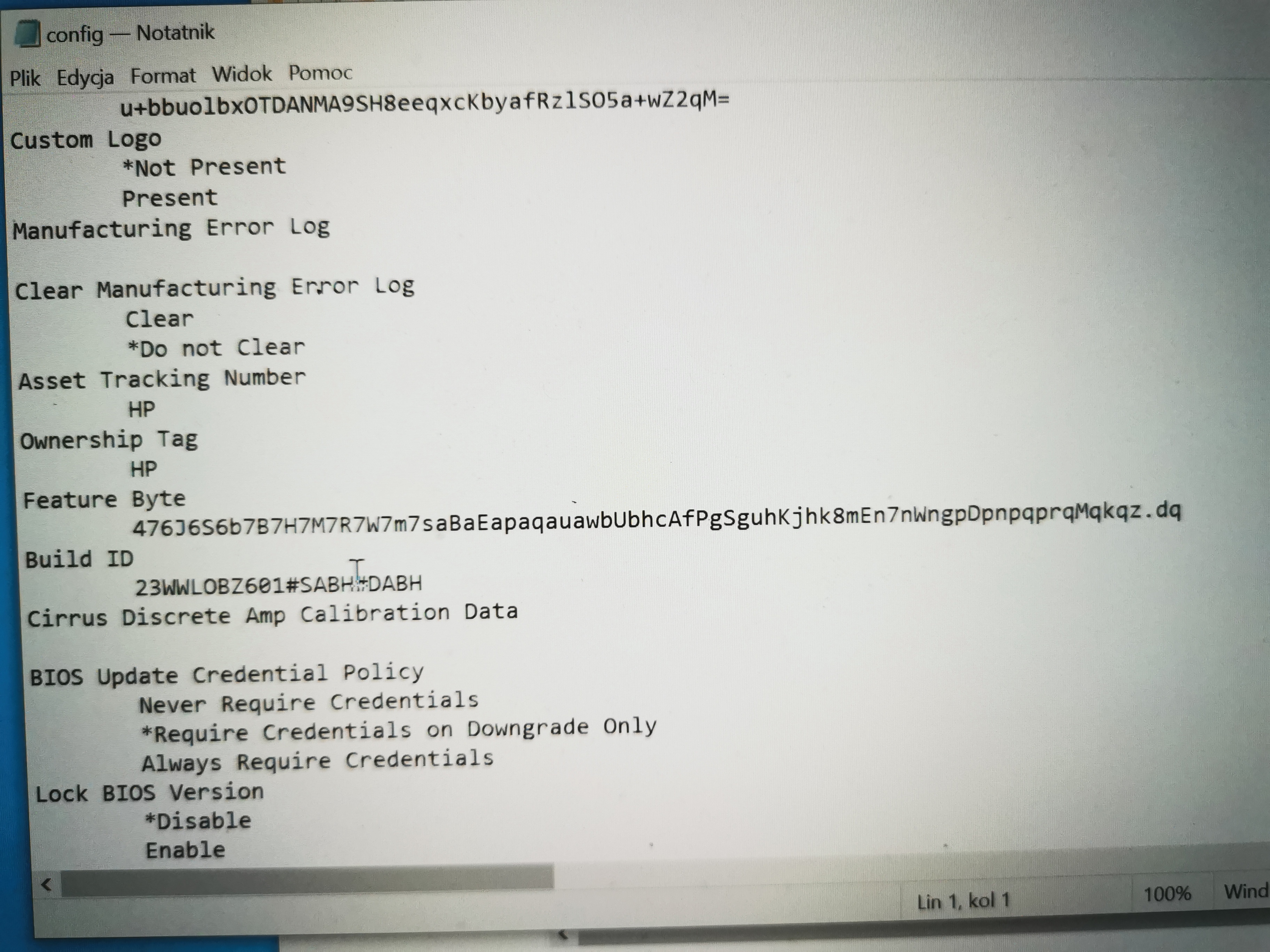

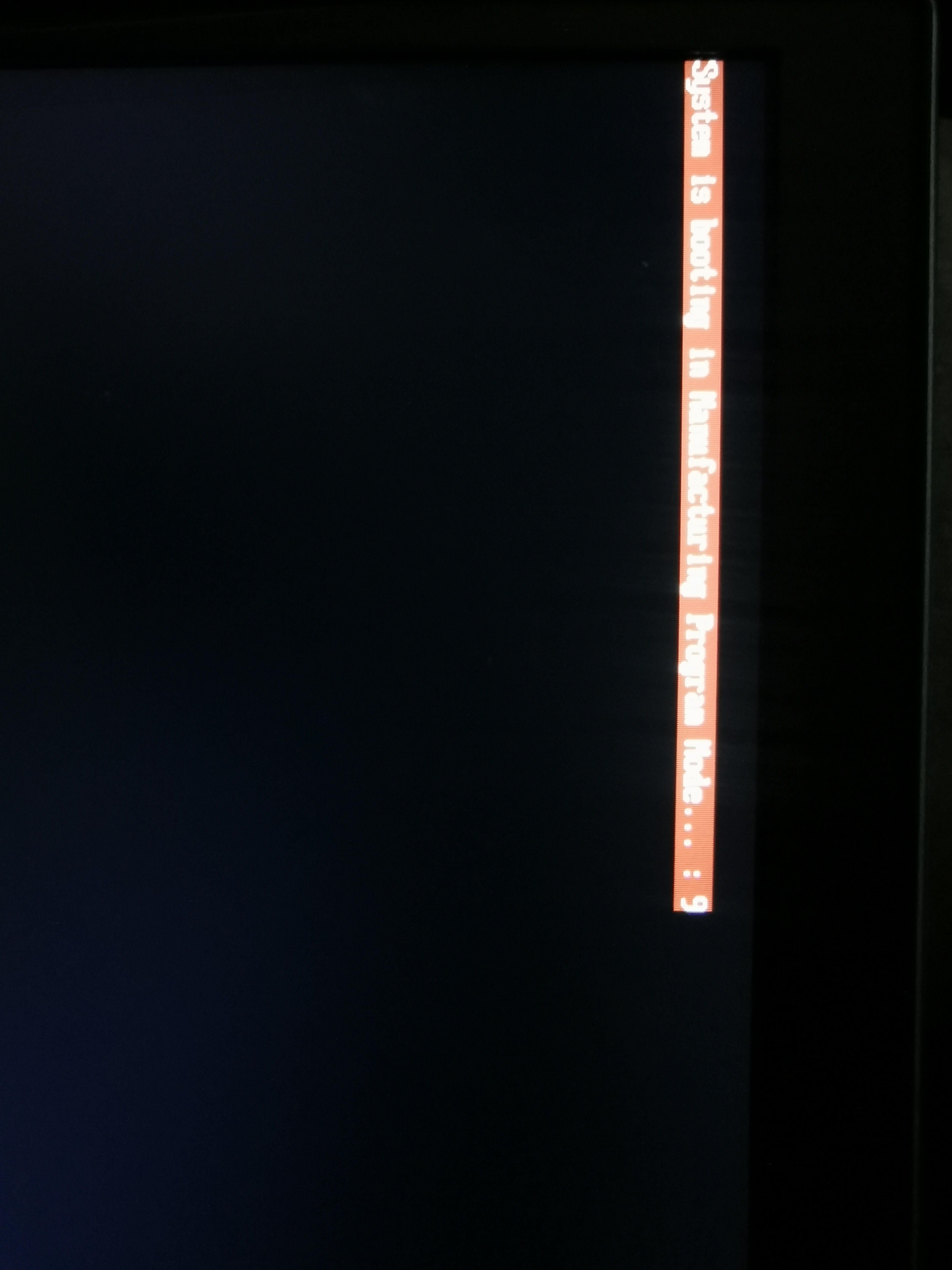

                      I write all information about you but i cant turn off manufacturing mode
                      • rex98
                        • Feb 2023
                        • 1297

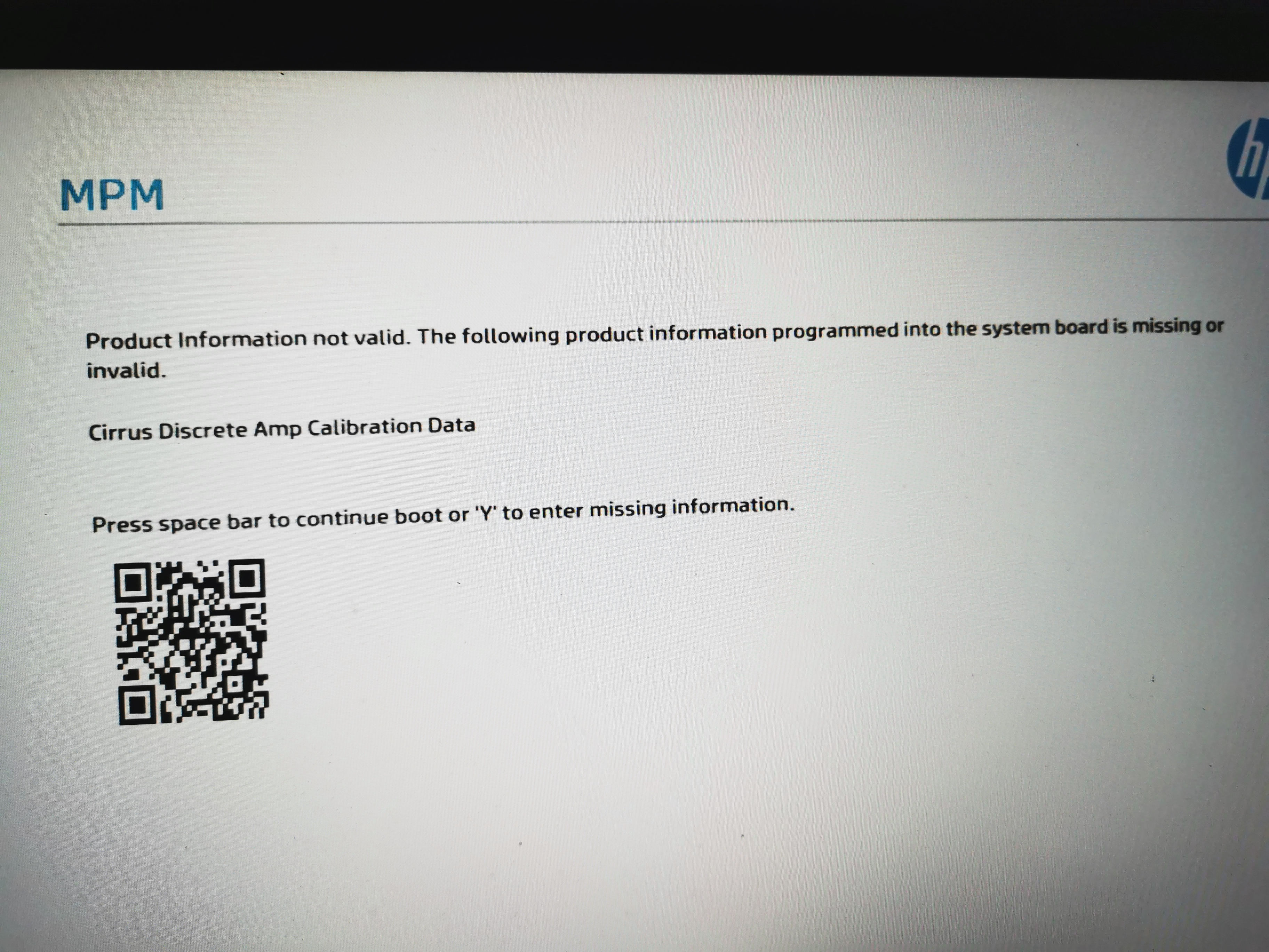

                        #31
                        put this info in BCU
                        Cirrus Discrete Amp Calibration Data
                        3000000002000000536B0601D3350B00C08BDF3A4EF2D90117013728536C0601D3350B003044513C4EF2D9011701C428
                        • bartek
                          • Sep 2017
                          • 25
                          • Polska
                          #32
                          thanks so much all good all work

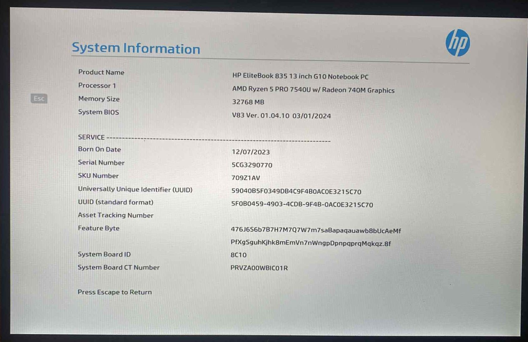

                              #34
                              Hi i need help to remove password from bios.
                              HP EliteBook 835 G10
                              Serial 5CG3290770
                              SKU 709Z1AV
                              Thanks in advance
