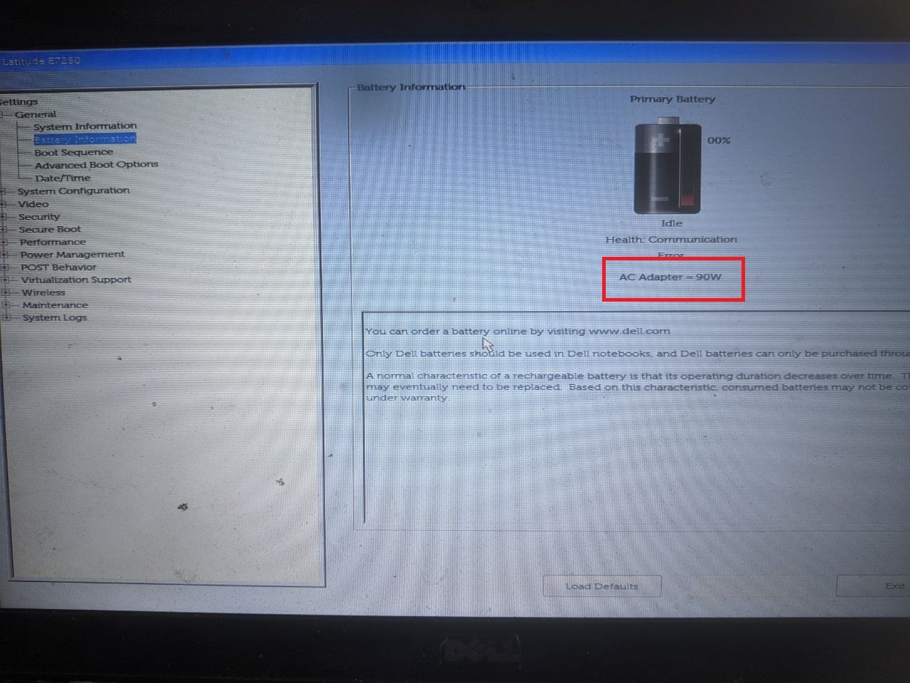

    hi guys, i have dell inspiron 5570 with a maddeningly slow bios.
    specs are: service tag 6MSTDP2 CAL50/DAL10 LA-F115P REV: 1.0(A00) CORE I5 with radeon graphics
    When I turn on the computer it takes approximately 5 to 10 minutes to boot Windows, sometimes up to 15 minutes.
    That slowness is visible even within the bios menu. It seems as if the clock frequency has been reduced drastically
    I already tried some dumps that are in this magnificent forum, I also followed the tutorial by mr SMDFlea​ to make a bios with clean ME region
    But, the result is the same
    I attach a video so you can see my problem. I ask for your help to know what else I can do.

    Check adapter detect ( Unknow is FAIL )

      Thanks for responding, sorry, which adapter are you referring to?

        Adapter detect in bios

          is detected correctly
