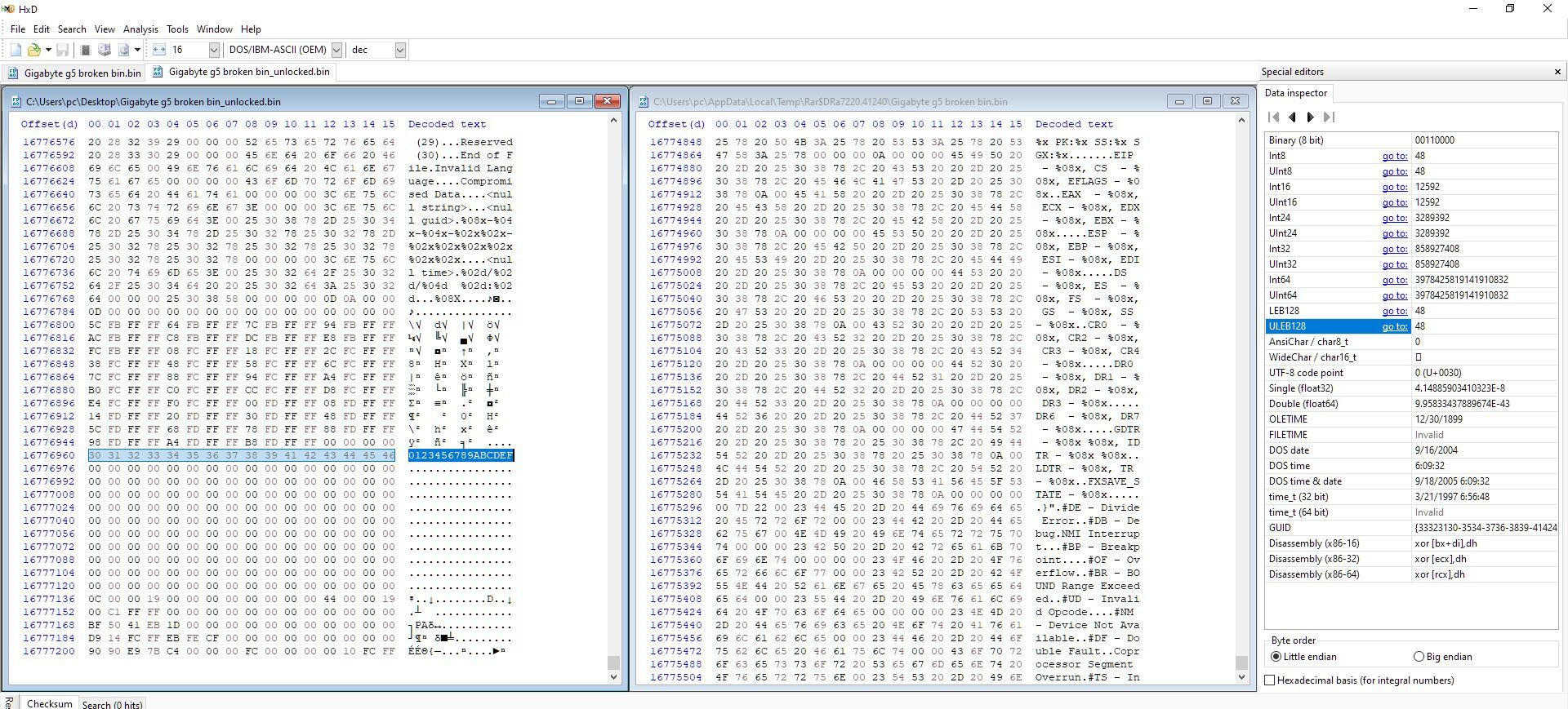

    Hi, I bought a gigabyte g5 kc from a friend of mine for cheap cause he forgot the bios password, my main issue is that he changed a lot of things in the v core settings which led to the pc overheating liek crazy, i have a dump from the bios file and i wish to get some help removing the bios password
    MOBO S/N 1TNH55DP1250306
    P/N 6-77-NH55DPQY-DO2-3D
    LAPTOP S/N SN21251J002692
    P/N 9RC45KC02CE1E1FR501

    try this..

      thank you for the help, an other used pmed me and we fixed the issue, thank you so much tho !

        Hey can you tell me how you did I am in the same situation
          compare the bios from post #1 and post#2..

            sorry I'm not a programmer could I just flash the second rom or it won't help

              compare them with the HxD program...you can find it for free...

                i installed it and I'm comparing so where can i find the password

                    try pass: MollylovesfY
