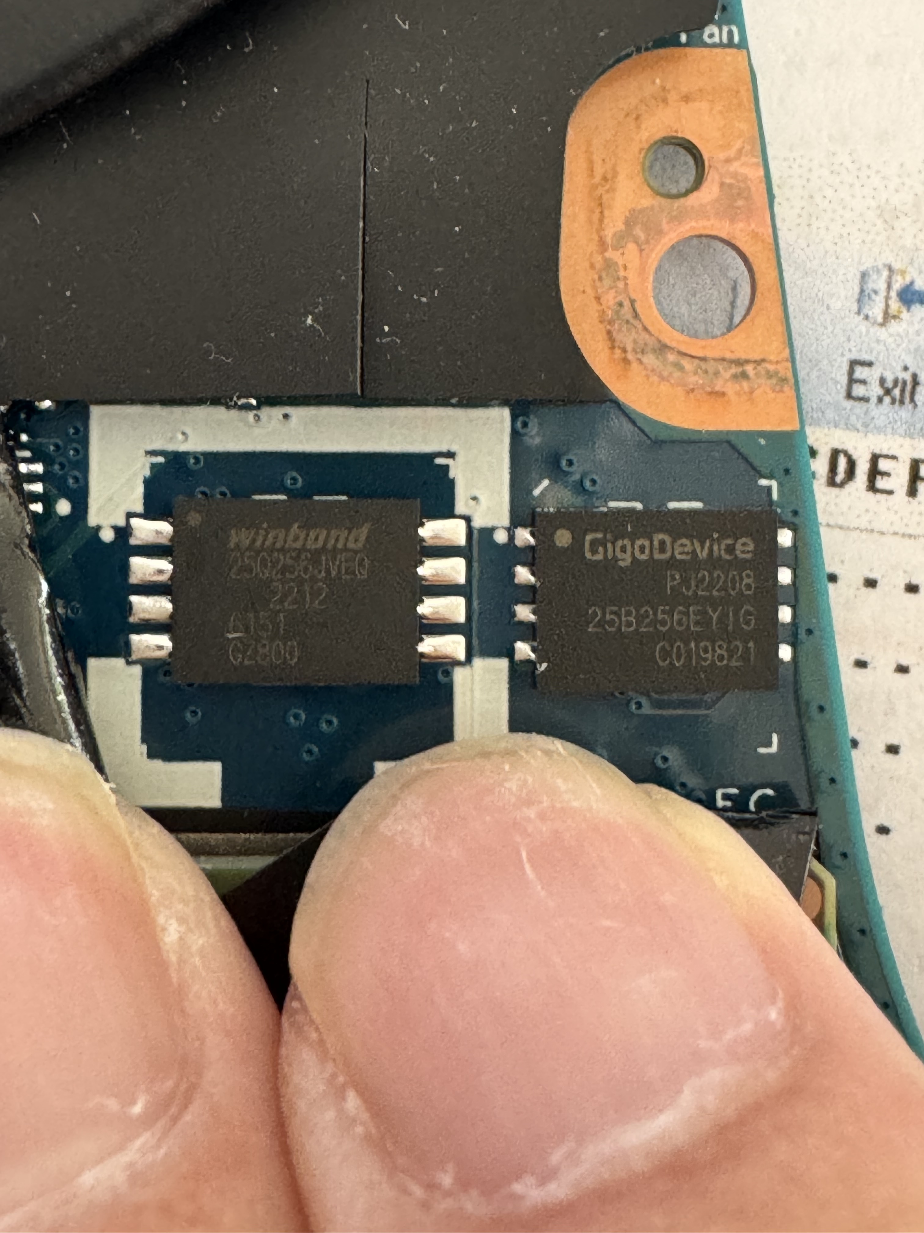

                  hello,
                  please help me remove password
                  HP EliteBook 630 G9
                  SN: 5CD2261B5L
                  • rex98
                    • Feb 2023
                    • 1293
                    • Mandaue CEBU, Philippines
                    Originally posted by alphonse2024
                    hello,
                    HP EliteBook 630 G9
                    SN: 5CD2261B5L
                    bios is corrupt read again and verify after reading.
                    • alphonse2024
                      • Jun 2024
                      • 10
                      • JAPAN
                      No matter how many times I read it, I get the same result. It is a combination of asprogrammer 2.0.4 and CH143a. When you turn on the power, the password entry screen will appear. The bios chip is reading from W25Q256JVEQ. Is this correct.
                      • alphonse2024
                        • Jun 2024
                        • 10
                        • JAPAN
                        Should I attach the BIOS file read from 25B256DYIG?
                        motherboard have 2 bios chip.
                          hi there is too many dump file in this thread.. give it a try
                            Do not use asprogrammer its a crap tool. use neo programmer
                            • alphonse2024
                              • Jun 2024
                              • 10
                              • JAPAN
                              Which version of neo programmer is better?

                                  • hoaca388
                                    Badcaps
                                    • Jan 2022
                                    • 12354
                                    hello,
                                    HP EliteBook 630 G9
                                    SN: 5CD2261B5L​
                                    HP EliteBook 630 13 inch G9 Notebook PC
                                    CTNumber_6MFDN0AWYG58JW
                                    Serial_5CD2261B5L
                                    Sku_6X725PA#ABJ
                                    BuildId_22WWRTCT601#SABJ#DABJ
                                    Fearture byte_476S6b7B7H7M7Q7W7m7saBaEapaqauawbhcAdpdqfAfPgSguhKjhk8mEn7nVpTpqqjqz.Ef
                                    • alphonse2024
                                      • Jun 2024
                                      • 10
                                      • JAPAN
                                      it's worked. thank you.
                                      I used T48 programmer. CH341a could not chip read. it is purchased at aliexpress.
