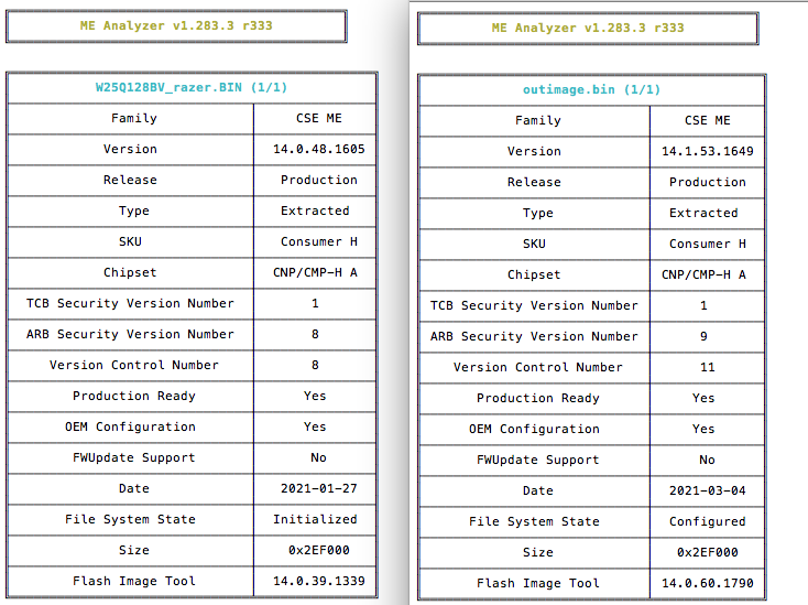

    Hi team,
    Could someone provide a BIOS for this motherboard da560_mb mp v4.0
    Original fault is it will not turn on. All main power rails present when battery is in, except RAM, CPU & GPU and Integrated GPU, just can't get it to turn on. It charges battery fine, I can't see any data pin activity on the BIOS pins, however it does get power on BIOS pins. Thank you. Attached is the 128mb chip. Serial of laptop is BY2120M18700368

    try this clean and updated ME file.

      Thank you, I'll try it out tomorrow, this will help at least rule out the BIOS.

        It is still the same fault, I'll leave it as potentially a CPU or GPU fault. Thank you again
