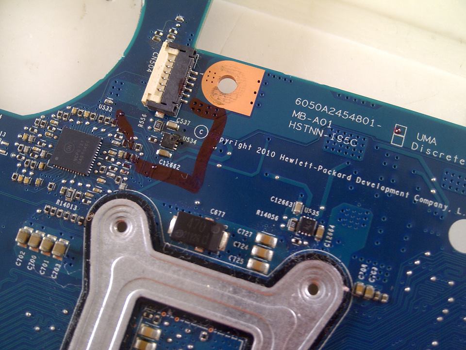

    hp 630 hp2000 CQ57 INTEL BOARD
    PLEASE WHO CAN SHARE EC BIOS (512Kbyteé)FOR THESE MODELS
    BOARD CODE: chicago hr hpc mv mb v1
    thanks

    Re: hp 630 hp2000 CQ57 INTEL BOARD
    FIND ONE HERE http://www.4shared.com/rar/xCeeZaMq/_hp_630.html
    BUT BOTH FILES ARE CORRUPT
            WITH THIS DUMP THE LAPTOP TURNS ON BUT THE PROCESSOR IS NOT SUPPLIED.
            use dump from a non-fonctional hp 2000 board and now all is ok .
            PS: with bad ec dump ,computer can turn on but can't display
                                      hi, i have this hp 630 with same mainboard as the one in the thread, but cant find second bios chip. one is winbond and mainboard code is u13 and should be the bios itself, but where is the ec bios ?
                                      pc power on but no display and caps blinking continuously. intel cpu core duo.
