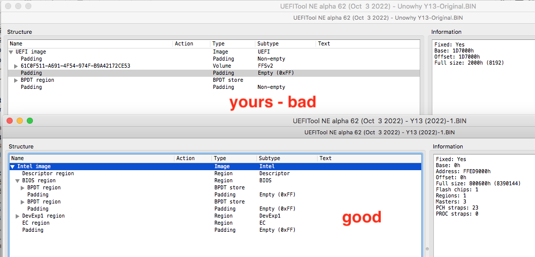

            Hi guys,
            Looking for a bios clean pwd for this machine :
            UNOWHY Y13 Model Y13G012S4EI, May 2022 ;
            Motheboard : EM_IG116_200B_ENE_TI_V1.0
            Chip : GigaDevice 25LB64CVIG
            Original bios :
            Thanks by advance,
            Have a good day.
            Daniel

            #46
            Thanks SMDFlea, sorry for the mistake.
            I always have a report error, with every .bin file i try to write. Write is ok, but verification failed. Like this :

            019: Chip verification error, start position: 0x400000.
            020: Verification failure£¬Elapsed time£º6.583 seconds¡£
            021: Status register1 values: 0x0, Status register2 values: 0x2 .
            022: Write error, operation terminated.​
            Any idea, please ?
            Maybe chip is bad...

              #47
Name:	Screen Shot 2024-06-19 at 20.51.59.png

              Yor bios dump is bad, you didn't read bios chipset properly. And you didn't provide serial no. as in RULES and SMDFlea asked.

                #48
                Click image for larger version  Name:	Screen Shot 2024-06-19 at 20.51.59.png Views:	3 Size:	94.0 KB ID:	3293431
                Thanks Volinakis, and sorry for that.

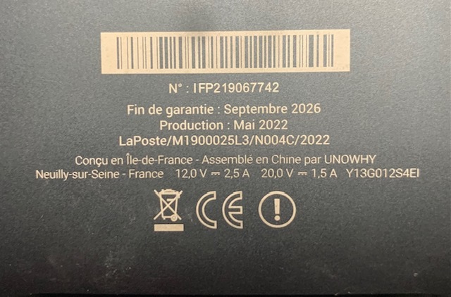

                Here the label on the computer.
                For the bad dump, sorry, but it's all i have, readed and saved with RT809F programmer.
                Now the chip is erased, what can i do ?
                Thanks.

                  #49
                  i need unlock unowhy Y13 2022 please
                  Production year : 2022 May
                  Model : Y13G012S4EI
                  Motherboard : EM_IG116_200b_ene_TI_V1.0
                  SERIAL : IFP219067742
                  Volinakus said my bios dump is bad, sorry i've nothing else...​
