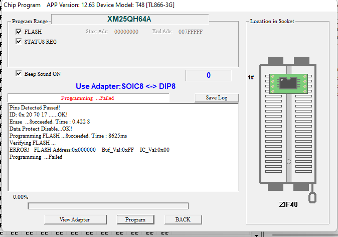

    Could I please have assitance with a cleaning of my original bios, theres plenty around for the model up but with a different revision that just gives me a black screen and fan spin.
    Have attached original bin file. thanks

            HI bro for some reason it just fails programmingthe chip Click image for larger version
Name:	Screenshot 2023-12-14 161825.png

                Only does it with this files, nothing else has the problem?, even ones on here for different revision programme fine

                      I just extracted the 8mb bin file from executable stock bios image and exactly the same issue.
                      I think it's an issue with the file they habe uploaded on the acer website for this particular model.I have tried 3 others and all went through the programming without trouble but the minute I try the linked file or the latest acer bios image it fails at the last Second.
                      Just thought I would share
