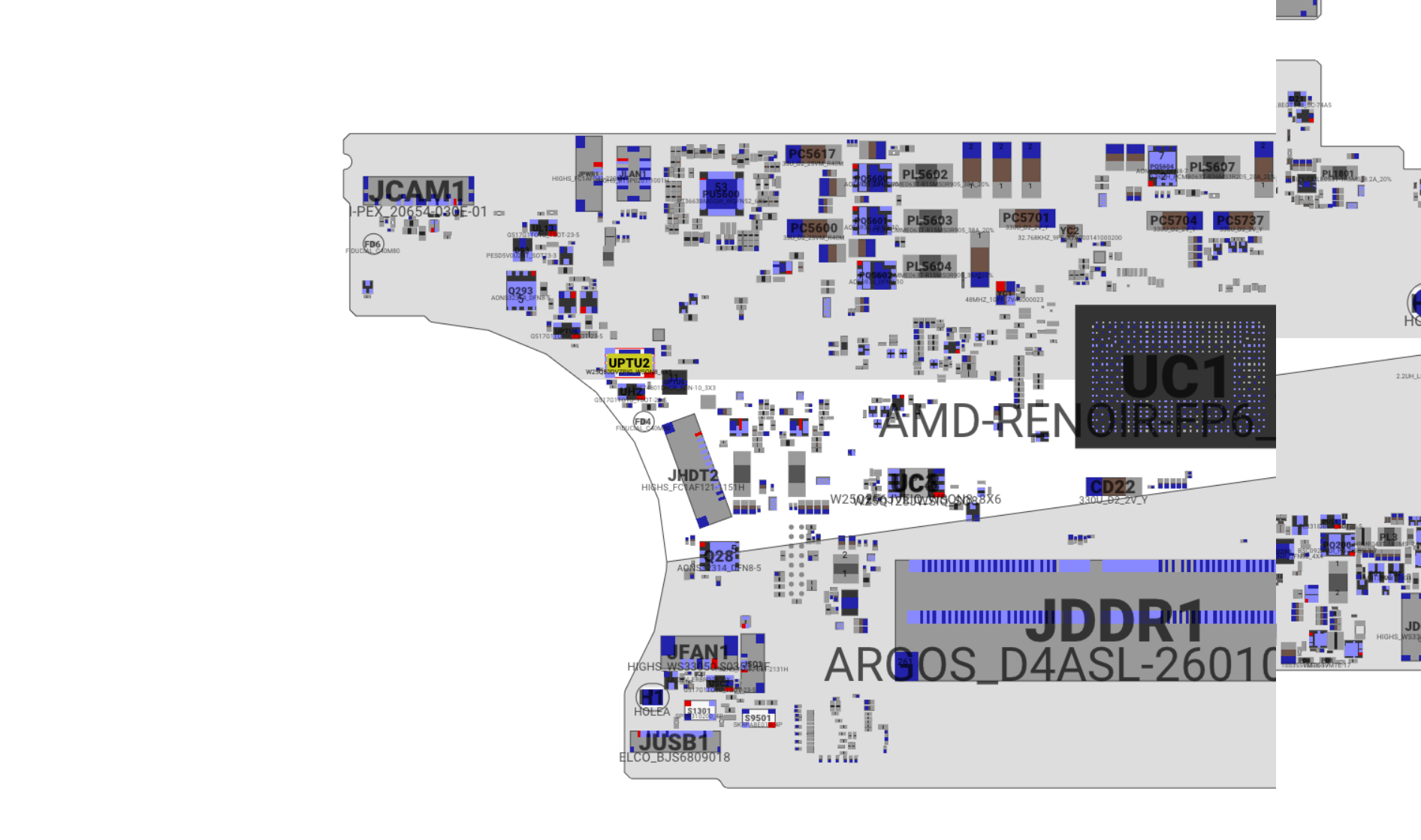

    Could you possibly make a backup of the eeprom marked UPTU2 in schematic to help one of our other members ?
    https://www.badcaps.net/forum/troubl...2-in-schematic
    • trepachka
      • Oct 2022
      • 439
      How do I do that? I only have CH341a.
      • trepachka
        • Oct 2022
        • 439
        SMDFlea, perhaps I can fix the bios first to confirm computer boots. Then, may be you can walk me thru how to extract eeprom (UPTU2) using basic tools. Can I still use CH341a for this job?
          What is the model labeld in the UPTU2?

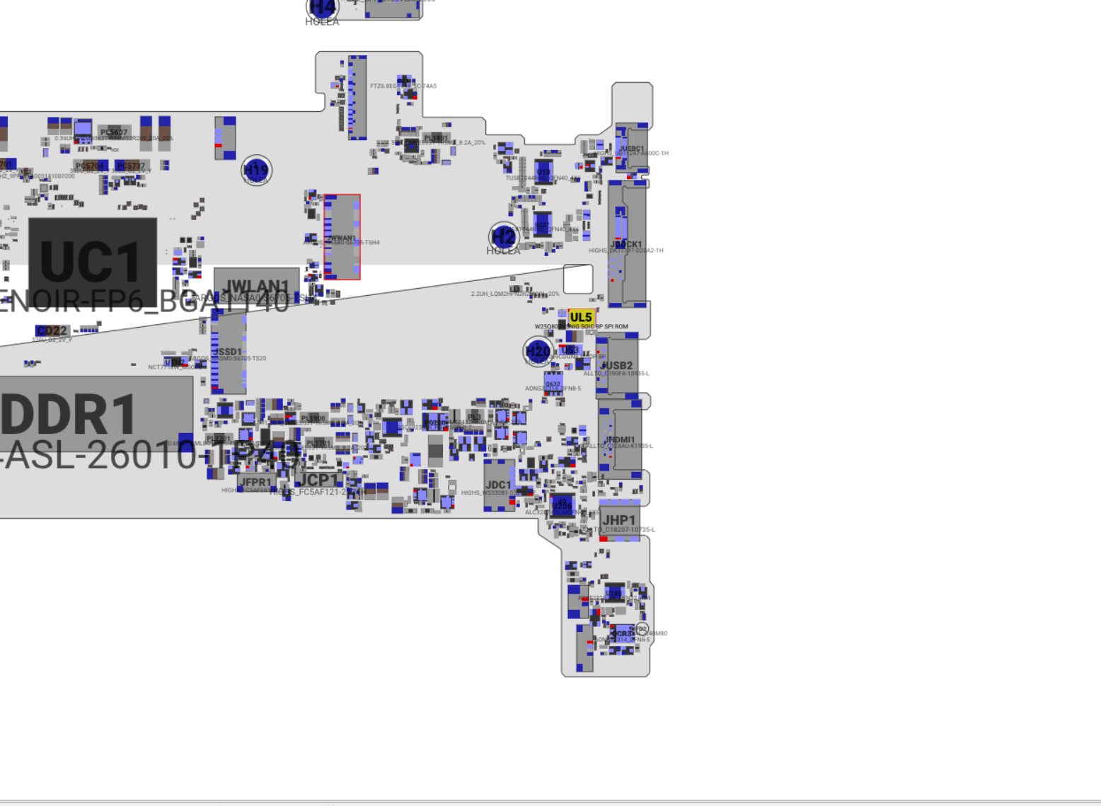

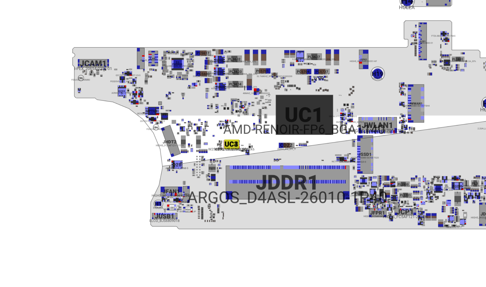

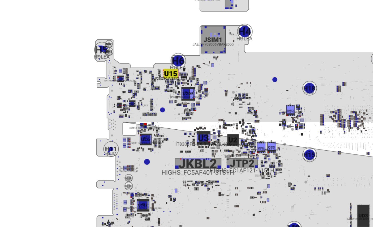

            I got T14 Gen1 with no image on LCD and HDMI after BIOS flash failed. Machine powered off during update procedure. Laptop reacts normal on power button, also CPU is heating and fan reacts normal. I tried multiple bios dumps, but looks like problem is somewhere else. Got another board that also failed on bios update and it acts same.
            Machine details are:
            Type: 20UE-S0VT01
            SN: PF-35YE3K
            Board model: NM-C801
            I need dumps of following eeproms so I can try this as last step..
            Motherbard marking / IC model / Package - IMAGE OF LOCATION PROVIDED
            UC3 / W25Q128JWSIQ / SOIC8 - 200mil - FILE ATTACHED
            U15 / W25Q80JVSSIQ / SOIC8 - 200mil
            UPTU2 / W25Q40CLSNIG / WSON8 6x5 (for some reason schematic shows W25Q80DVZPIG) - FILE ATTACHED
            UL5 / W25Q80DVSNIG / SOIC8 - 150mil
            U2 / IT5261-512-AX / VFBGA
            U3 / IT8300FN-CX-R / QFN48 6x6​

              Please help
              There is no sign of life when connecting charger to both of two USB-C ports on my Thinkpad T14 Gen 1 AMD but it still with battery connected. I think there is a U15 ROM chip in the back side of mother board incharge of PD Controller. I need dump of this U15 Eeproms to try.
              Type: 20UD-000HUS
              SN: PF-2E5SSE
              U15: WINBOND W25Q80
              Thanks a lot​

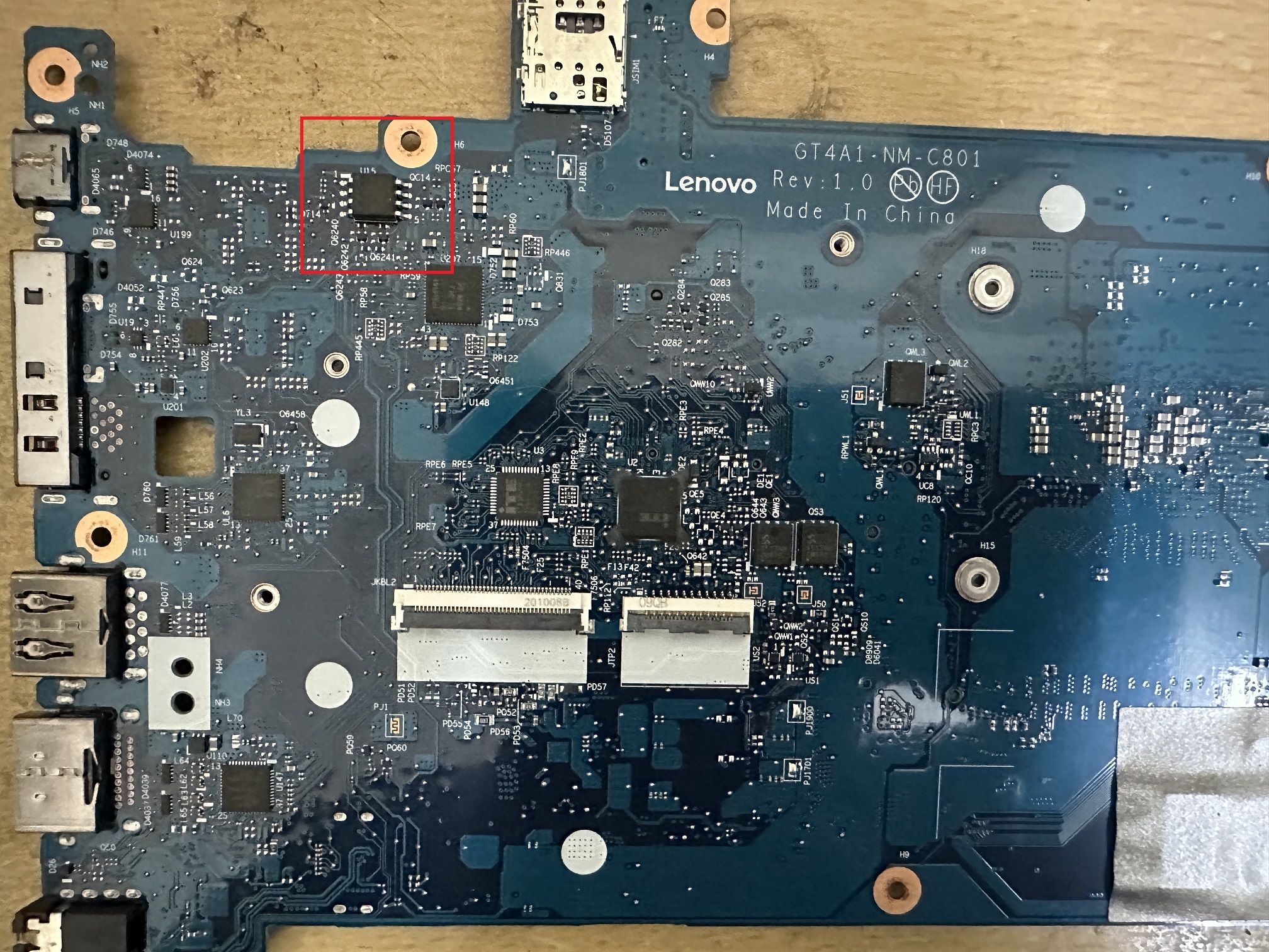

                Hello members
                Need urgently Embedded Controller clean dump for Lenovo thinkpad T14 gen 1 Amd Ryzen Pro
                MB : GT 4A1-NM-C801 to help remove supervisor password.
                Many thanks

                        • kamel
                          • May 2011
                          • 128
                          • TUNISIA
                          Originally posted by SMDFlea
                          Can you post your EC backup
                          Couldn't backup EC, have to solve this issue :
                          I have micro_Vision programmer Rev: 4.1 with connectors supporting Max 32 pins, whereas T14 keyboard connector has 40 pins. I tried to read the IT5261VG-512 EC with a 32 pin cable 0.5mm but always got error reading message "ITE do not respond check connection and settings MB powered ? (02)", though all pins to read are within the 24 1st pins (so connected to programmer) ?
                          Any suggestion should be well apreciated.

                              • kamel
                                • May 2011
                                • 128
                                • TUNISIA
                                This programmer https://www.aliexpress.com/i/1005004829637690.html ,it looks like a vertyanov clone
                                First, thanks for the photos.
                                Yes indeed, also vertyanov programming software is compatible with MIC-VISION JIG V3.
                                I did connect the programmer and MB the same way as in the photos and got error "Ite do not respond". But i have to correct, I rather 1st used the 30 pin 0.5mm cable supplied with programmer. Today I solved the issue once I used the 32 pin 0.5mm cable instead (which was supplied with my old svod1 ver2 programmer). So I saved the EC .bin file with password which I attach.
                                Is their a way to remove the password from the .bin file ? please share. Thanks
