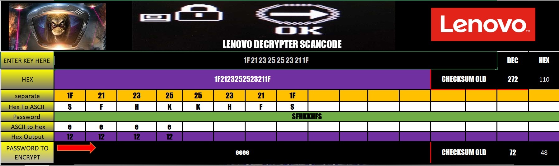

          Originally posted by abdou_eps
          any one ?
          Try Password: sfhkkhfs
          is same here https://www.badcaps.net/forum/troubl...49#post1810849

          • HSBunlock
            • Mar 2021
            • 30
            • UK + PAK
            Hello Dears! Can anyone help me unlock the BIOS PASSWORD for Lenovo Ideapad duet 3 10igl5
            I tried with a new bios but it didn't work
            I need the Bios Password
            This is My Backup
            S/N: YX02EQP6
            Thanks​
                  This is My Backup
                  S/N: YX02EQP6
                  very possible that password is: OCTOPUS14 or octopus14
                  • HSBunlock
                    • Mar 2021
                    • 30
                    • UK + PAK
                    dear! its working,
                    👍👍👍👍👍👍👍👍 THANKSSSS 👍👍👍👍👍👍👍👍👍👍
                          if you don't mind can i ask you , how to read the password from bios?
                          in this case I used keyboard scancodes. encoded password was 09 18 2E 14 18 19 16 1F 02 05 30 meaning it has 9 characters (09) so pass was 18 2E 14 18 19 16 1F 02 05 and translating this to keyboard scancodes it gives OCTOPUS14
                          • HSBunlock
                            • Mar 2021
                            • 30
                            • UK + PAK
                            in HEX Editior file these characters (18 2E 14 18 19 16 1F 02 05)?
                              18 hex = 24 dec
                              https://www.millisecond.com/support/.../scancodes.htm
                              • volinakis
                                • Jan 2021
                                • 2809
                                • N/A
                                yep, I "stole" it from you, saw a pic with your calculator in excel file
