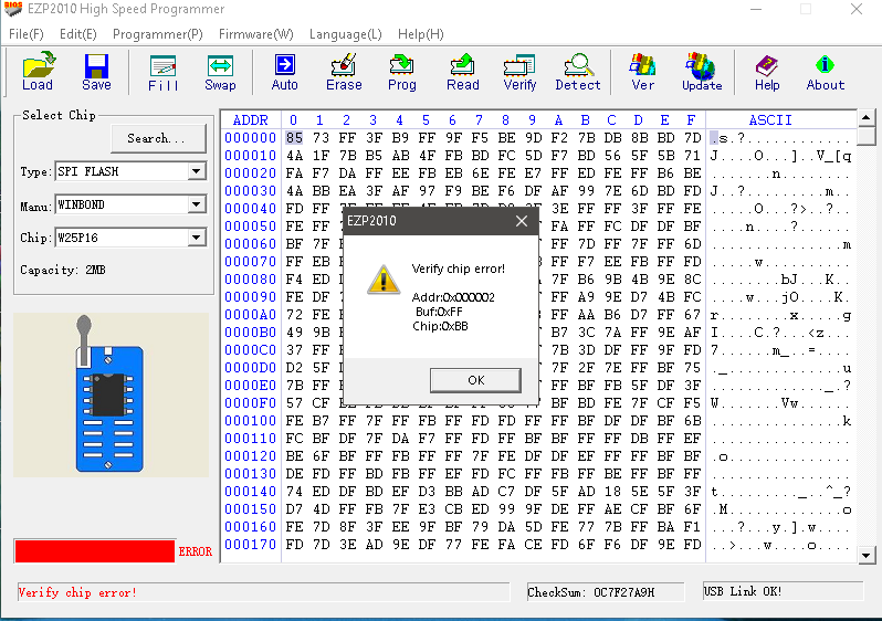

          I think something is wrong with my bios chip. When I try to erase it, I'm still getting content when reading the chip.
          Also, when I use the verify button of the programmer, I'm getting an error.
          A picture is attached to the post as a prove.

            Picture shows a W25P16 chip.What is the part number etched on top of the chip. You can choose it manually,auto-detect doesn`t always work

              The bios model is: winbond 25x16avsig.
              In any case, I got another bios from an old motherboard with 2mo of size that I programmed using the dump provided by volinakis and the laptop started up again.
              It's not my laptop so I would return it to its owner in the same initial conditions to avoid problems.
