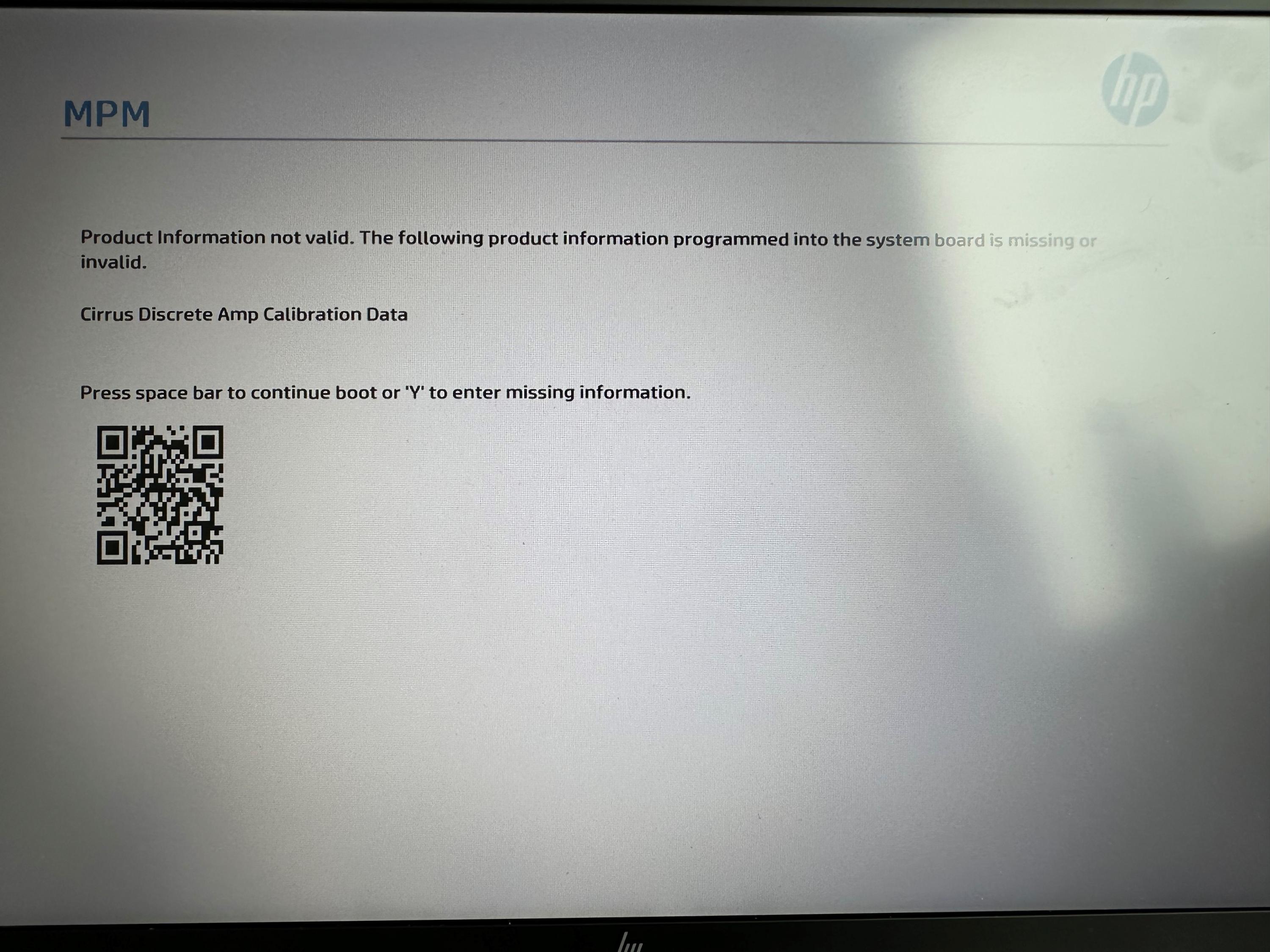

    I have a HP EliteBook 840 G9 and I have 2 issues :
    - first one : in red at start system is booting in manufacturing program mode but I filled every ID in BIOS
    - second one : on screenshot https://*******/qW2hVxX
    The HP tech has replaced a new motherboard but now, I have these problems ..
    Can you help me please, if you need more informations I'm here

    Re: HP EliteBook 840 G9 - error MPM
    - second one : on screenshot https://ibb.co/qW2hVxX
    post serial number
      You need read data for old bios and add to
        post serial number
        Here it is : 5CG244116W

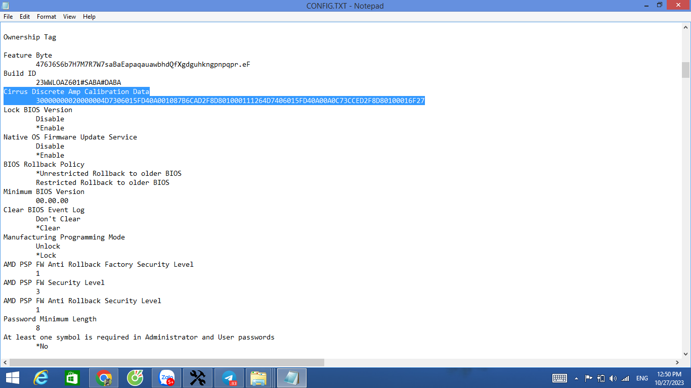

          according to partsurfer here are your DMI:
          Serial Number : 5CG244116W
          Product Number (SKU): 6T131EA
          Name : HP EliteBook 840 G9
          BuildID: 22WWWPAT602#SABF#DABF
          featureByte:
          Code:
          476J6S6b7B7H7M7Q7W7m7saBaEapaqauawbUbhcAdpdqfAfPguhKhkjhk8mEmwn7nVngpTpqqjqz.4G
          check in Set Unique Machine Data tab if you have ALL DMI as above and error should go away. Can't find BoardID but it should be on sticker of motherboard (14 characters).
          if doesn't work check this thread:
          https://www.badcaps.net/forum/showthread.php?t=116748
          if pressing Y allows you to enter manually data, write:
          Code:
          3000000002000000000000000000000093DD20DCA8E4D80117013412000000000000000093DD20DCA8E4D80117013412
          after error goes away restart laptop how many times MPM counter shows to exit MPM.
            Thank you, I did it with BCU and now it works !!!
