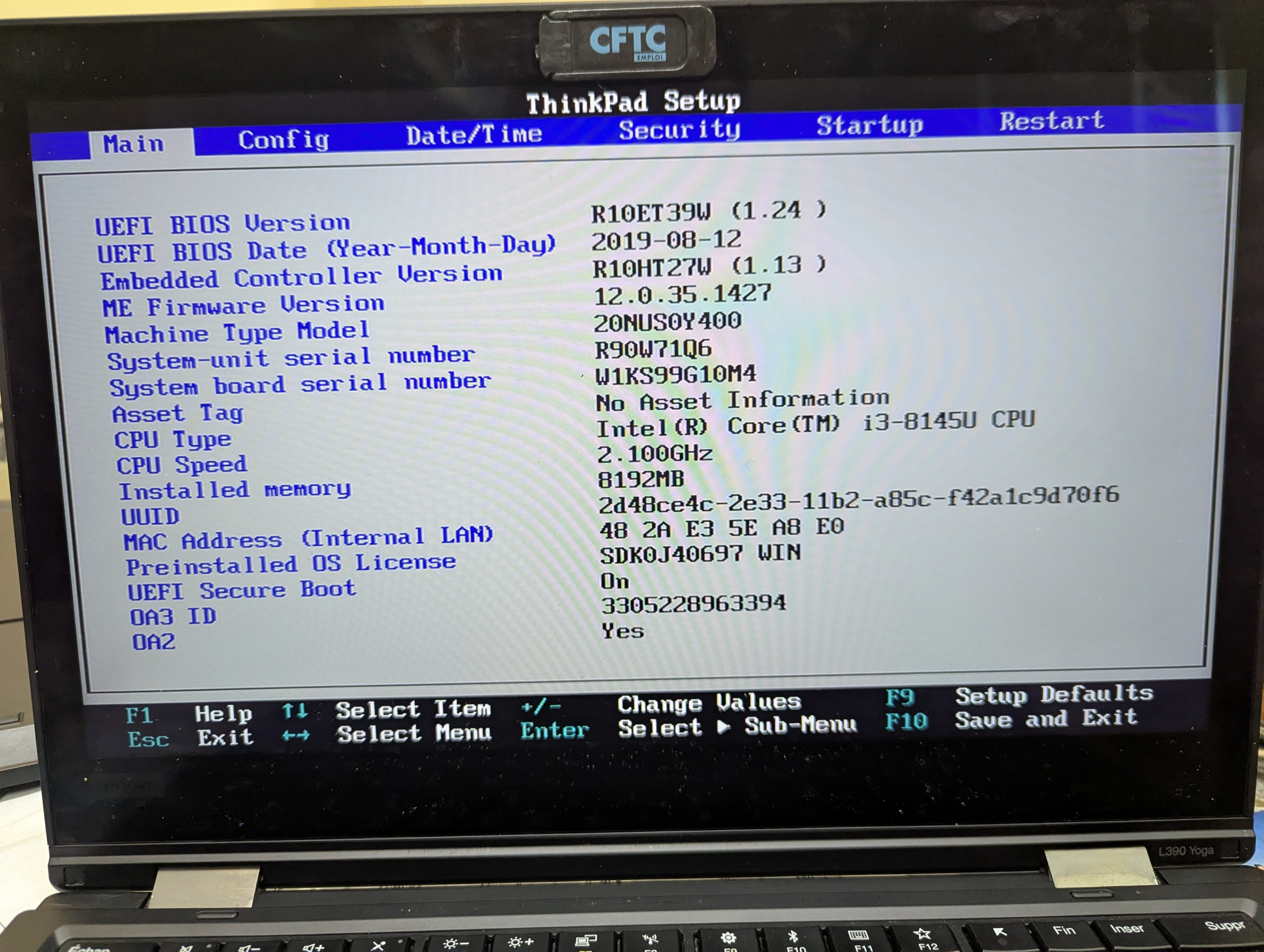

                    hi ,
                    please it is possible to unlock lenovo yoga l390 bios version 1.24?
                    i can read both bios 1 (25Q128JVSQ) and bios 2 (25Q80DVNIG) with eeprom reader. thanks
                    • Stefan Steff
                      • Mar 2024
                      • 414
                      • Romania
                      Why do you post your request in two threads?
                      Read the 25q128 and use the tool from page 1 in this thread : https://www.badcaps.net/forum/troubl...ssword-removal .
                      Read carefully how to use it.
                      Your i3-8145U is supported by the tool.
                      Good luck!

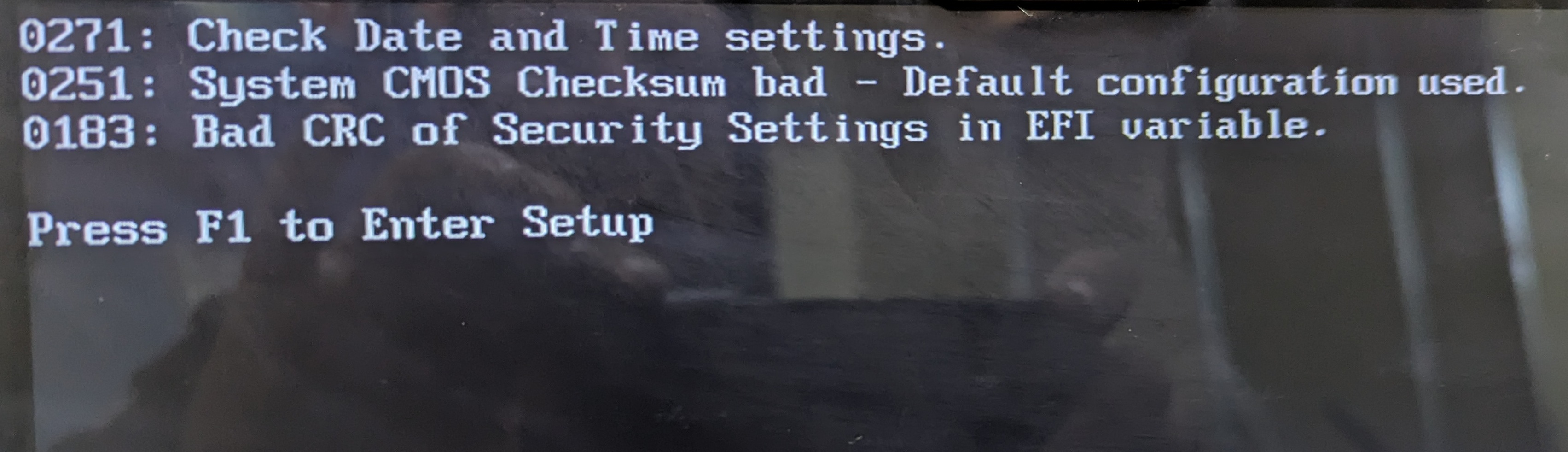

                        i tried ,after flashing the patched bios ,i hear only sort of beeps ,no display .,
                        the log from ptcher : Using UEFIReplace to inject 2 DXE drivers...
                        [1/2] BootOption (GUID e0746c42-d3f9-4f8b-b211-1410957b9ff5)
                        [2/2] LenovoTranslateService (GUID 826bcf56-bac4-43f4-8ea1-8cdf0a121abd)
                        Looking for volumes to patch...
                        [1/1] NVRAM_EfiSystemNvDataFvGuid (checksum 2609h):
                        Not found... Skipping.
                        Done.
                        PATCH FILE: original_PATCHED.bin
                        Good luck.​
