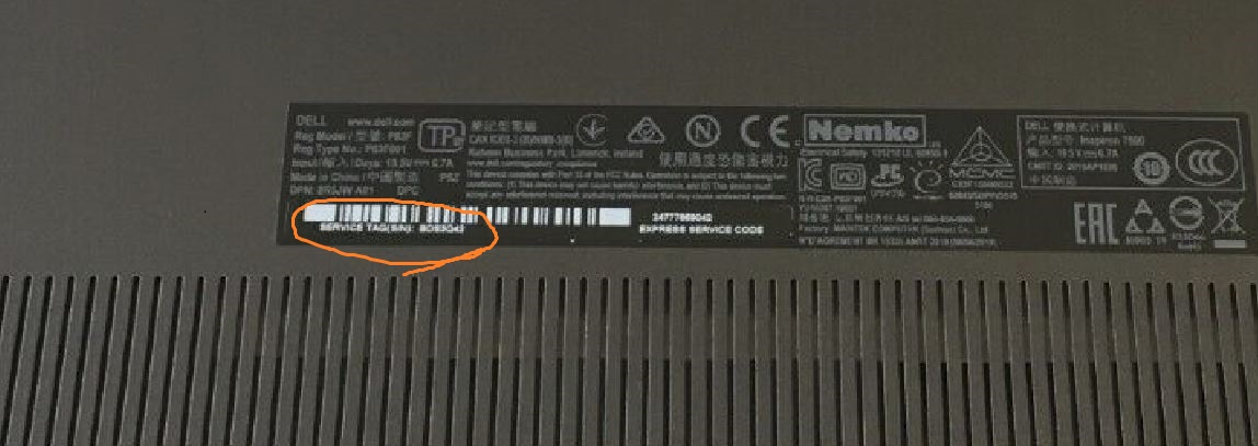

        The service tag is a 7 digit number on the base cover

          Ok, sorry, I'll post it tomorrow morning
