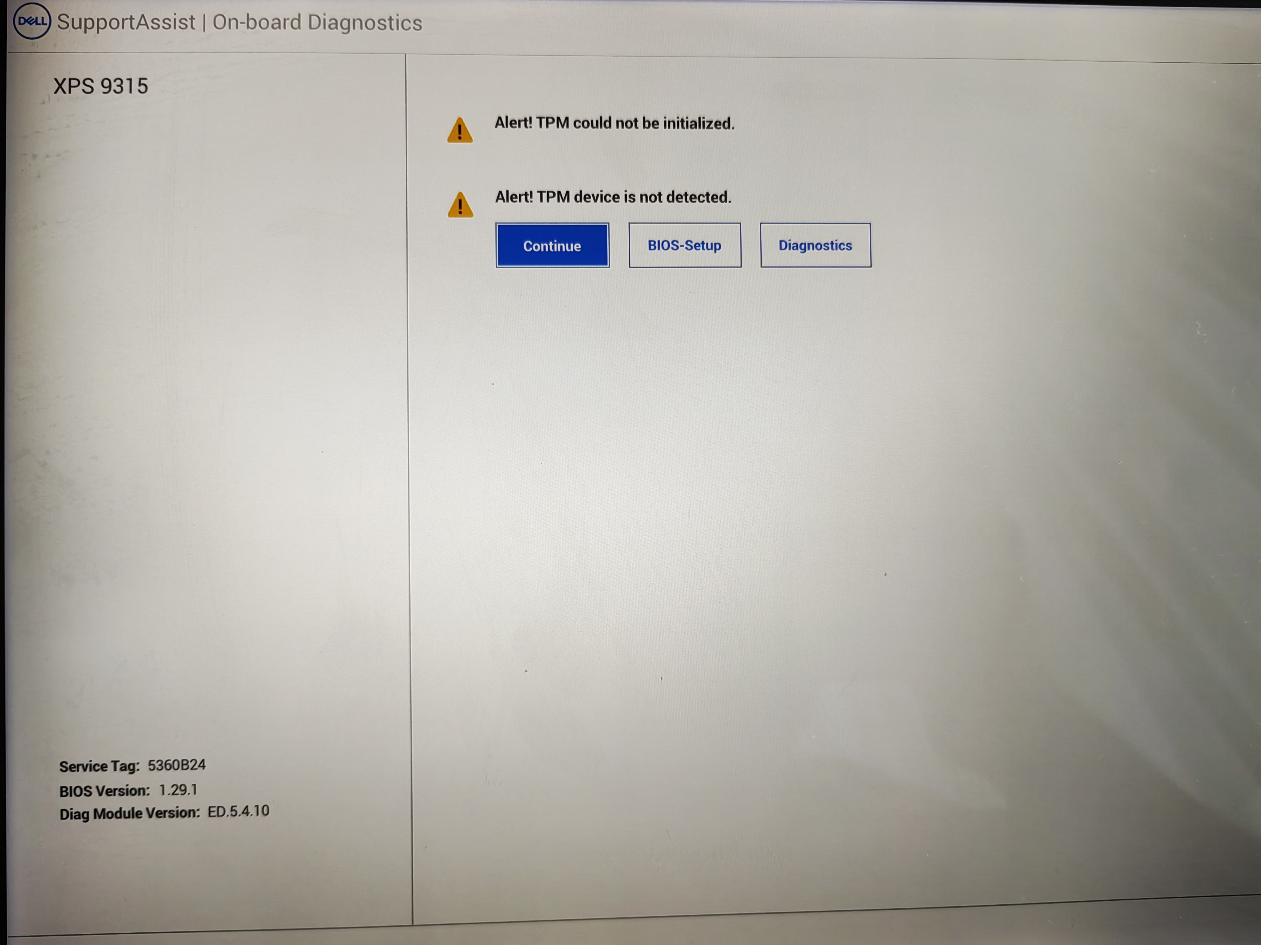

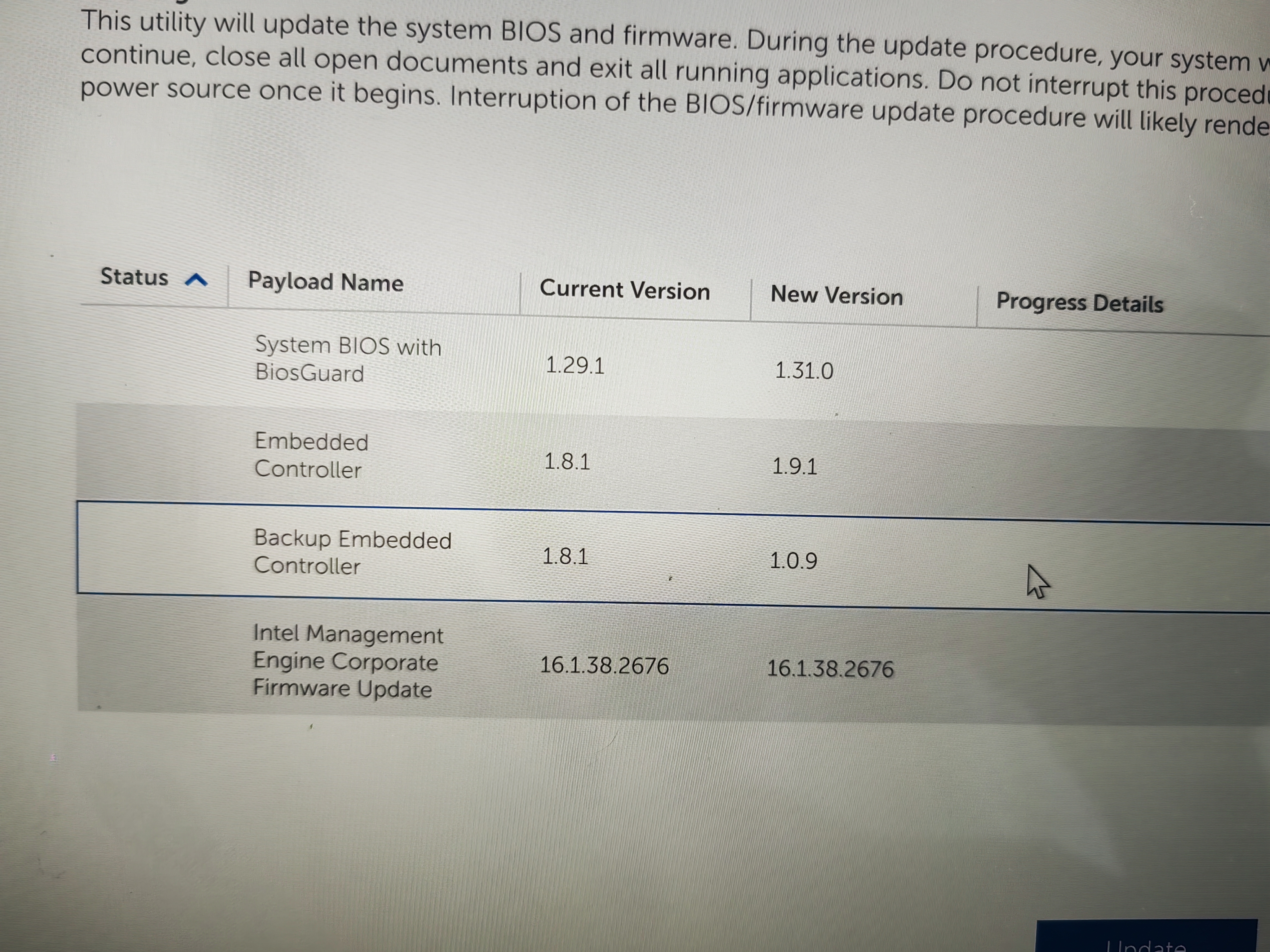

                            Hi everyone,
                            I’m dealing with a firmware issue on a Dell XPS 9315. After PopOS build in firmware update tool found and install the BIOS v1.29.1, the laptop started showing TPM errors on boot:
                            • Alert! TPM could not be initialized.
                            • Alert! TPM device is not detected.
                            Since then, the TPM is completely missing in BIOS and in the OS.
                            Here’s what I tried so far:
                            • Downgrade is blocked because BIOS 1.29.1 is marked as “critical.”
                            • Reflashing the same version does not help.
                            • Left the laptop without battery for a week – no effect.
                            • Updated to BIOS 1.31.0 – problem persists.
                            • Dell support is useless – they only suggest paid motherboard replacement, even though the bug was clearly caused by their own BIOS update.
                            From the motherboard diagram, the TPM chip seems directly connected to the BIOS chip and loads its firmware from there. My suspicion is that the TPM firmware region in the BIOS got corrupted during the update.
                            I dumped my current BIOS and also tried patching it with 8FC8, but no luck. I’m attaching my BIOS dump here in case someone with more experience can take a look and maybe correct the corrupted region.
                            Laptop service tag is: 5360B24
                            Any help would be greatly appreciated.
                            Thanks!

                            #54
                            Originally posted by mariusmotea
                            Hi everyone,
                            Thanks!
                            XPS 13 9315

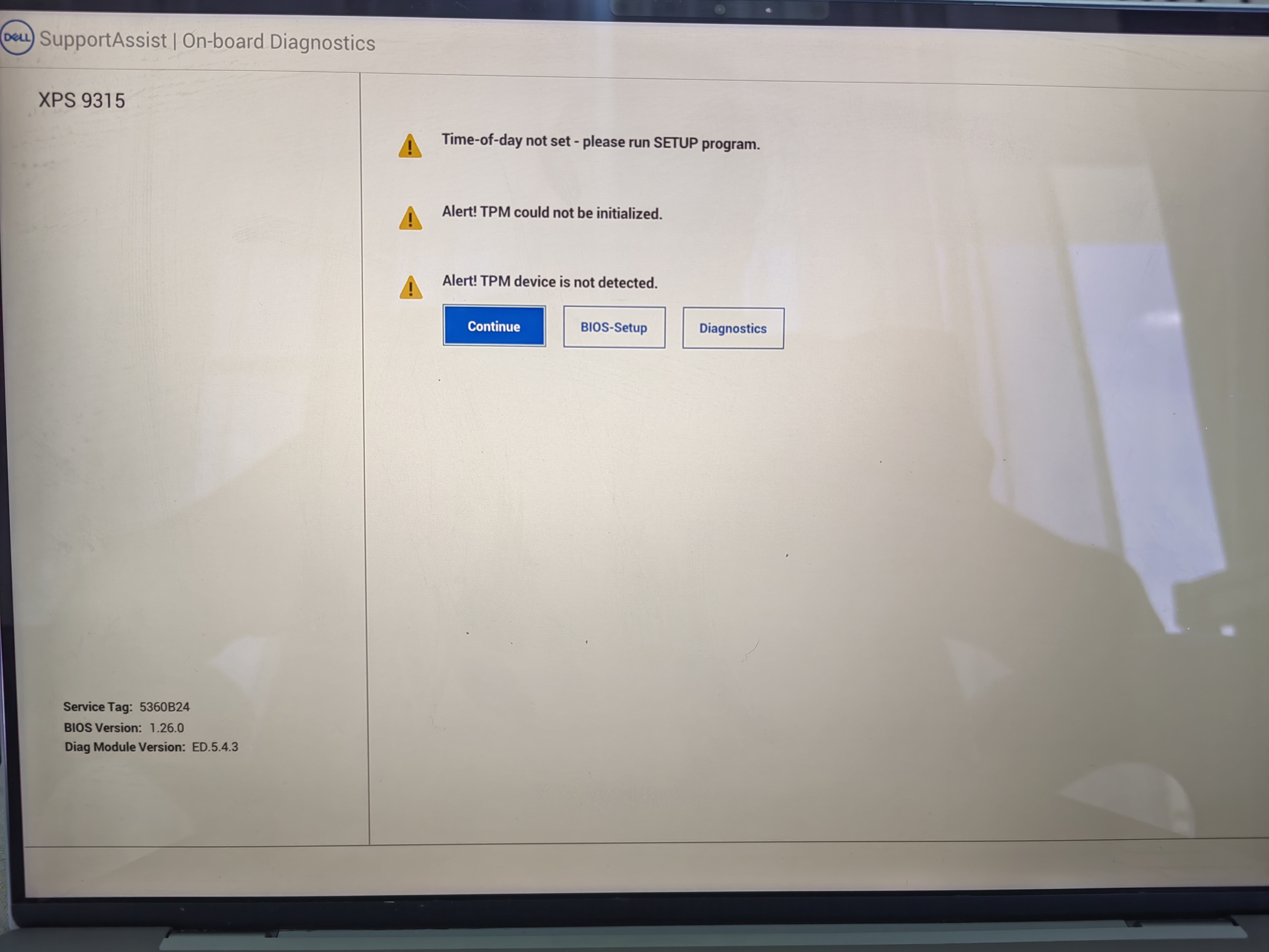

                              #55
                              Thanks for your work, unfortunatelly the downgrade to bios version 1.26.0 did not fix the issue. Now i run windows and on the first reboot the Windows installed bios v1.29.1 also with no difference. I notice something strange with the bios setup GUI for v1.31.0 in windows, Backup Embedded Controller has the current version 1.8.1 and the installer version is 1.0.9. Maybe the linux firmware utility installed a bios that was made for this platform but not exactly this motherboard?
                              Thanks!

                                • mariusmotea
                                  • Jul 2011
                                  • 7
                                  #57
                                  Originally posted by SMDFlea
                                  try
                                  Thanks.
                                  This one did not boot, it don't negociate 19V on USB-C ports.
