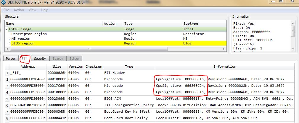

    If there is no platform.ini you can get get your Intel CPU ID,open each bios with UEFITool,look at the microcode
    and search for each one on google to find out what microcode is for which CPU.

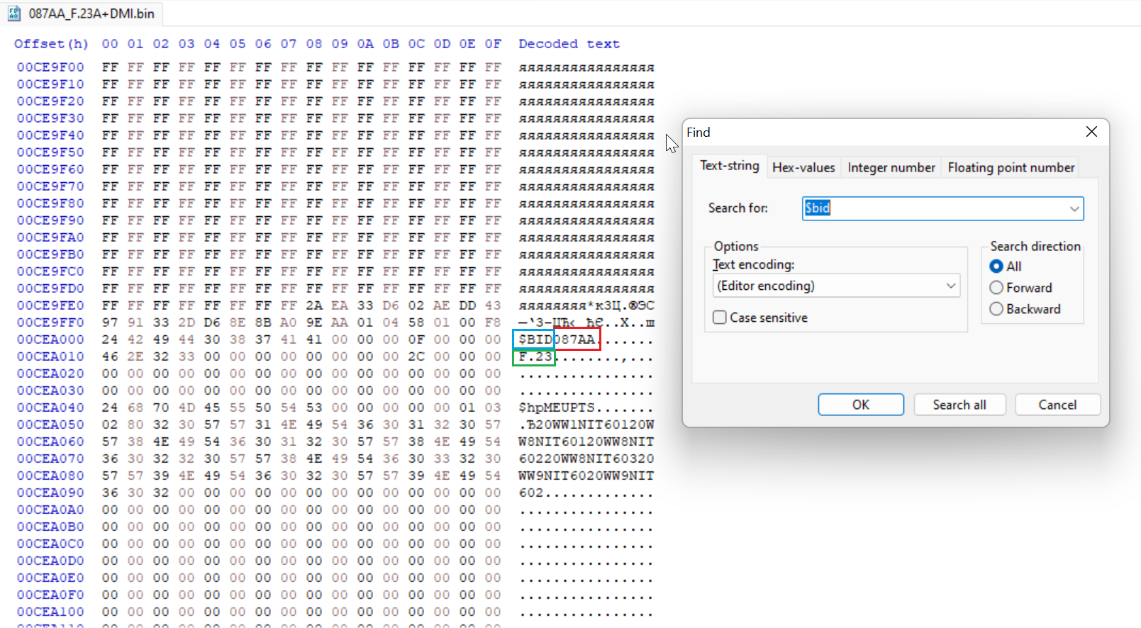

    Re: [Guide] How to find the right HP bios version to flash
    Finding which of the extracted files you need to use for programming
    Quick version Guide.

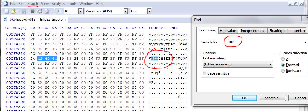

    Find BID number (Bios ID - not to be mistaken by Build ID also written as BID and printed at the factory label along with the Serial number, FeatureByte and other manufacturing info - the example is shown at the third image below in the end of the post) in your bios backup using a hex editor searching for $BID:
    In this case BID number is 087AA, and the bios version is F.23
    Bios version can also be found by searching for $BVDT:
    Example of Build ID written as BID and printed at the factory label:

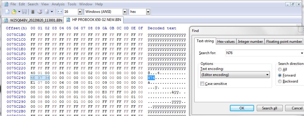

            in probook how you define version of bios ?

                      in ProBook as reference image is used shows N76 in this how can we know its (1.1.0 version or 1.2.0 version ) any idea on this ?
