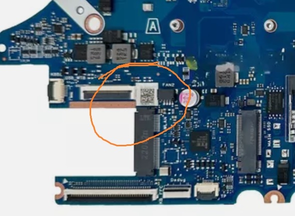

      If you can see a QR code on the motherboard scan it and post what it says or take a picture of it.

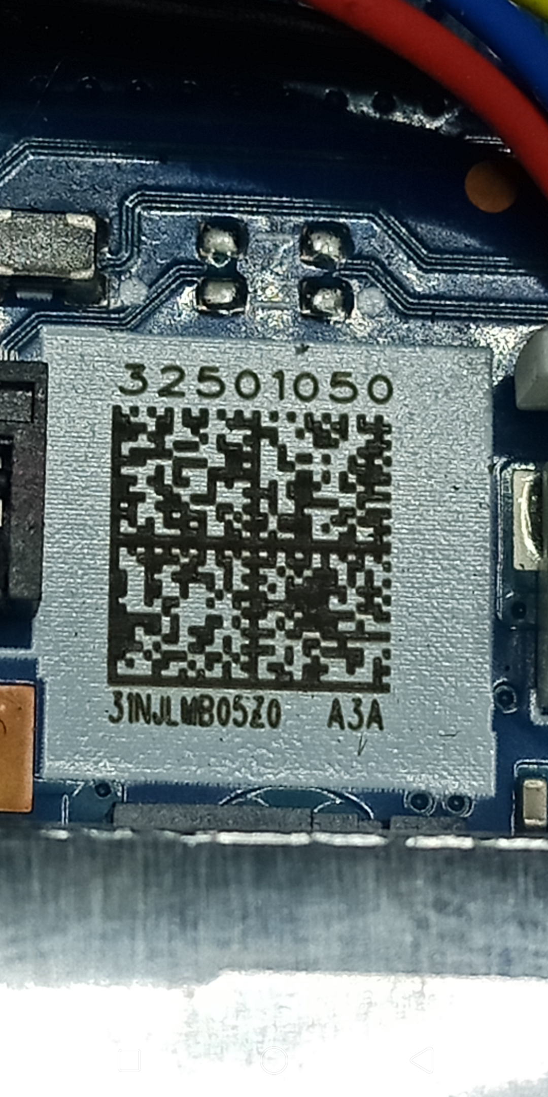

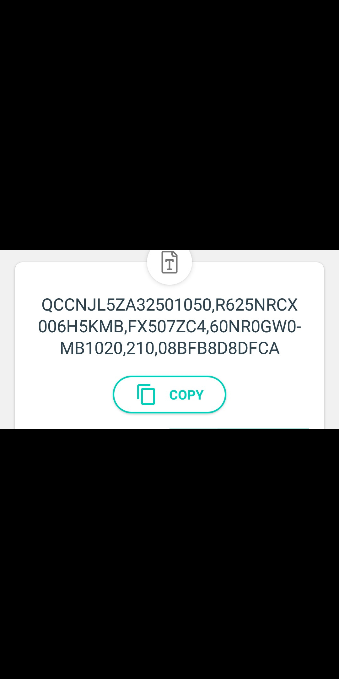

        #63
        here is the picture and the QR code picture.

            Attached is your FZ507ZC4 bios (as in the QR code) , with your DMI. The bios is from the post above https://www.badcaps.net/forum/troubl...02#post3683602 ,it`s an F1 Asus Service bios.
            DMI offsets for anyone else who can use a hex editor - 10C1000 - 10C8FFF

                              #75
                              thank you so much! The laptop is now working well.
