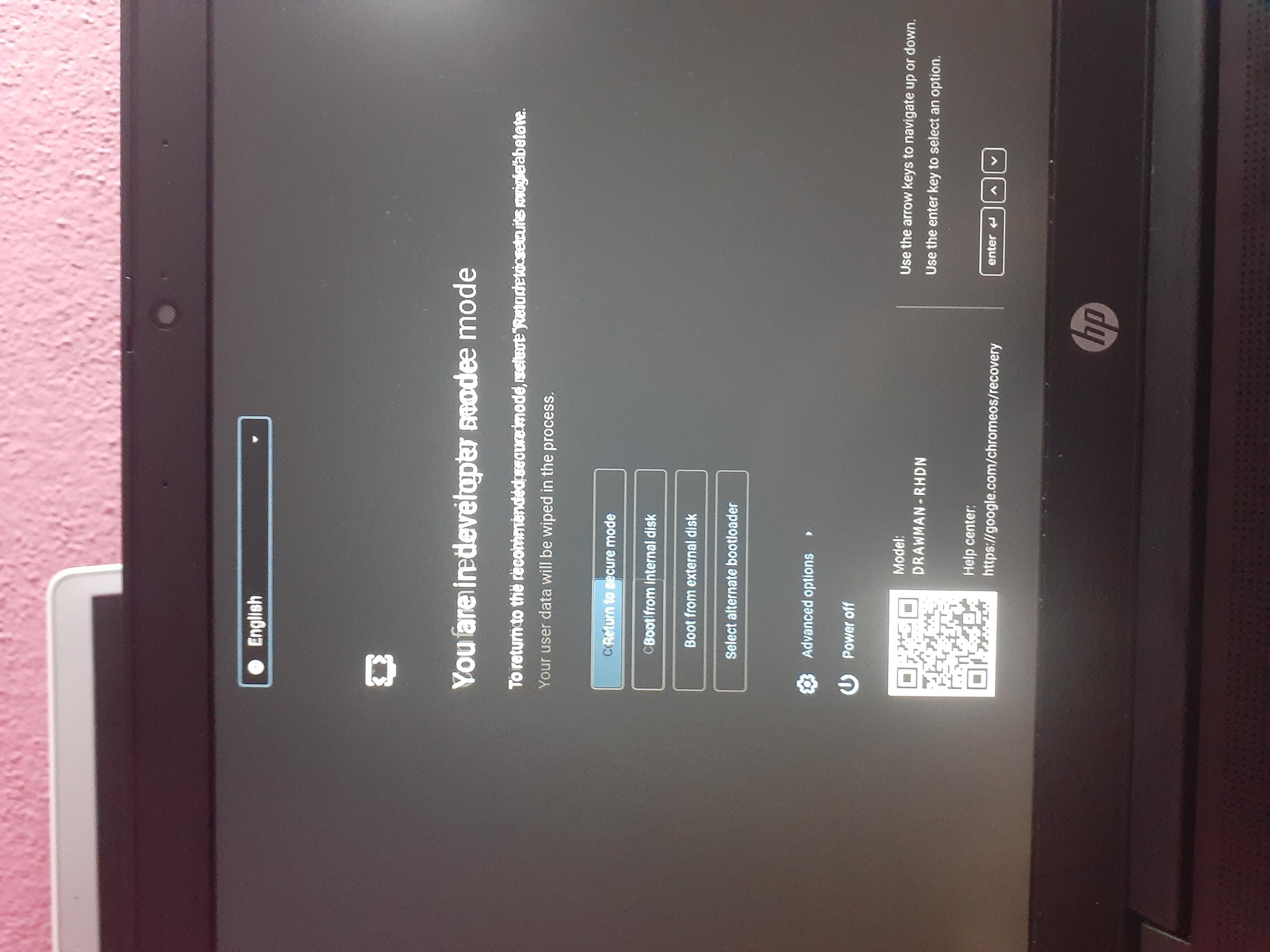

    can someone help me with this particular problem?
    this is the ORIGINAL bin file of my chromebook 14 G7
    with dev mode blocked and enterprise enrolment on!
    can someone help me with this! bypass admin restriction?

        i have tried this technique nothing happens maybe. i miss something !!!
        always devmode blocked after 5 attempt the laptop turn off
        sometime keep showing that h is in dev mode but no general access to all option.

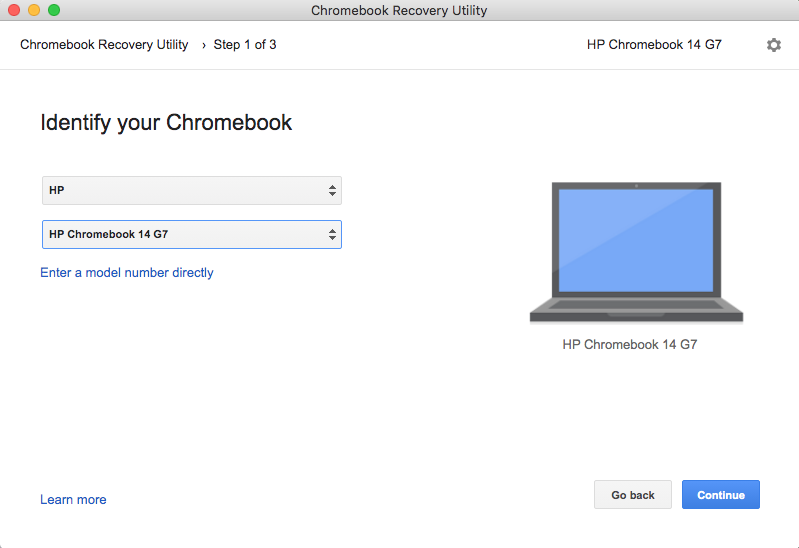

          try this bios then REINSTALL using USB stick made with Chromebook Recovery Utility for your model.

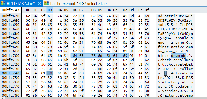

                    It's done with rcunlocker

                      with RCUnlocker was made Rex's file ...
                      with my file it should work, done several G7s ...
