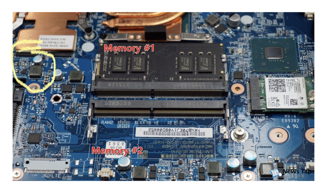

    Hallo every body
    I have a not booting Terra mobile 1776p and its not booting both fan turning fast and orange led blinking i think its a bios corrupted i have the bios file and want to use programmer witch eprom or where its located thanks

    Post the silkscreened motherboard part number,a schematic might be available to look at to help find the location.
    Its probably a clevo motherboard https://www.badcaps.net/forum/showthread.php?t=88758
    Beginner's guidelines
    1.1.3 Motherboard model number
    Clevo: they manufacture laptops for a lot of "small local" brands. There are often 2 model numbers on the board, like "6-71-W25S0-D02" and "W251ESMB-D0"

        Thank you sorry i was in vacation when i looked well i saw that 2 small smc components as condo were damaged and burned may be its the root cause i will post a picture later when home back
        But electrically i think not a cause as the computer answer and start with green led at first just the ventilator spining and orange led blinking slower than faster than stop
        I found this mother board from gigabyte sabre 17
        But the picture has not well definition to zoom and see the smsll lines how the 2 component are connected to create the same connection
        I couldn't upload picture
