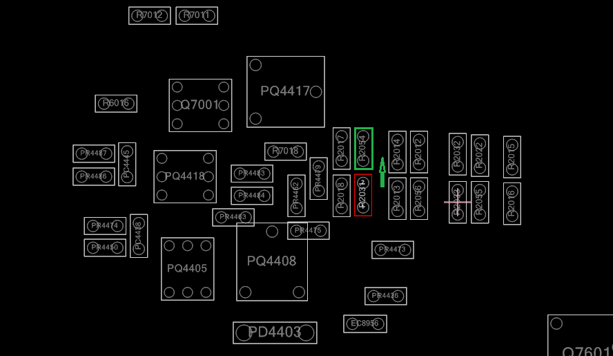

    I have a Dell Vostro 5490 that is giving me an LED code indicating "Invalid memory installed."
    The basic voltages are present.
    I want to disable the internal RAM modules. Is it possible to disable them from the BIOS?
    Ram Chip Part Numper: D9WFR --- PartNuber(MT40A1G16KNR-075:E)

    change only this bios..

      Thank you for your help, my friend. It didn't work. It draws 300 milliamps only for a moment after pressing the power button, and then it doesn't draw any current until the button is pressed again

        to disable internal RAM change r2031 to r2054 on other side of cpu
