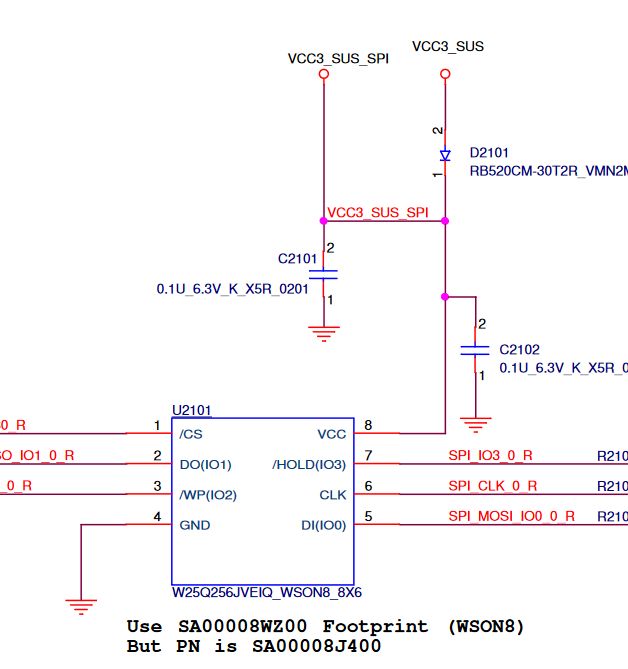

                        • huzo
                          • Sep 2014
                          • 190
                          • CROATIA
                          Re: Lenovo T590 bios
                          i found something odd in the schematics...
                          on VCC, pin 8, there is a diode ,before diode there is 3.3V,after diode 1.5V on the VCC pin, so the diode is bad, i shorted it and now i get the 3.3V on VCC, but symptoms are the same, it still doesn't work...could the chip itself be damaged?Because the erasure and blank check and programming and verify goes all ok...i got the error first time i deleted the chip something about the erasure control and registry bits....i forgot what it was, i just pressed ok...

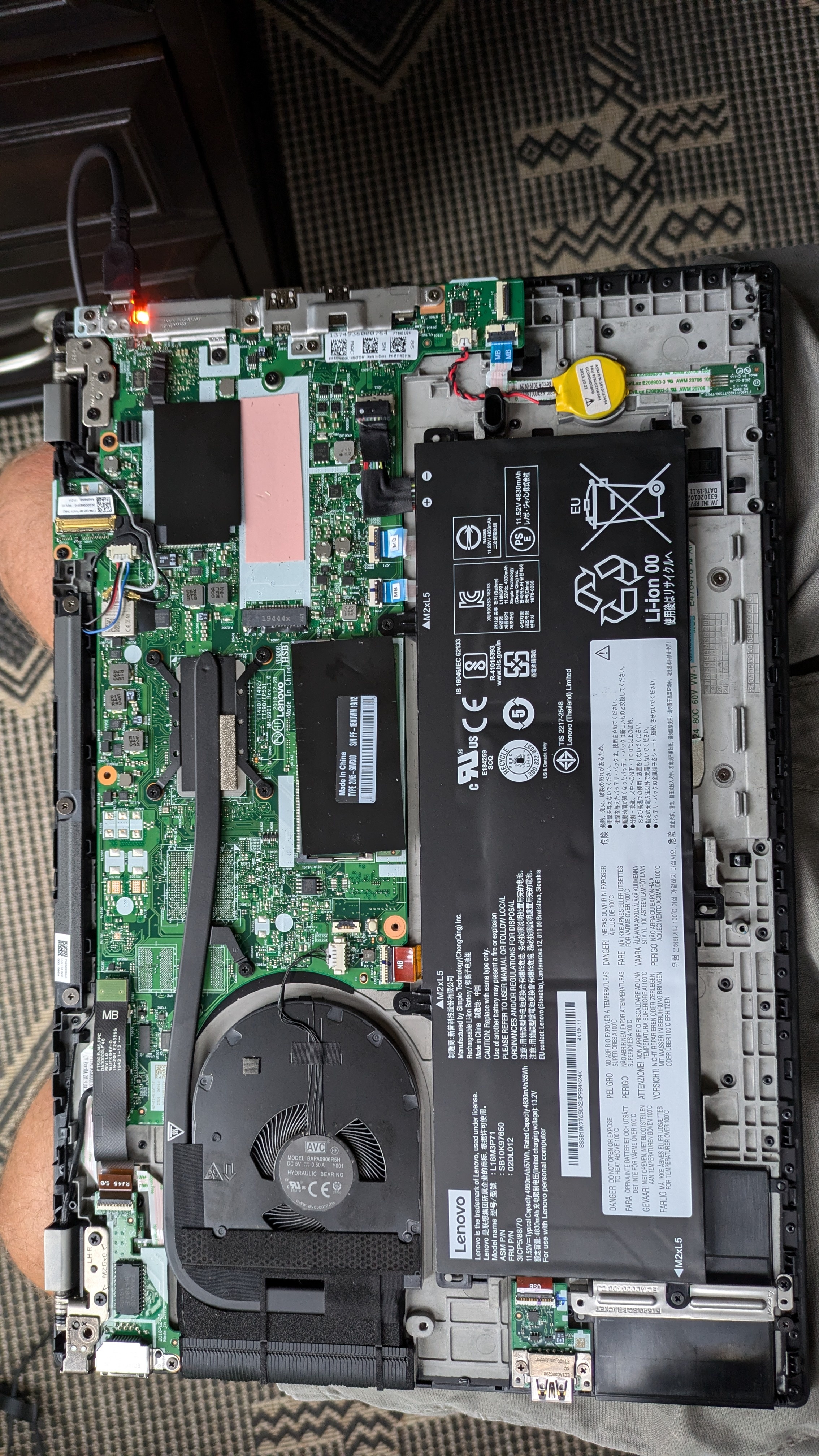

                              Lenovo T590
                              Model 20N5S0W300
                              SN PF1BXUWM
                              Mobo FP531
                              In attempting to bypass the BIOS password, I misinterpreted the instructions as referring to CPU gen instead of Thinkpad gen. As a result of my error, I followed the DXE password bypass driver injection instructions and flashed a new BIOS created by the Lenovo Autopatcher python script. When attempting to boot the patched BIOS, I heard continuous beeps but couldn't enter the BIOS menu. FWIW, I couldn't find any material on the web about an anti-tamper switch. I flashed the original BIOS back to the chip, at which point the laptop showed no signs of life other than an orange light on the underside indicating power (indicating a problem perhaps). I've done multiple reads of the BIOS chip and confirmed using an MD5 checksum that it matches what was originally on the chip. This doesn't appear to be a problem with corrupted BIOS I believe.
                              I would like to get the laptop back to a working state so I can execute the Flashing EC procedure mentioned in the sticky post.
                              What are the recommended steps to recover?​

                                  • jeffl1980
                                    • Aug 2024
                                    • 12
                                    Thank you, hoaca388.
                                    I switched to Neoprogrammer. Now I can consistently read the BIOS image that I write. In other words, the md5 checksum of the image I write to the IC matches the md5 checksum of what I read back from the IC. This is progress as I couldn't do this previously. I wrote my original BIOS and the BIOS that hoaca338 provided. I removed the battery, external power, and CMOS battery for 30 seconds. I pushed the button to disconnect the battery (even though this is probably not needed). The behavior is the same: the laptop shows no sign of life. The LED near the power connect glows orange as shown in the pic below.
                                    What else can I try to restore this laptop?
