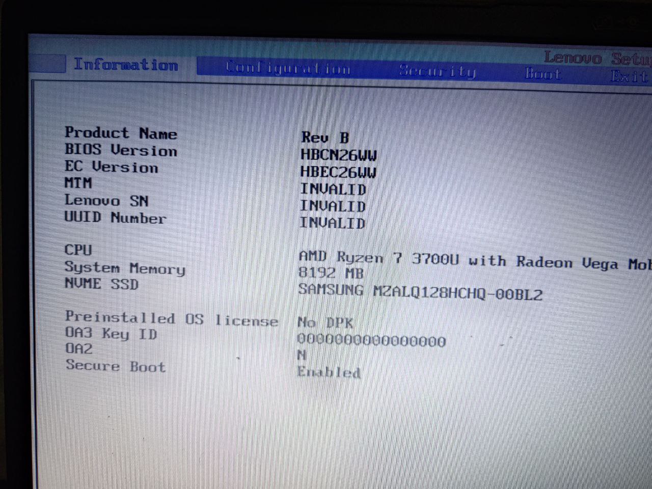

        Thank you very much for your help , everything is working just fine , the only problem is when i go to the bios is says:
        MTM Invalid
        Lenovo SN invalid
        UUID Number Invalid
        I have attached a picture.

          Re: BIOS bin file for Lenovo Ideapad 3 17ADA6
          MTM Invalid
          Lenovo SN invalid
          UUID Number Invalid
          Read again post #2:
          Originally posted by peste
          DMI 1000 - 2FFF
          DMI block must be transferred from your bios backup to the new factory file using the above block addresses.
