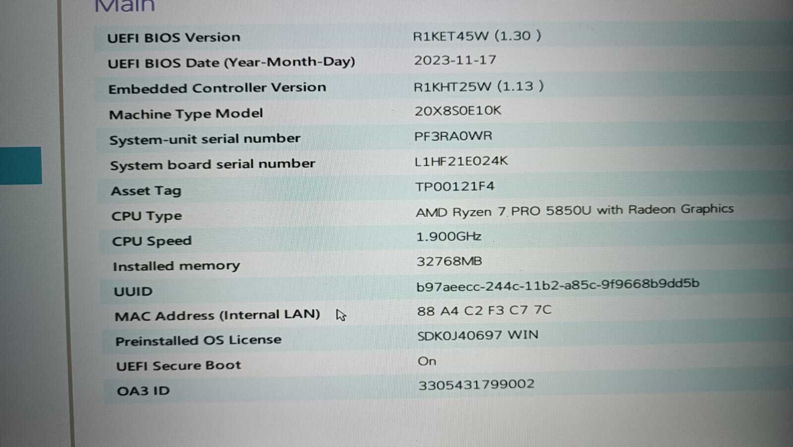

          thanks maxpower3 , it only still one msg . no i dont have the original cause i did mistake with saving 256 not 384 kb and a guy provide me with this one from exract lenovo bios
          • Maxpower3
            Maxpower3 commented
            Editing a comment
            cool, things are better
            you have access to the setup now.
            post a photo of the numbers in the setup
            Rfid don't know yet but we will find

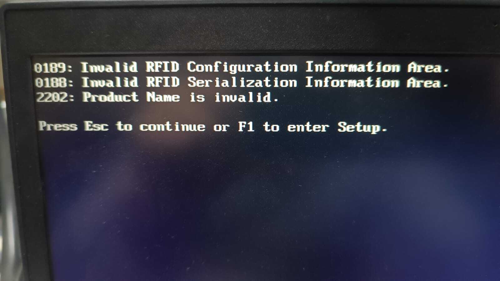

            Message: 0188: Invalid RFID Serialization Information Area. Solution: The EEPROM checksum is not correct (block # 0 and 1).
            The system board should be replaced ​​ ​

          if this prob is asset tag can this do the work ??
          • Maxpower3
            Maxpower3 commented
            Editing a comment
            I don't think so, it's not necessary.
            the problem is in UUID and Mac address

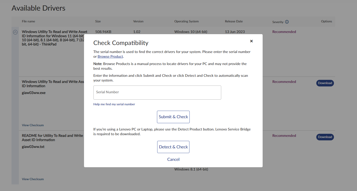

            you can dump eeprom with lenovo utility and post me the blocks in pictures

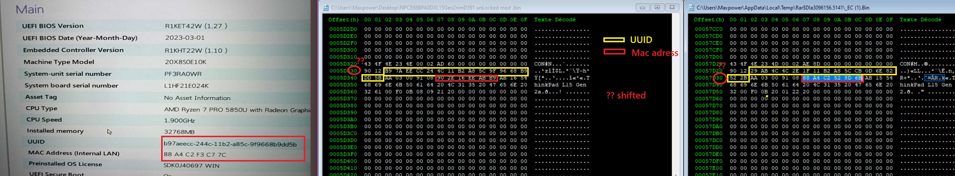

          one of the dumps is shifted, I need to read block 3,
          I'm going to give your information, I kept that of the donor​

            here is a block after password (block6/7), I don't know this function 0x5C600 and 0x5D600.
            Click image for larger version  Name:	lenovo-tp-yoga-x390-8365u-1624872577.jpg Views:	0 Size:	289.5 KB ID:	3166632
            I made a file with your mac address and changed UUID.
            you can try, I don't really believe it
            please before writing, look at the thread and post identical photos with yours

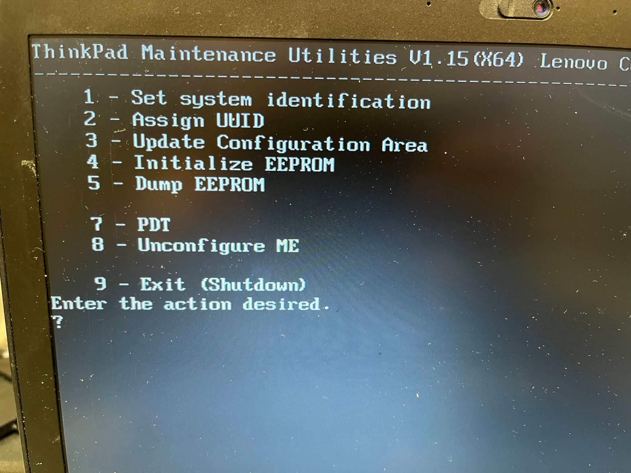

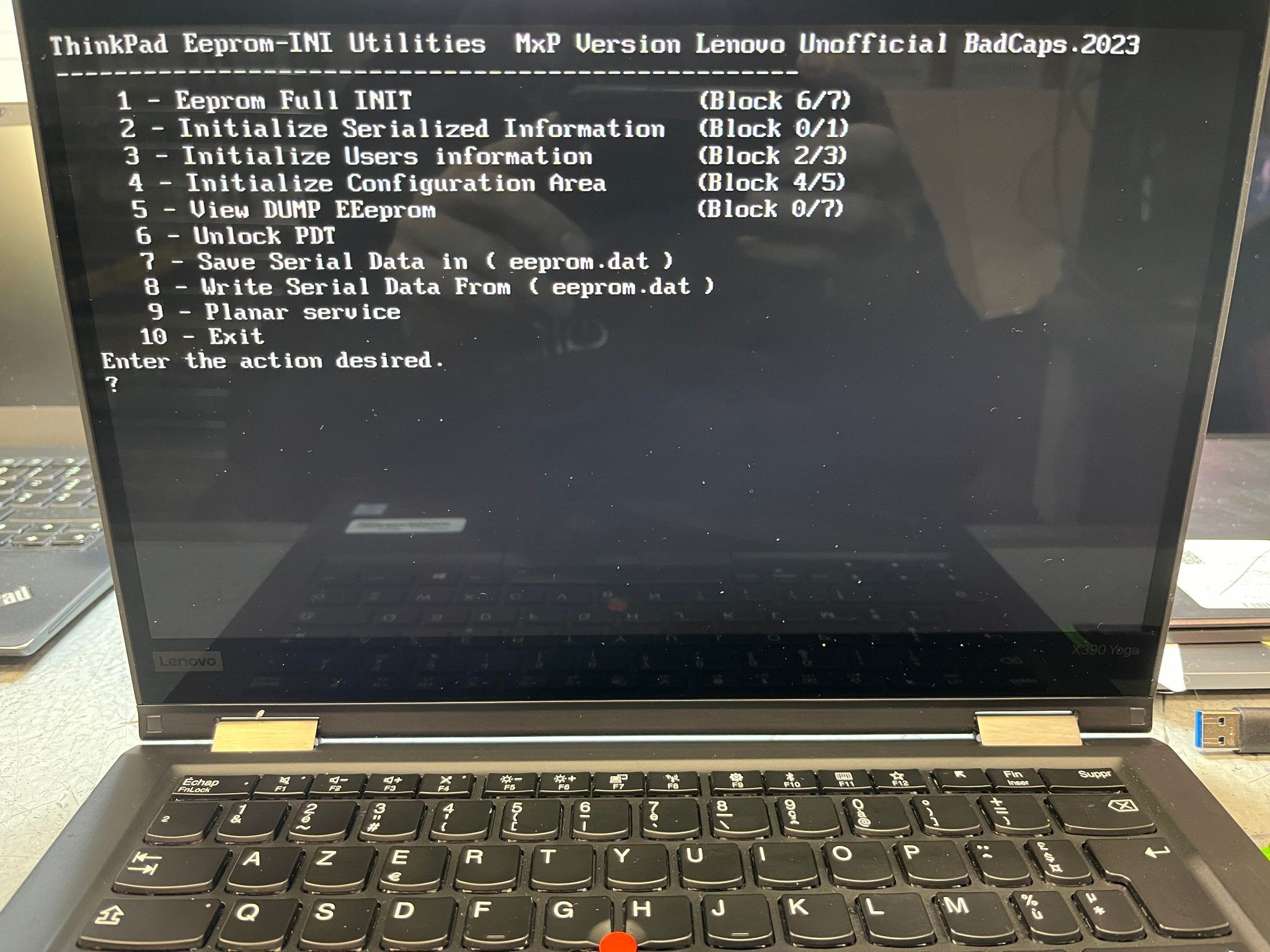

            or try initialise eeprom with utility (4) and rewrite your serial and others informations

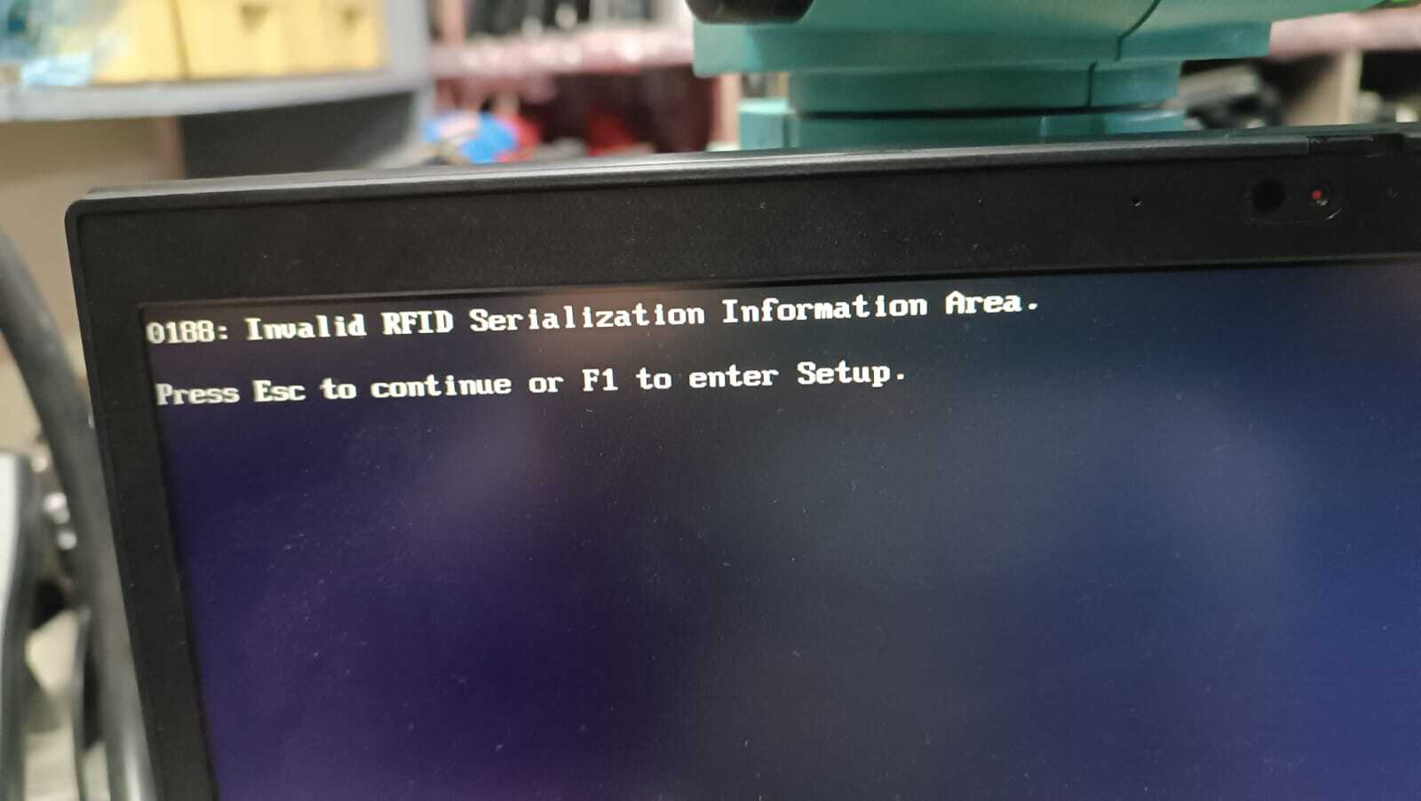

                if 2 times RFID + product name, we are in the right place

              it is not asset tag , im thinking to just let it like that
              • Maxpower3
                Maxpower3 commented
                Editing a comment
                put back the one from before and do an initialization with utility to rewrite the checksum
            • Maxpower3
              Bad Veteran
              • Feb 2018
              • 1254
              • France
              Initialise configuration aéra
              should be enough to clean block with uuid and mac address and product name

                ini untility i never used is this a programe software

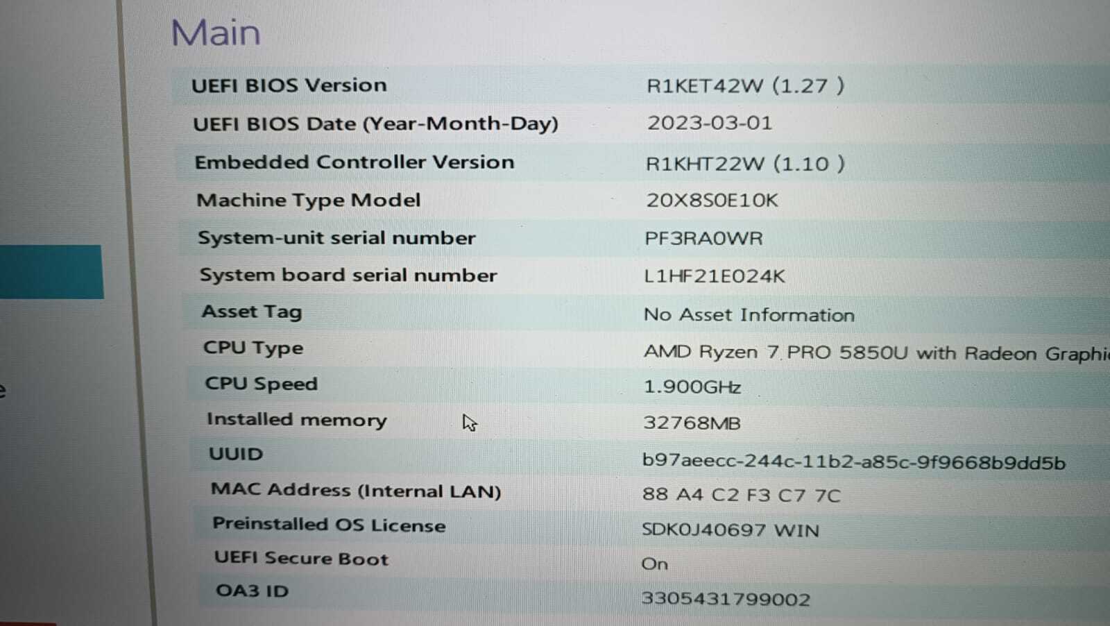

                Thanks Maxpower3, those were it. Bios unlocked! For everyone else..
                DMI information and password writes 2 times on file
                Dmi start from 0x5C120 and 0x5D120
                Password 0x5C420 to 0x5C56F and 0x5D420 to 0x5D56F​
