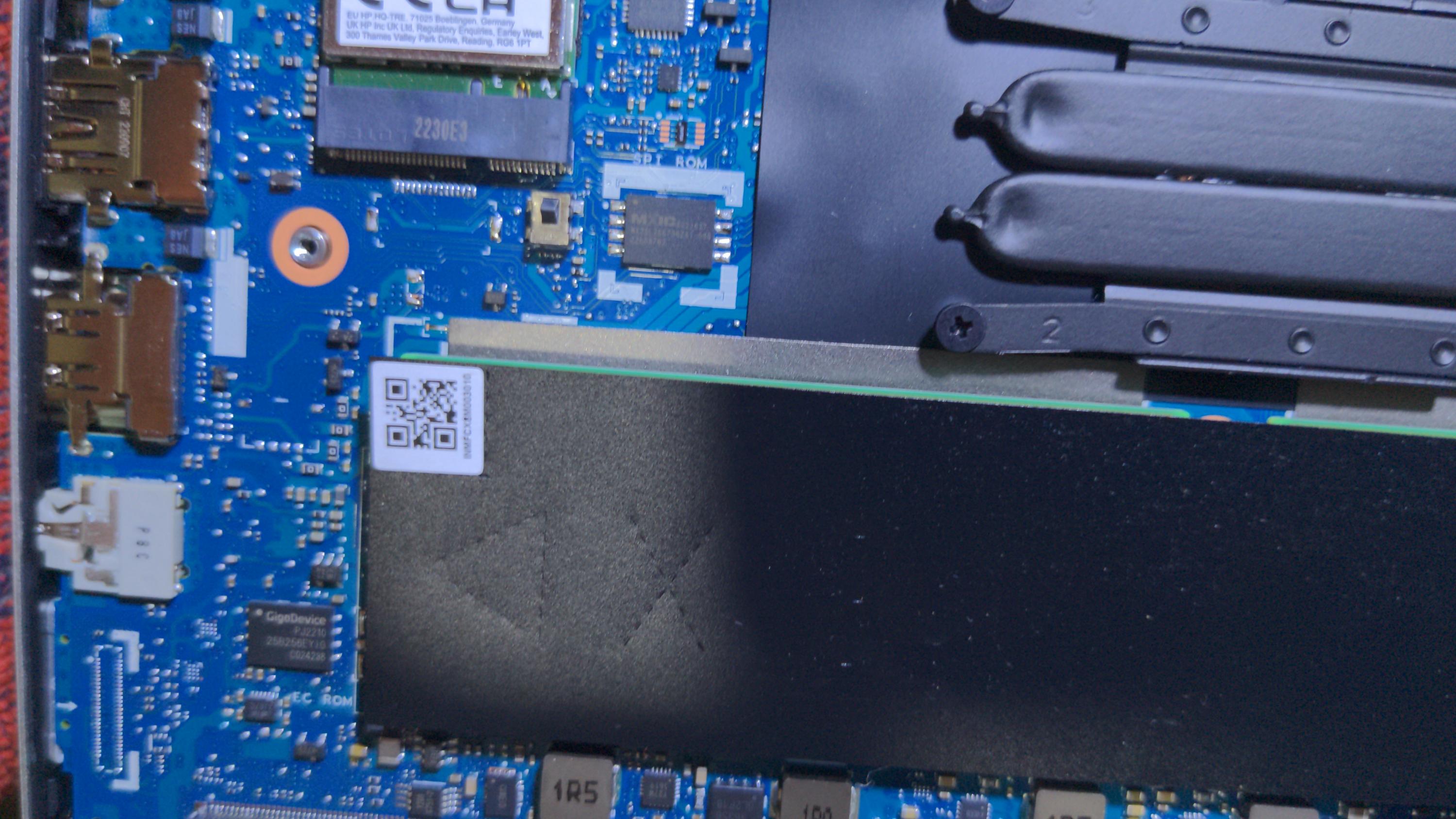

    Good morning
    i have my hp which has a bios password and i would like you to help me to remove it
    HP elitebook 655 g9
    daox9smb8d1 rev
    sn#5cd2399t8c

    Upload your dump.

      Re: HP elitebook 655 g9
      the card with two bios of 256mb (mxic and gigadivice)
      I don't know the chip that holds the password

        Dump both.
          Dump
