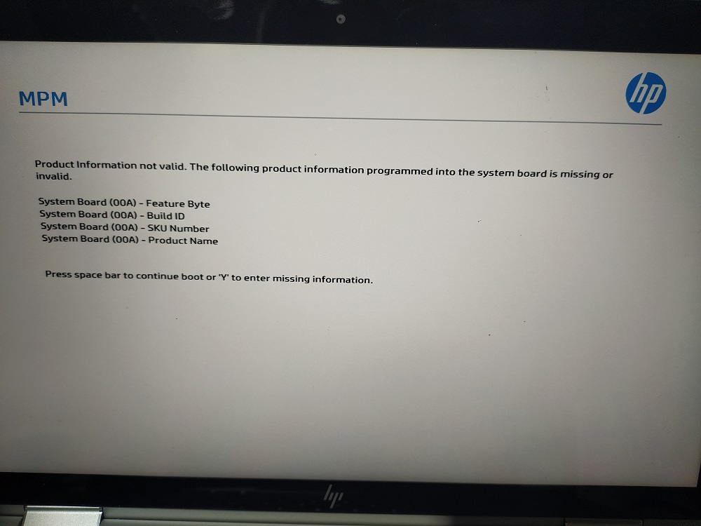

    I have replaced the motherboard on this laptop but its in manufacturer mode and needs all the codes.
    I saved the serial number but it needs more and if i don't save them, touchscreen doesn't work.
    I think Feature Byte is a universal code the same for all Elitebooks x360 1030 G4 and maybe the other codes needed are also universal.
    I needed the same for an AiO 400 G2 and found them through partsurfer.hp.com using the serial number but for this it doesn't work!
    Can anyone help?

    Look at the factory label, they should be printed there, or post a picture here to help you find them.
    Upload the old and the new dump as well.

      Thank you for the replies.
      Turns out these codes ARE universal.
      I did an image search, found them on Google and they worked!
