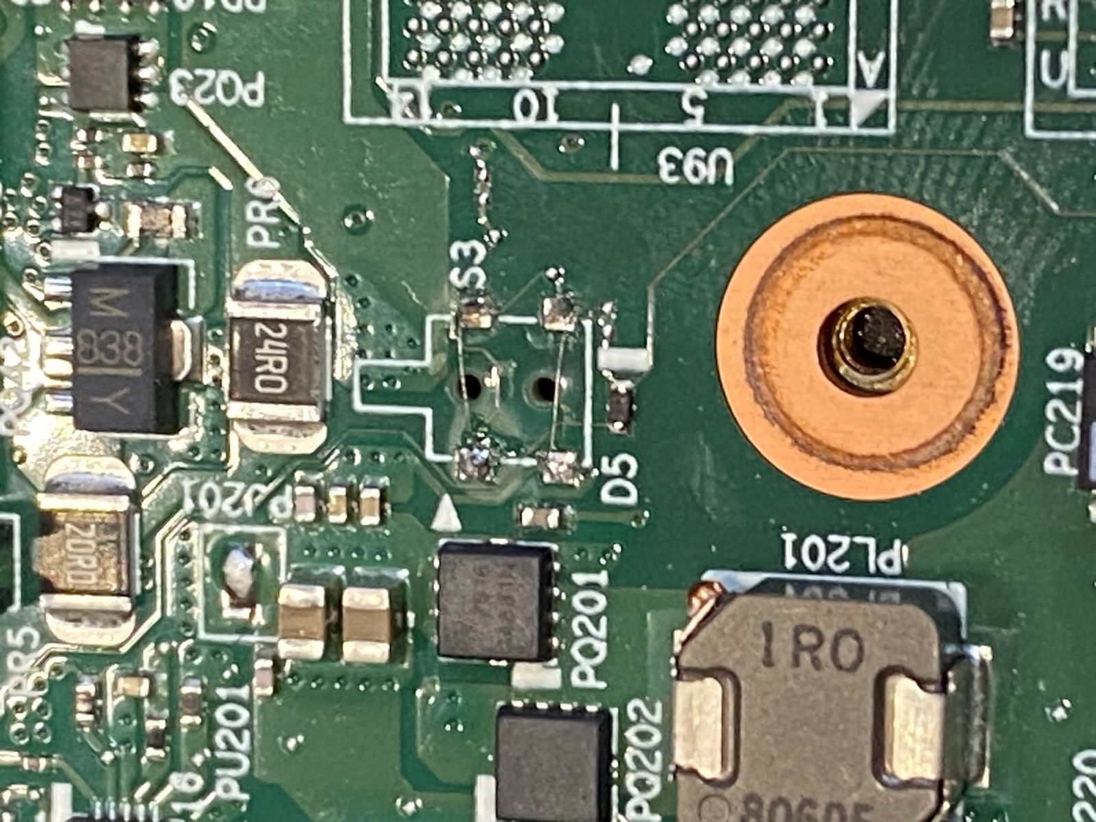

    Hello friends, could someone help, I have this thinkpad with that message when starting, I already disabled it from the bios but the message continues, I also cleaned the region for me but the problem is not fixed, I also measured the switch cover but it is working... does anyone have Any idea what it could be? I attached my dump in case anyone can help.

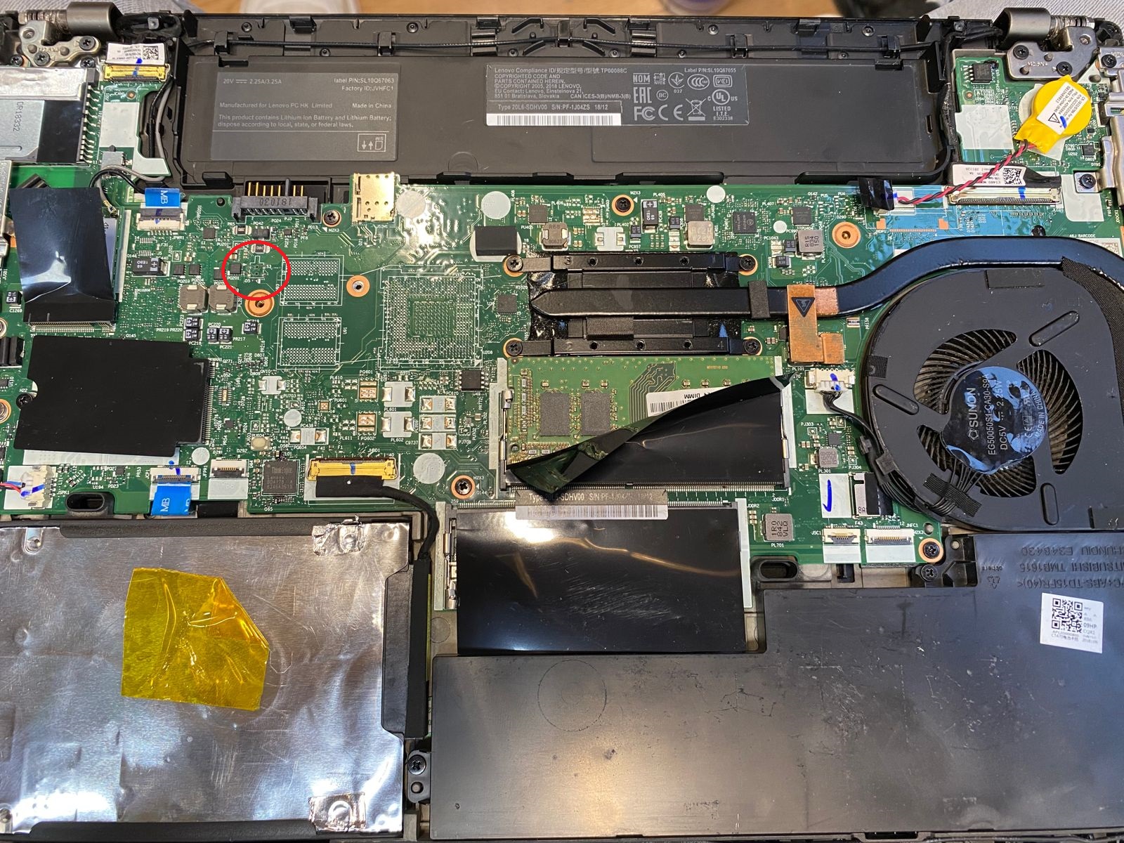

        Yes, of course, the problem was on the motherboard, it didn't have the cover switch, someone detached it, I made a bridge and it was perfect.

                            • fredyjbi
                              please help friends thinkpad T470 error post "bottom cover tamper detection error"
                              by fredyjbi
                              please help friends thinkpad T470 board CT470 series NM-A931 error post "bottom cover tamper detection error"
                              I've already
                              flashed the bios clean me and updated from the Lenovo site, then removed the switch and immediately jumped the S3 from pins 1 to 4, 2 to 3 but the problem remained the same, thank you
