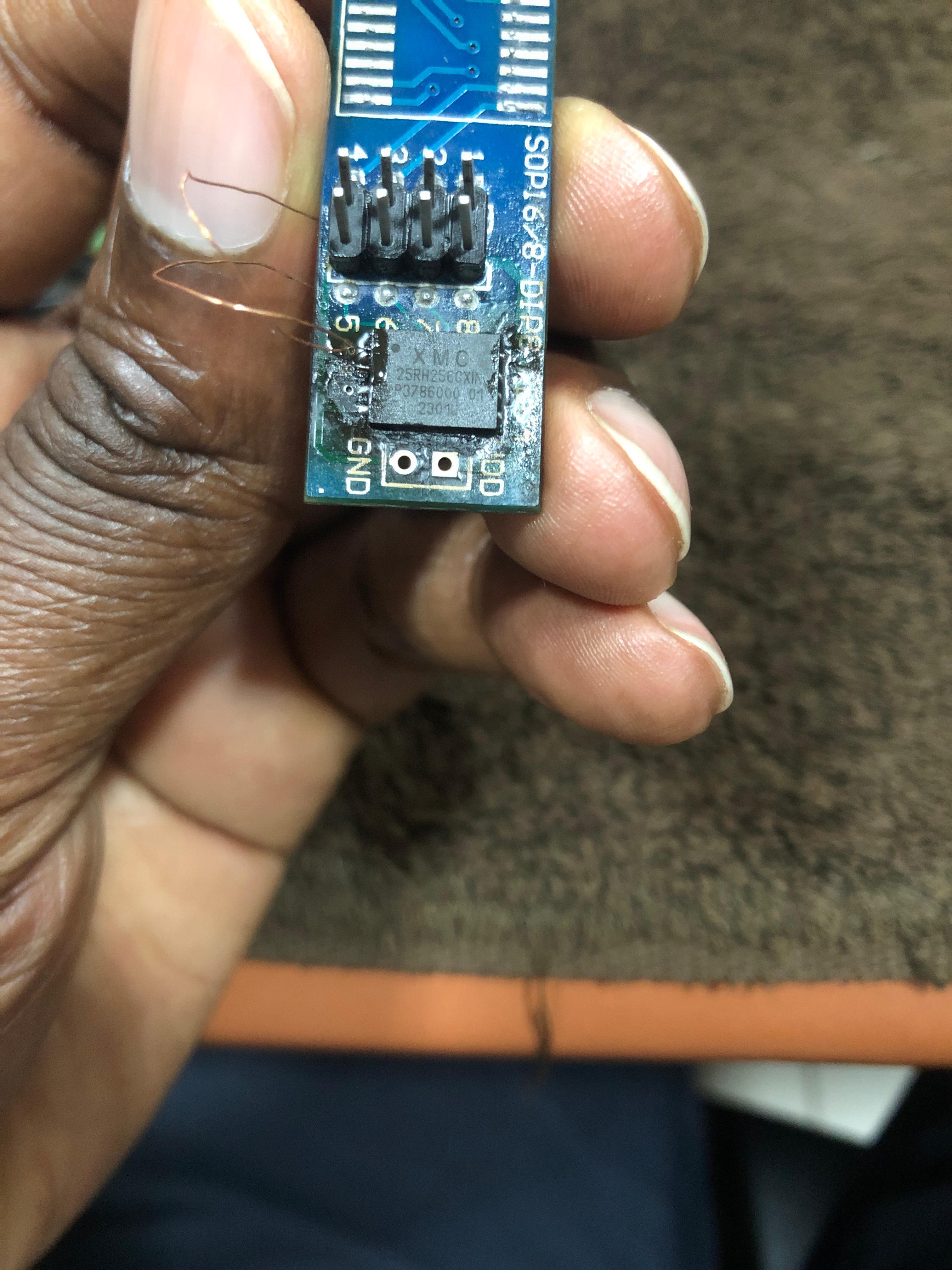

                            Precision 7560
                            Service Tag: 2N4MMN3
                            Express Service Code: 5752060959
                            if you try to detect chip (unknown device ! is correct IC position?)
                            trying to read it direct it says
                            APP Version : 12.67 Model : TL866II Plus
                            Device : CF25Q128AS @SOIC8
                            Pins Detected Passed!
                            Check ID Error!
                            Checked ID is:0x 20 43 19
                            Wish to continue programming , please cancel [Check device ID] option!

                              What part number is on the bios chip
                              • Ismail Siraje Ittembe
                                Kampala Member
                                • Jan 2024
                                • 25
                                • Uganda
                                #115
                                xmc
                                25rh256cx1m
                                p3786000 01
                                2301u
                                  • 21841

                                  That doesn`t look like a WSON adapter, the gnd pad might be in contact with the other pins https://www.badcaps.net/forum/troubl...62#post3337062

                                    its the one though dirty but has been working fine

                                      Check it with a multimeter

                                        Precision 7560
                                        need bios for The chip seems to be shorting
                                        Got another new chip to use
