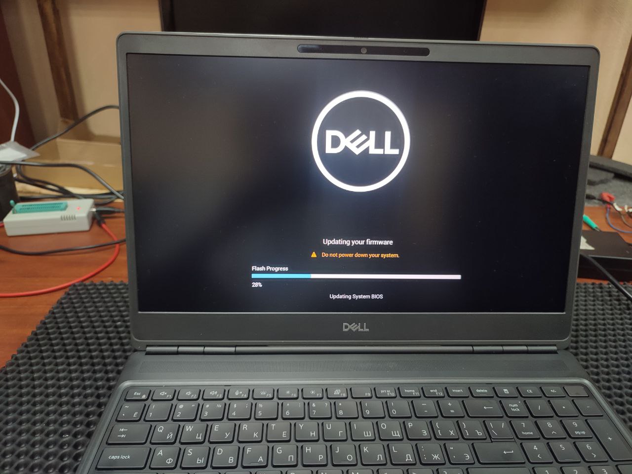

          #44
          Re: Dell precision 7560 bios and ec dump needed
          Hello! The Bios update occurred with an error, 3.6 is flashing. Help with the firmware. ST:GKC16J3

            #45
            Precision 7560
            Service Tag: GKC16J3

              #46
              Originally posted by hoaca388
              Precision 7560
              The first launch lit up the keyboard backlight and reboot, black screen and no initialization.

                      #50
                      This bios does not always load, it gives an error 3.6, and if it starts, it asks for an Administrator password that I do not know.
                      Is this 8FC8 pw ?

                          #52
                          Yes, that's right
                          https://www.badcaps.net/forum/showthread.php?t=125468

                            #53
                            Thanks for the link! In the damaged Bios, the ME region + System Bios was replaced, initialization occurred but with errors. After Password Patcher, the ability of the loader was restored to the last update.
