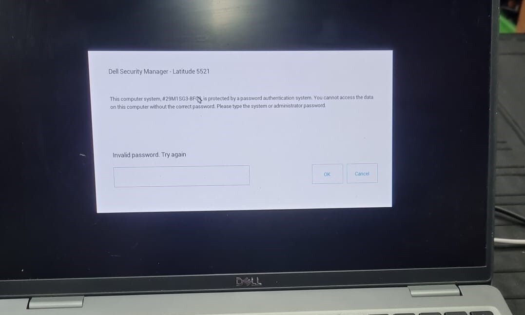

      Checked everything again,wrote each bin again and :
      - original bios everything works fine, just has bios password so board is fine. Click image for larger version
      - Bios from minhdigital stays on ~10 sec , then boot loop 1 sec on 1 sec off .
      - Bios from rex98 nothing happens, when i press power button i get amber light as long as the hold the button pressed. Charger does not switch from to 5 to 20.

        #43
        write again bios file provided by rex98, check soldering, at 1st start wait for 2 minutes, it will restart several times with no image.
          Replaced flash memory today, tried again, and :
          - Bios from rex98 starts , no image , and led flashes 3 amber 6 white.
          - Bios from minhdigital starts,after 2min display starts and dell logo appears for half a second, then system restarts continiously without an ending. (flashed it few times same result)

              #46
              Don't think it's hardware issue, works fine with original dump, but has password.

                    Originally posted by Markus1741
                    Try this file ...
                    Thank you, starts with backlight but no image, also 3 amber 6 white.
                    Originally posted by minhdigital
                    Send to you, try again
                    Thank you, starts, display logo, logo stays on, but nothing moves and 3 amber 6 white.

                        #51
                        Hello, wrote it today, same behavior .
                        Starts , display dell logo, fan blows full speed and blinks 3 amber 6 white.
