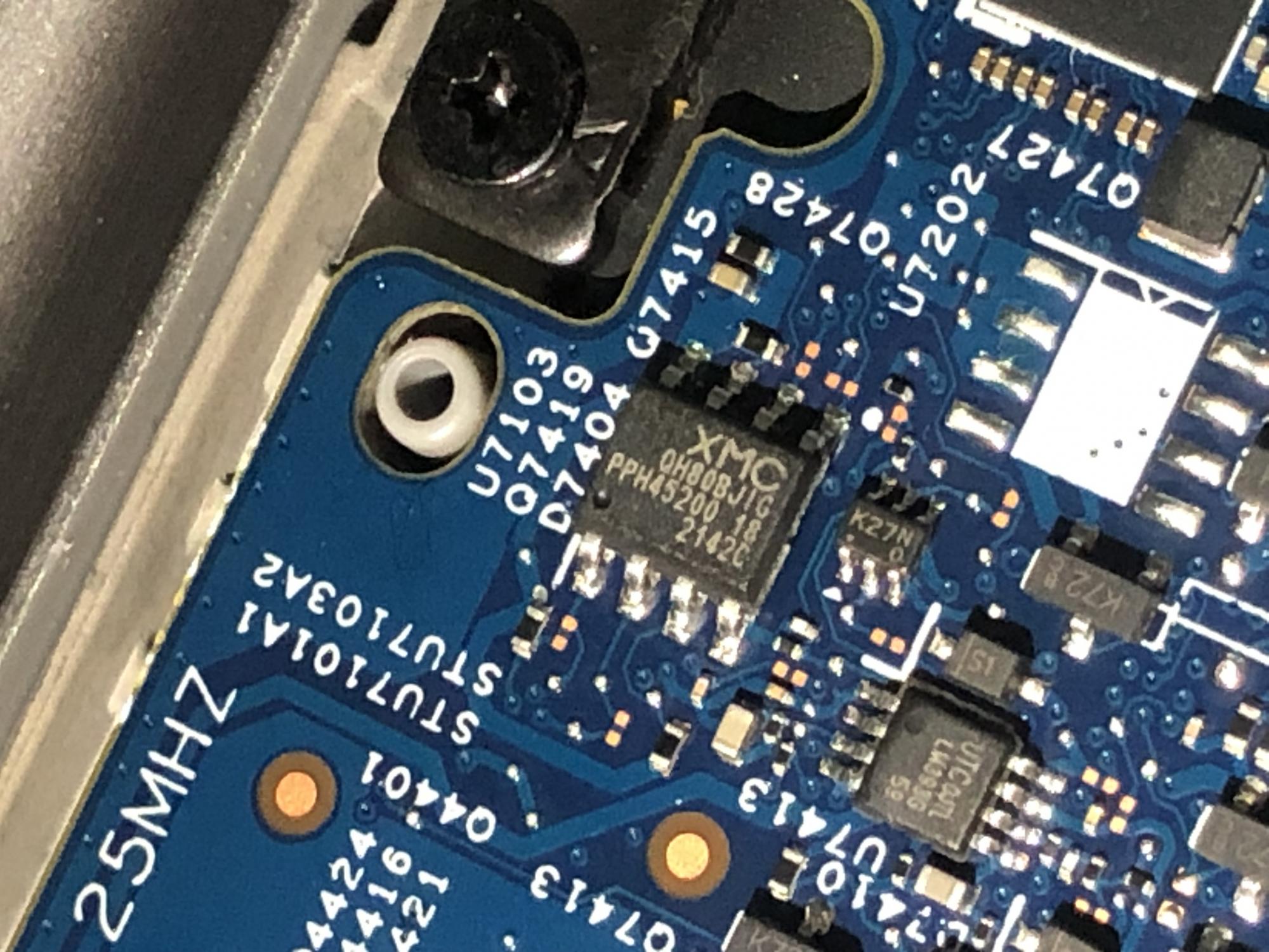

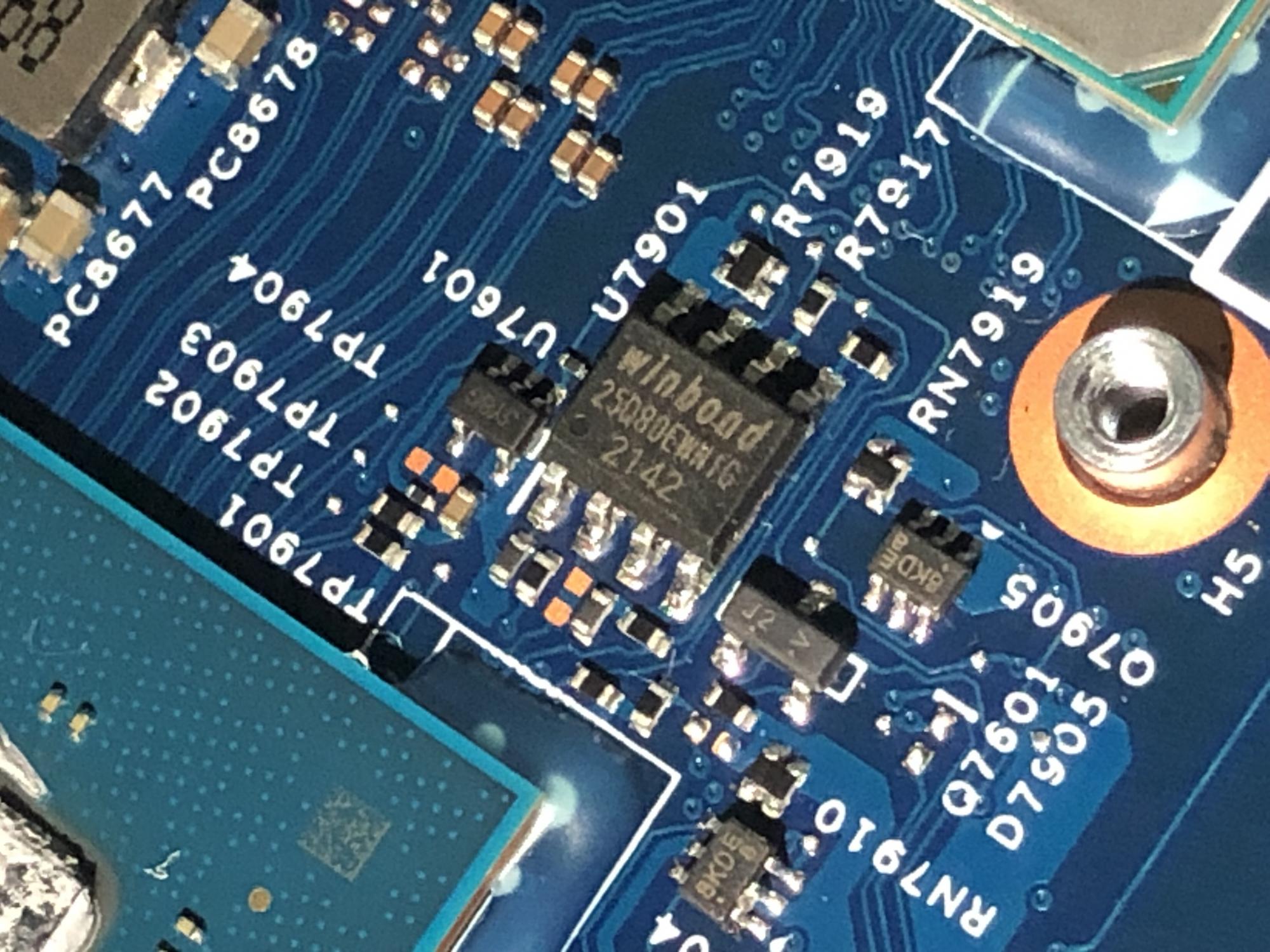

          • dadayal82
            • Oct 2023
            • 7
            Re: Dell Latitude 5521 - broadmoor 15 TGL-H BIOS file
            Originally posted by qayyum786
            send bios chip image
            Attached
            • hoaca388
              Badcaps
              • Jan 2022
              • 12437

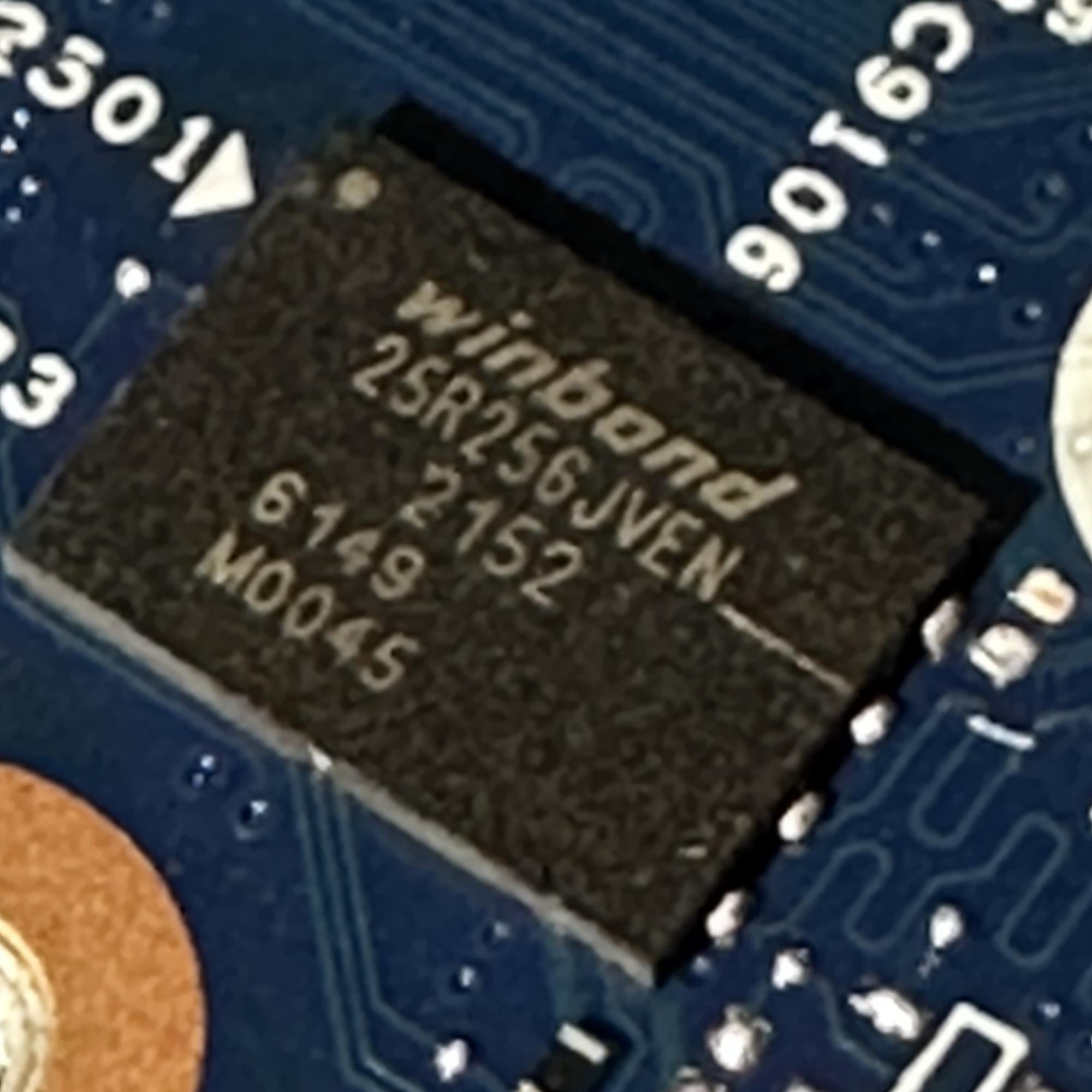

              Originally posted by dadayal82
              Attached
              You must choose chips with code for example 25Q256...

              • dadayal82
                • Oct 2023
                • 7
                Yes just found one more winbond chip on other side of motherboard. But it is really closely soldered with board and hard to read with sop8 test cable.

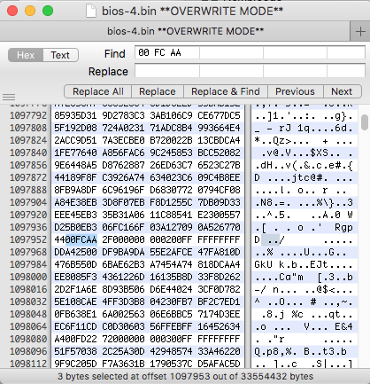

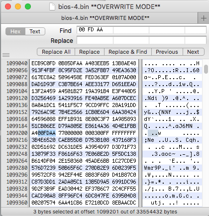

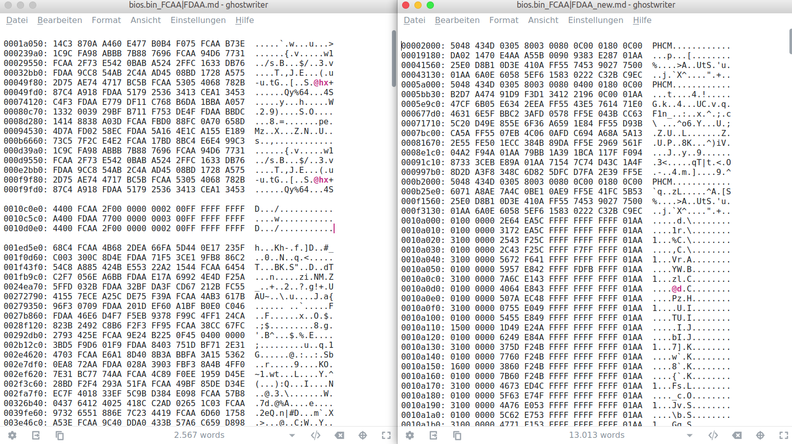

                        Hello try this file i hope it helps ....
                        I wrote a Linux shell script and use egrep to search for FCAA and FDAA in the locked file.
                        The whole thing is written into a Markdown file to compare where FCAA and FDAA appear, then use the wonderful program HxD Editor to change the values from AA to 00.
                        That should be it, I'm not a professional and I can make mistakes.
                        You can compare the result in the picture.

                          still don't get it after 6 months, huh? strings you have to search for are xx00FCAA and xx00FDAA. And why write "Linux shell script and use egrep to search for FCAA and FDAA" when HxD has the function to search for hex or text? Just to show off or your capacity to think is reduced?
                            • 22264
                            #34
                            He`s smarter than me,i can`t code at all.I looked at one of Markuses shell scripts and it just looks like this to me
