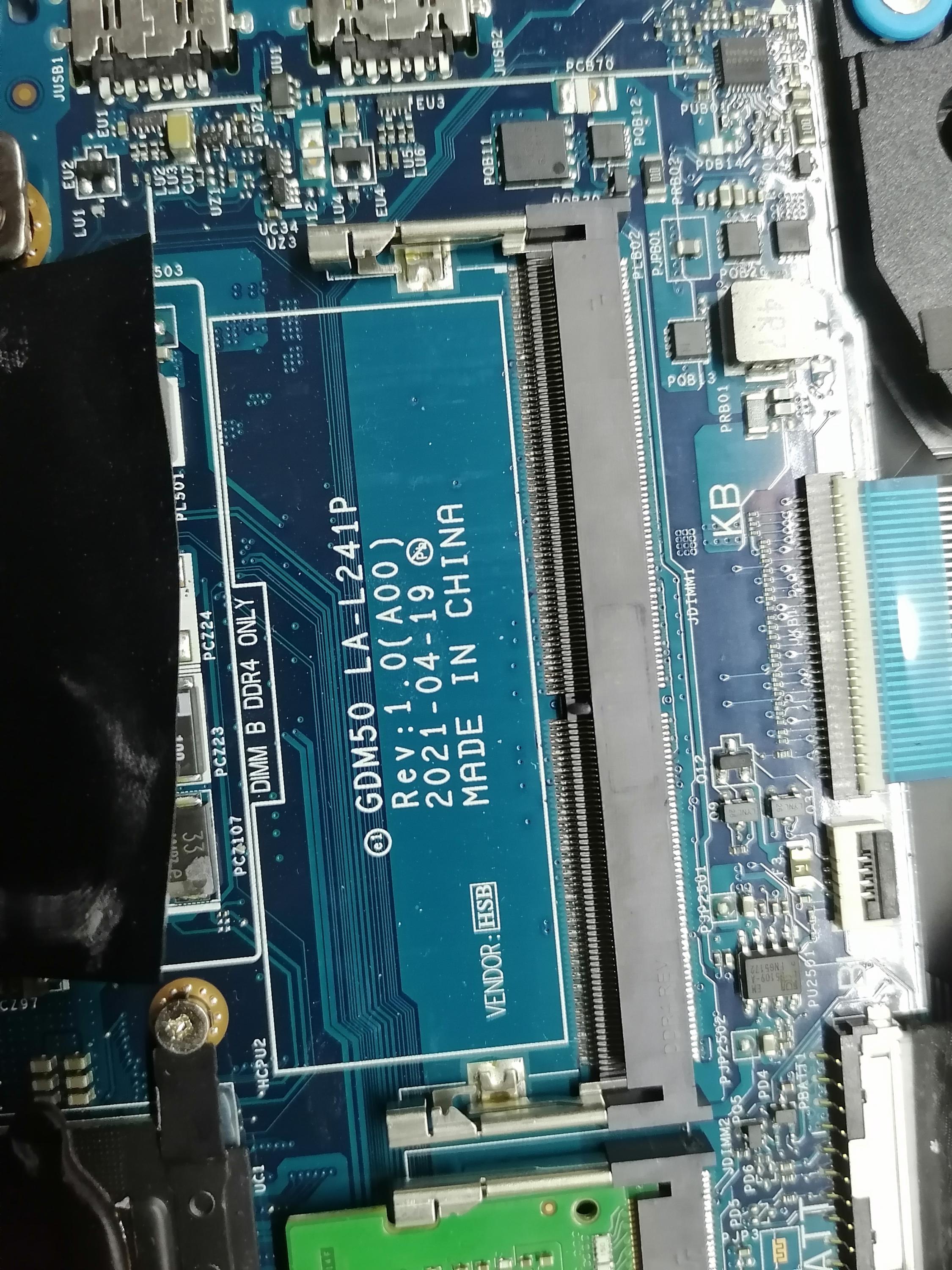

                Dell Inspiron 15-3511 i3 bios please
                can someone help me on my Dell Inspiron 15-3511 GDM50 LA-L241P REV 1.0 (a00) it doesn't boot up no fan spin, 3.3v and 5v are present when i press the power button the cpu heats up.
                processor is i3
                i attached my bios main and EC i hope someone would help me fix my bios dump.

                  Re: Dell Inspiron 15-3511 i3 bios please
                  processor is i3

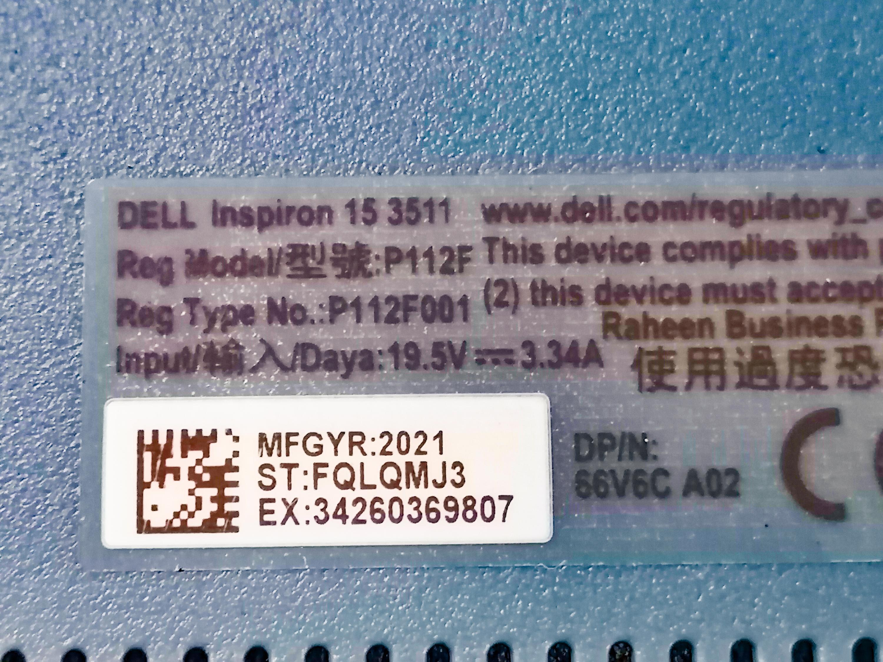

                  Write your Device Service Tag.
                    HERE IT IS thank you. FQLQMJ3
                    • hardware1
                      • Sep 2021
                      • 2939
                      • N/A
                      Here's your New BIOS file, try it and let me know.
                      all donations are welcome,
                        here's your new bios file, try it and let me know.
                        thank you but it still doesnt work, i checked the isl95522 pmic it only gives 9v i would try replacing it.
