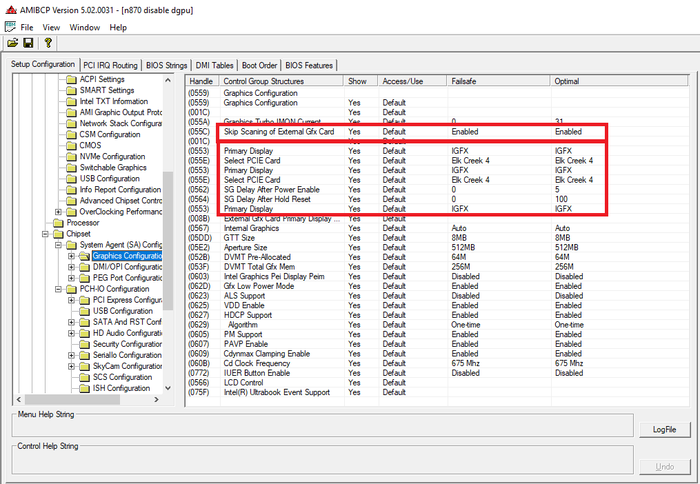

                                This is what i did to many N850 device and it worked. Maybe you have some other problems as well?

                                  With the dedicated graphics disabled in the system, the laptop worked fine. So I removed the coils initially, but the fans were running at max. I went ahead and desoldered the gpu bios and gpu chip.
                                  The problem is still the same fans work at maximum power after a while, and the laptop starts to beep.

                                    Yea like i said. I used this bios editing method showed in the previous picture on many n850's never had any problem converting uma.

                                      Try this one
                                      Also made a clearme. You can try that one too.
