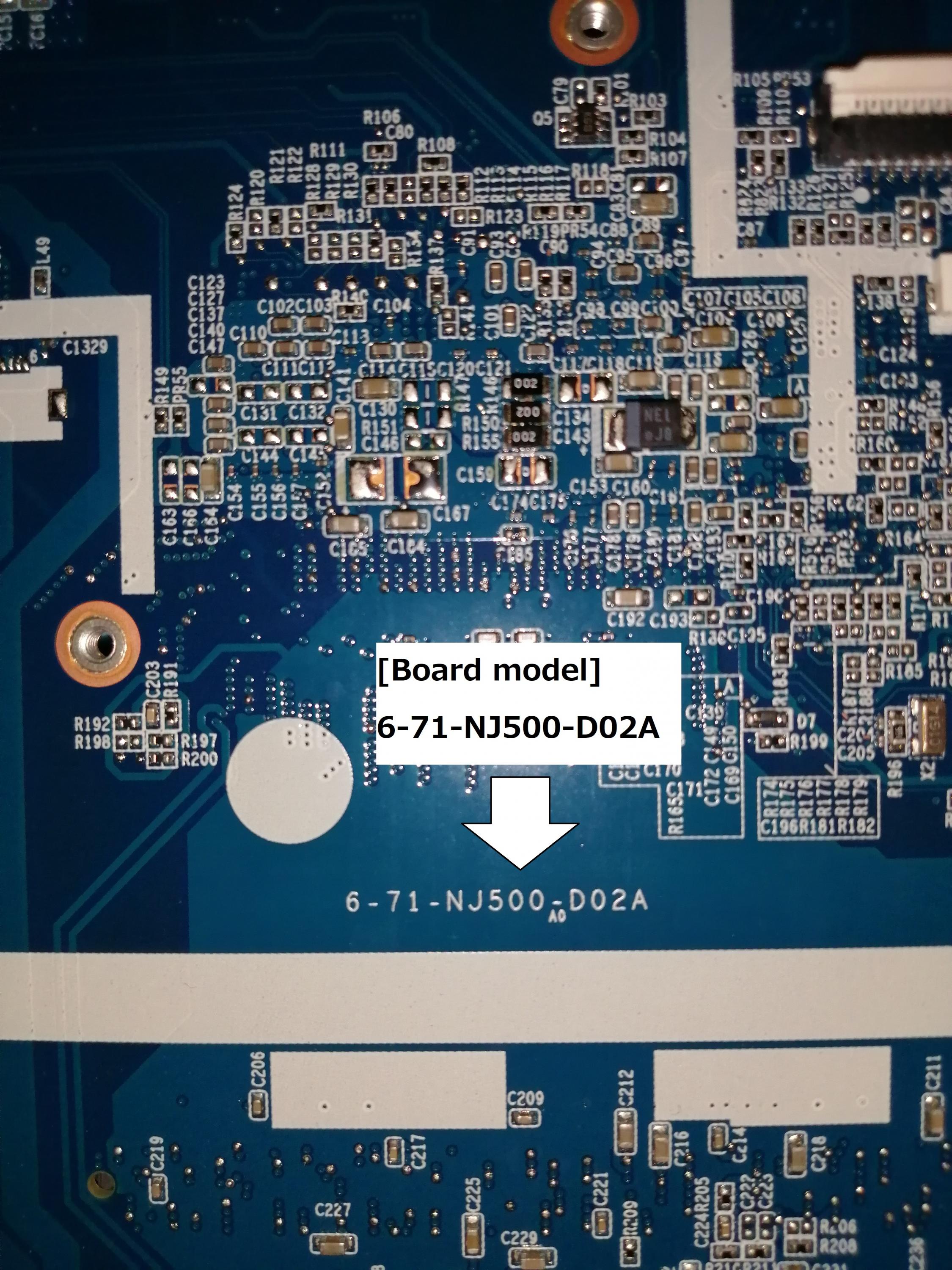

    Hello.

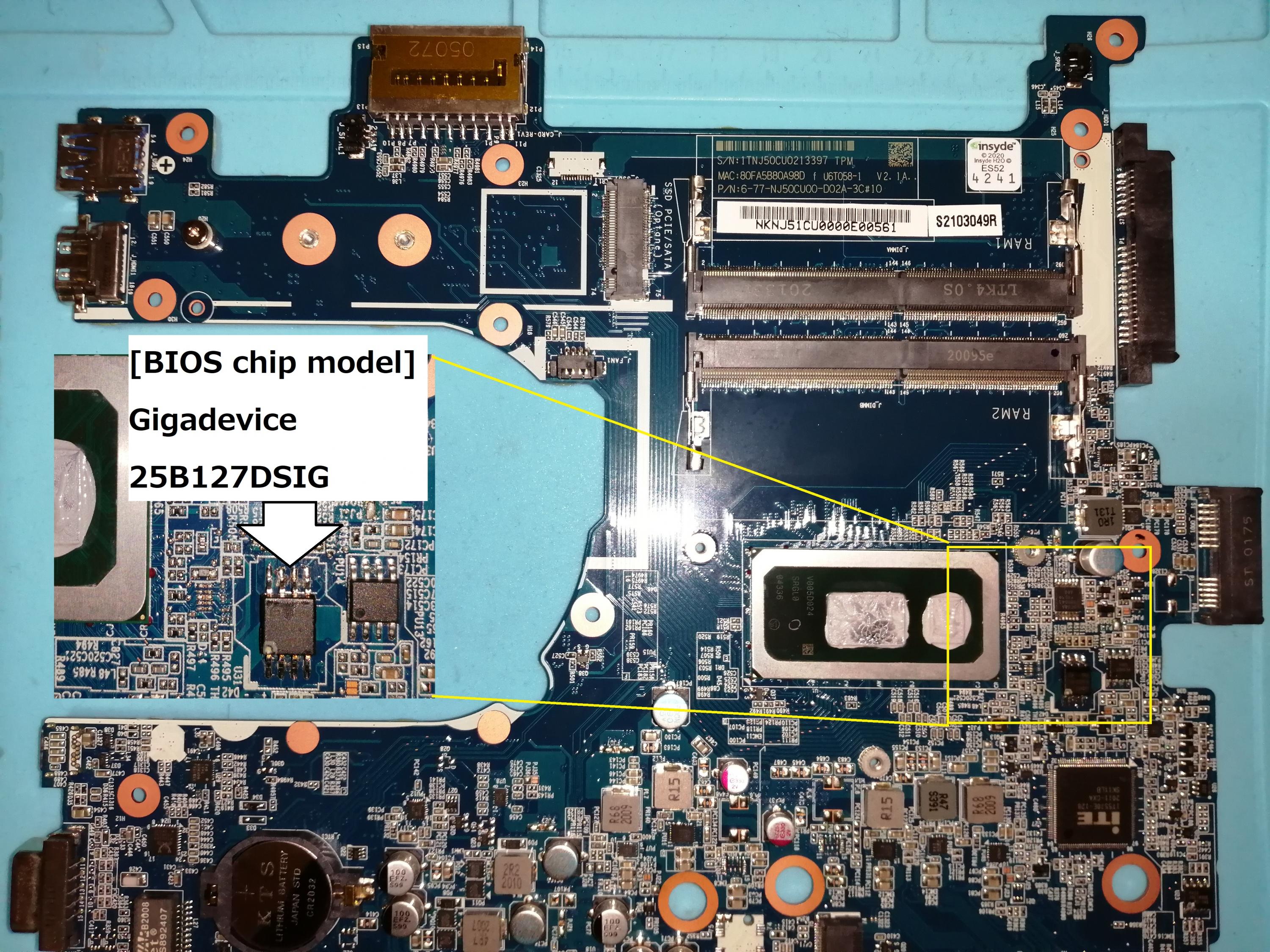

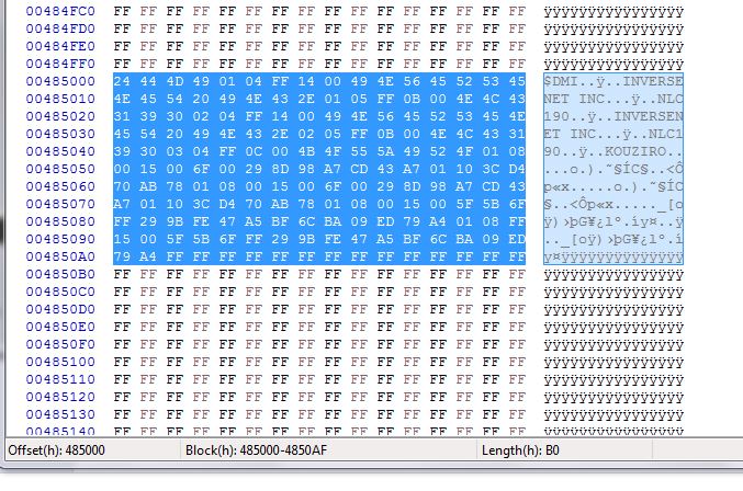

    I need a working BIOS for a bricked 10th Gen laptop.
    M/B model: 6-71-NJ500-D02A
    BIOS chip model: GD25B127DSIG
    Pictures and dump data from possibly corrupted BIOS is also attached below.
    Thank you in advance.

    Re: BIOS Request for Frontier NL Series (Core i3 10110U)
    Clevo NJ50CU rebadge.
      Thanks to your BIOS data, my bricked laptop has come back to life after reflashing BIOS.
      Without your help I couldn't have got to know that this was a rebadged model for Clevo NJ50CU.
      I'm pretty new in BIOS repair, but you've motivated me to learn more.
      SMDFlea, You made my day!
