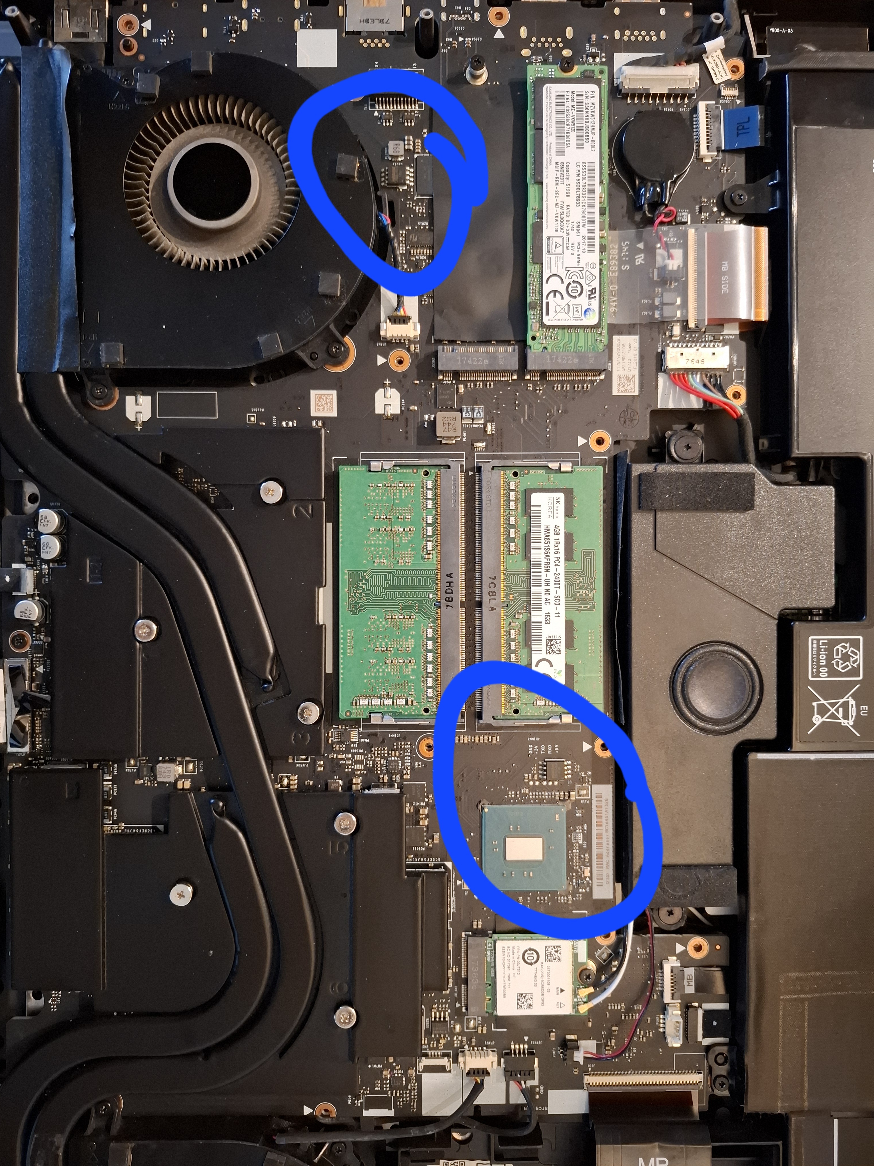

            Hi guys,
            I'm stuck with a bad bios on my legion Y920, it don't boot and it give me no acces to bios or something else.
            Fan turn on, screen turn from black to dark grey, and nothing more...
            Even after test all component or auxilliary display.
            It worked slightly well and all begin after a bios reset (removed power+battery+CMOS battery)
            I think bios program is damage, and i would try to reflash it with my eeprom programmer :
            Could i try to flash a standard Lenovo website bios ?
            Or do i need to flash m'y laptop with some of your cooked bios with my s/n number ?
            Thanks a lot for all help given
            Regards
            Lulu

              I would back up my bios but i found 2 chips on the MB wich one is the good one ? have an idea ?

                Here are serial : PF136LK6
                Don't post pictures unless asked....in the picture above do you see what is written on the chips??
                post them both..post S/N, full name and model, motherboard model, TYPE,etc.​
                • Lulufx
                  • Mar 2021
                  • 10
                  • France
                  Here is informations request :
                  Laptop :
                  Lenovo legion Gaming Y920-17iKB
                  S/N : PF136LK6
                  Model : 80YW
                  MO : PF9XB8205256
                  MTM: 80YW000RMX
                  Factory ID : JVHFC1
                  CHIP 1 :
                  (Next to SSD port)
                  Winbond 25Q80JVSIQ (1750)
                  CHIP 2 :
                  (Next to southbridge)
                  Winbond 25Q128JVSQ (1740)
                  Motherboard :
                  Lenovo Gaming Y
                  DY730 NM-B311 Rev1.0
                  (HSB J MV-6 94 V-0 E89382)
                  1178192900028
                  45115R12108
                  DY730 10B2
                  1F_2018-01-23​

                    post the contents of both bios chips..

                  Ok, i will dump both chips within 24H and post 2 files,Thanks for your help guys 😊

                    Hi guys,
                    here is my chip 1 and chip 2 dump.
                    I do it 2 times with 2 software/hardware : CH341 et EZProg
                    here is the two CH341 dumps (for chip 1 and chip 2)
                    • Lulufx
                      • Mar 2021
                      • 10
                      • France
                      Just in case those above doesn't work
                      second two dumps with EZProg, chip 1 and chip 2 :
                      • Lulufx
                        • Mar 2021
                        • 10
                        • France
                        Thanks for your time...
                        • Lulufx
                          • Mar 2021
                          • 10
                          • France
                          I've just dump the bth chips with a third software, NéoProg and control the crc, this time chksm is ok for both dump !
                          Please use these files if encounter chksm or crc error, i'm pretty sure they are both good.
