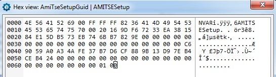

    I have a problem with my BIOS password on MSI GT73EVR Laptop (2017)
    I forgot the password because I set it 3 years ago.
    Probably the pass is an easy example, but I don't remember. passwords that I try:
    B10s-p4ss
    H3ll0-W0rld
    B10s-Ms1
    gt73-t1t4n
    etc...
    I tried this:
    I opened the laptop and removed cmos battery, but password is persistent.
    Then i used the CH341A programmer to extract the BIOS to find the key with UEFITool. (attached .bin in txt)
    Here the hex code:
    20 16 9D F6 72 33 EA 38 15 84 E1 5D B5 73 EB 74
    6B B7 82 9E 00 00 00 00 00 00 00 00 00 00 00 00
    00 00 00 00 00 00 00 00 C6 90 59 A0 A3 4A FE 37
    B7 D6 CF 88 9B 13 D9 7E B4 CE B4 24 00 00 00 00
    00 00 00 00 00 00 00 00 00 00 00 00 00 00 00 00
    01 00

        Your password uses an unknown hash, it is not possible to compute it with the standard AMI_key = int("0x935b", 16)

                Maybe it's a SHA-1 hash, 160-bit (20-hex bytes).

                  No Problem.
                  Here's your Unlocked file, try it.
                  The file worked, thank you very much
                  so the solution was to write zeros to the hash on both nvrams.
                  not erase, just fill...
                  That's why I had a checksum error
                  now everything is solved!!
